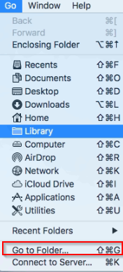

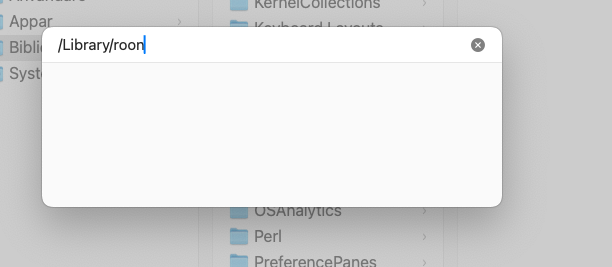

Hi @peter2,
That’s very strange if Roon is running on that Mac there has to be a RoonServer folder. Let’s try navigating to the folder directly in case they’re hidden.
  1. Open Finder and click Go in the top bar
  2. Click “Go to folder…”
  3. In the text box that opens type ~/Library/RoonServer then enter
Does that bring you to the RoonServer folder?

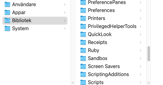

Hello.
No, unfortunately the folder does not exist.
The operating system is in Swedish, hence “Bibliotek” which is library in Swedish.
Skärmavbild 2025-04-16 kl. 11.42.33
Skärmavbild 2025-04-16 kl. 11.46.23

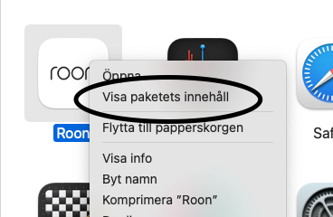

This is the only way to see any files belonging to roon as far as I can see.
Skärmavbild 2025-04-16 kl. 11.51.03

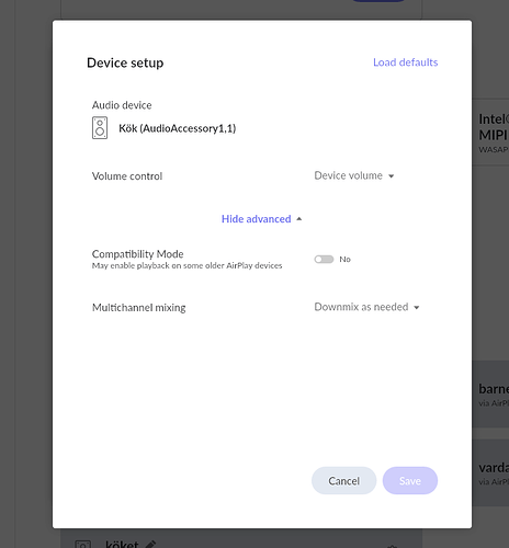

Taking a few steps back, you mentioned you’ve reviewed the device settings already, but I’m curious to know if you have Exclusive mode enabled for your Homepod?
The Exclusive Mode setting tells Roon to take exclusive control of your audio device.
During this time, it can’t be shared with other applications. This allows Roon to precisely control every aspect of the playback without any interference from the operating system.
If this setting is enabled, what happens if you disable it? Are you able to edit volume levels in this case?
Hello.
I don’t have that option to choose on any of my devices.
Thanks for the screenshot - and have you also tested toggling the compatibility mode option on to see if the same issue persists?
We were able to pinpoint the timestamp you provided above, and see the volume commands attempted. Unfortunately, we’re not seeing any errors around this, it looks like the commands were sent and recieved properly.
If you click the ‘Go’ dropdown, and hold the alt/option key - do you see the Library/Bibliotek option pop up?

Very good bitch (alt/option key), I feel like a real noob on mac osx.

I have tried switching compatibility mode without success.
