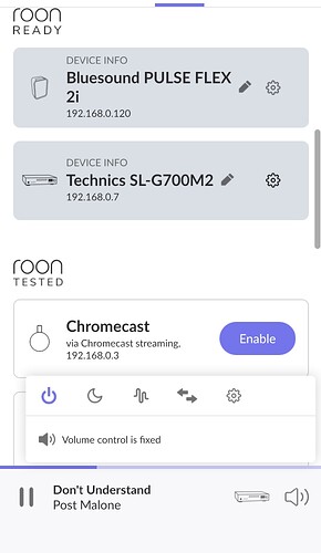

I am very happy that my Technics SL-G700M2 is now Roon ready. But now I have another issue. I cannot change the volume in the Roon app, because the “Volume control is fixed”.

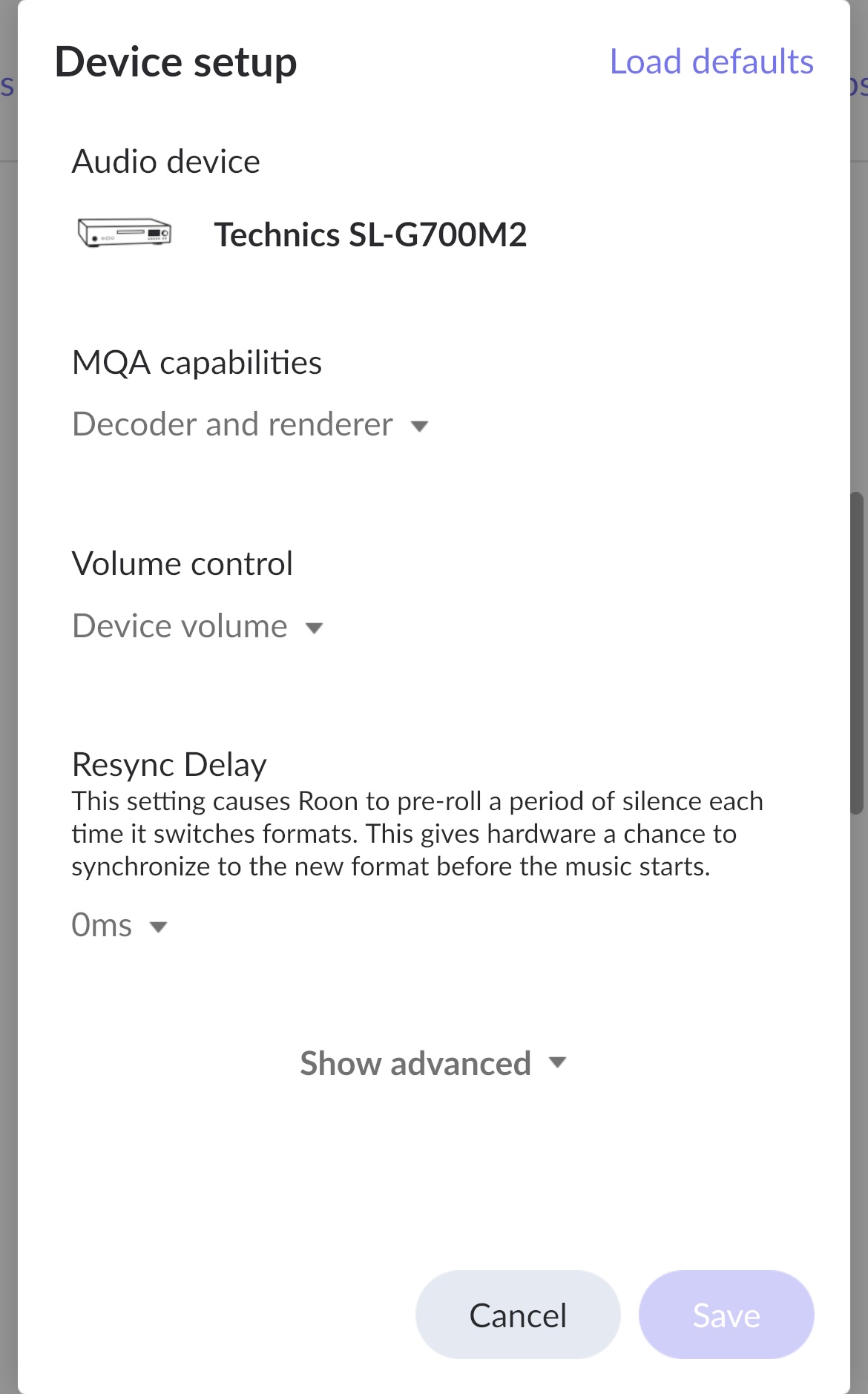

In the “Device setup” the “Volume control” is set to “Device volume” and NOT to “Fixed volume”.
When I change the Zone to Technics SL-G700M2 Chromecast, I CAN change the volume.
So this fixed volume issue only occurs in the “Roon ready” modus.

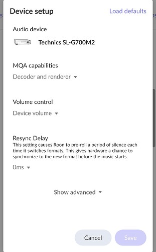

Under “Device Setup” of the SL-G700M2 I don’t see the possibility to change to “DSP Volume”:
(see screenshot)

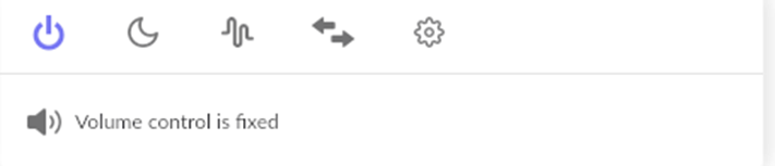

I have rebooted Roon, but the volume control is still fixed (see screenshot). I still have to use my remote to change the volume of my SL-G700M2.

The volume display of the Technics SL-G700M2 is different from the other zones, because the on/off button is visible.
Printscreen Technics volume display:

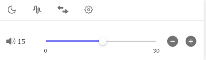

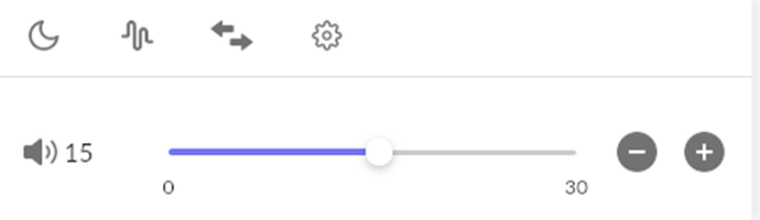

Printscreen other zone:
