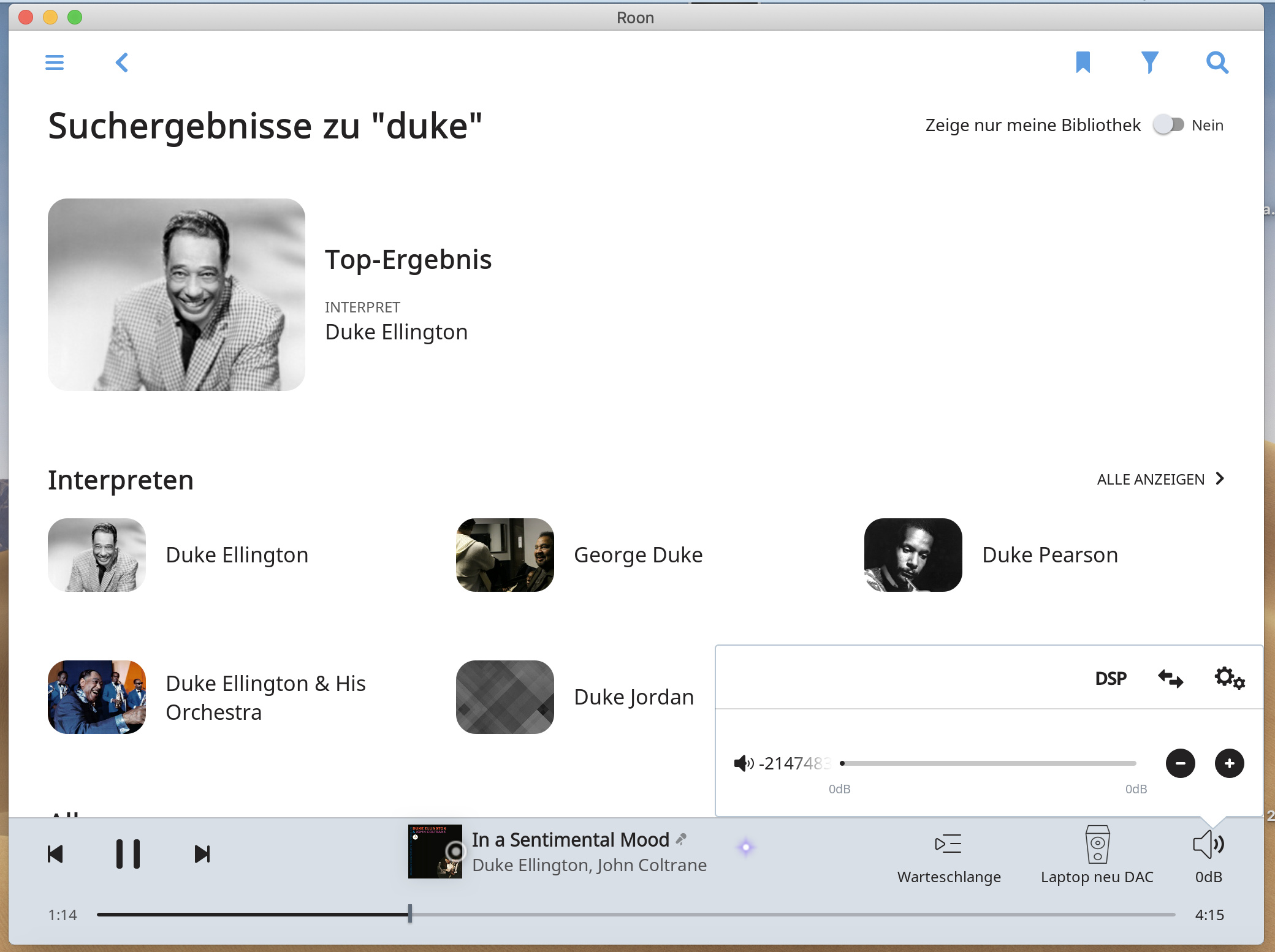

Dear John,
so Done (same as previous) see screenshot 1
With play a title, no volume control is possible, (not „+“ ‚ „-„ Buttons, not slider, nor any control elements of the macbook)

Hello @familie_ehr,
It appears that something has gone wrong with the volume control in Roon. If you restart your computer, does the volume still show the large negative number in the volume widget?

I tried out:
(A) restart Mac with already attached DAC: same
(B) restart Mac without DAC attached later then launch roon.app: same
In both case I can see the high negativ number, without a change to change it.
