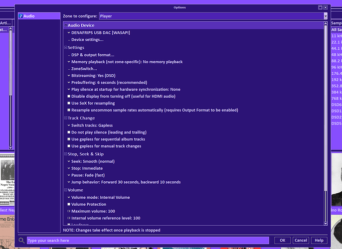

Thanks for the response. I’m not sure you’re correct regarding the Denafrips DDC and the Laiv DAC.
I say this because volume adjustment works perfectly for ASIO and WASAPI when I’m using my J River Media Center software.
That would not seem possible according to your theory.

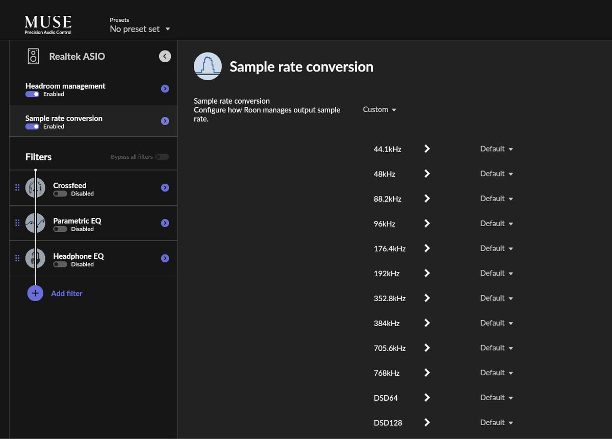

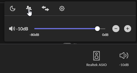

Hello @billhahn ,
You can find DSP settings by clicking on the volume → DSP icon:
Then setting a custom sample rate conversion:

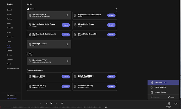

This is going backwards.
Somehow when I was trying to make the adjustments you suggested to the Denafrips USB DAC (WASAPI) driver it disappeared from Roon (see screen shot), but it is still available and working in J River Media Center (see screenshot).
What the heck is going on?

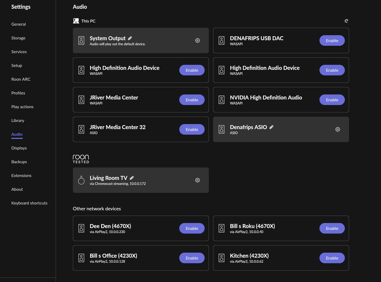

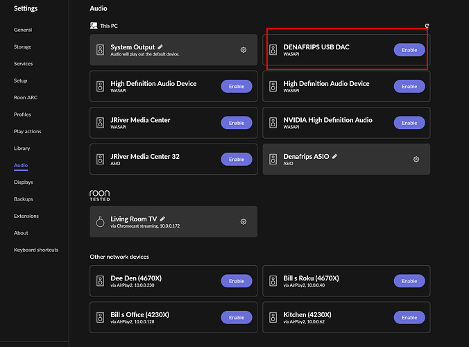

Hi @billhahn,
Thanks for your message. Please correct me if I’m mistaken, but based on your screenshot, it looks like the Denafrips DAC is appearing there. Was that not the device you were expecting to see?
I know you must think I’m crazy, but the WASAPI driver is occasionally disappearing when I switch to ASIO. See attached screenshot. I then have to shut down Roon and go back in and then it reappears. Can you explain that?
WASAPI will now play PCM files, but sometimes I get a failure message and then have to reboot to get them to play.
