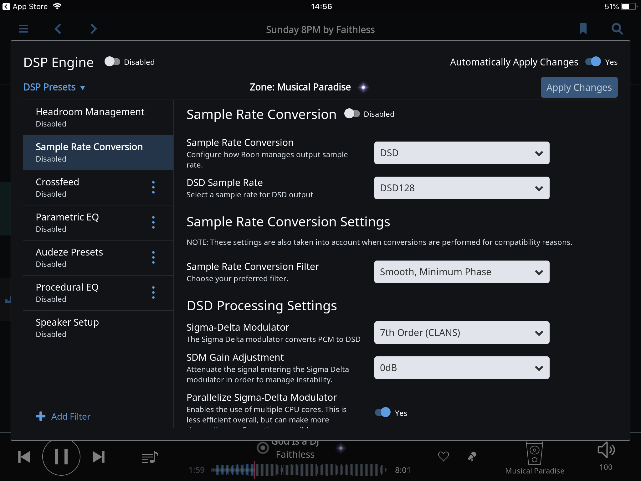

So I have tested the settings in DSP, Whenever I enable any setting in DSP not just Parametric EQ, I get the issue. Bellow are the screen shots of my DSP settings:
Issue Resolved!
By changing the Sample Rate conversion to PCM it resolves the issue.
Thank you for everyone’s input.
John
