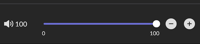

The volume on my device keeps setting itself to 96:
I can adjust it back to 100:
It will stay at 100 but will always reset itself to 96 eventually. This is especially a problem for any upsampling as I lose the signal when it is below 100.

The tech support team investigated some routine diagnostics from your Core, and found that the volume value of 96 is associated with a preset tied to the Oppo BDP-105D’s Zone in Roon through the RoPieee.
If you still encounter this issue after reloading your Backup of RAATServer, then please remove the RoPieee from the chain and connect to the OPPO directly. There’s a distinct possibility the RoPieee is commanding this volume preset.
