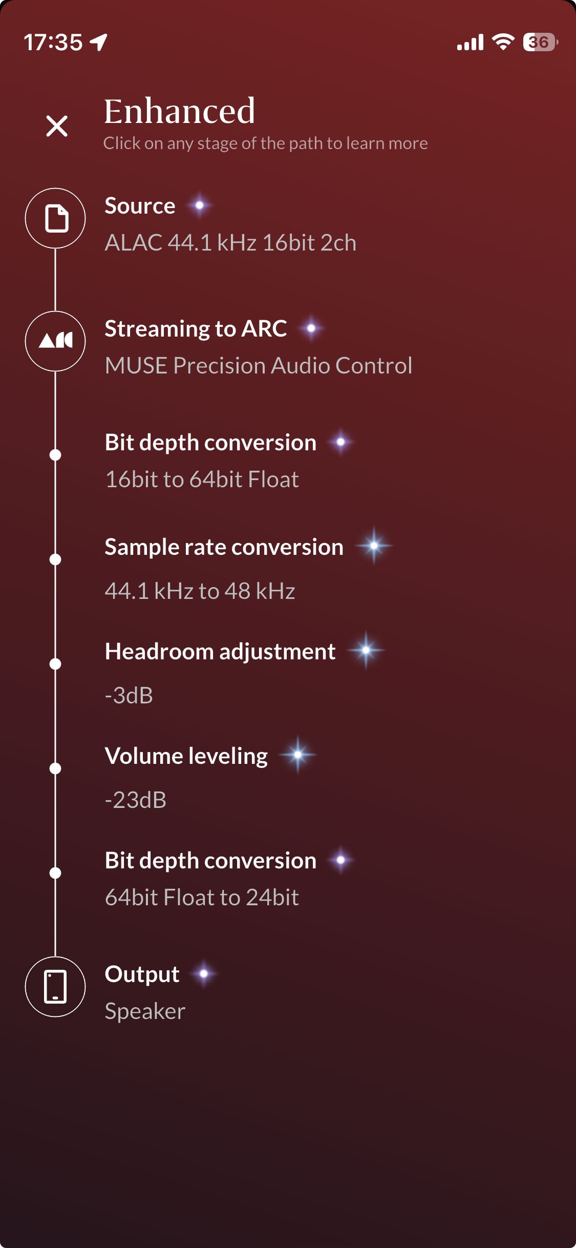

Other albums don't appear to have this problem and behave as expected, but in these specific cases, adjustment of the 'target volume level' via Arc or Roon seems to create a negative db adjustment that is aligned directly to the LUFS value selected (e.g. if I select -19 LUFS as the target, the UI reports -19dB Volume Leveling, for -23 LUFS the UI signal path then reports -23dB, etc.) and none of these dB value adjustments correlate to the real gain adjustment that ought to be applied.

The screen shot above is the result of selecting -23LUFS.

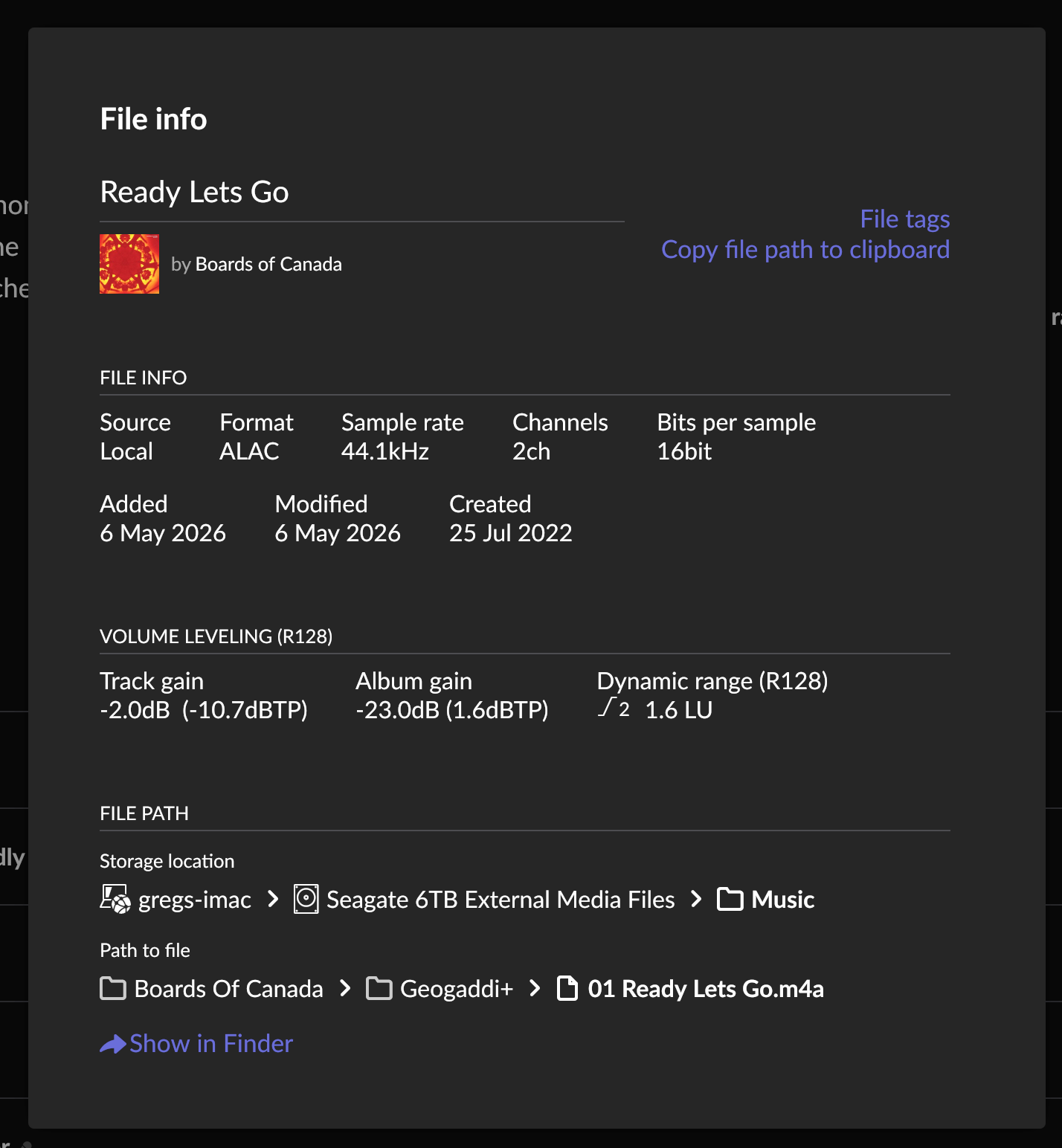

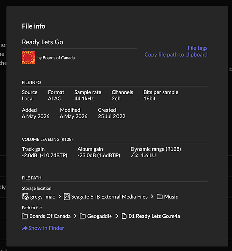

Below is a screen shot of the file info for one of the tracks - they all state the same album gain value.

If REPLAYGAIN_ALBUM_GAIN = -23.0 is present, delete it and let Roon recompute. The file info screenshot confirms the stored Album Gain is -23.0 dB (-10.7 dBTP) — the -10.7 dBTP true peak is plausible, but -23 dB album LUFS is unusually quiet for Geogaddi (which is a naturally louder master), suggesting this tag was written incorrectly.
