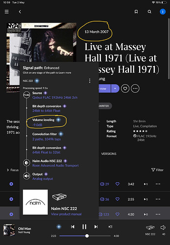

I can only presume he refers to the 0 volume levelling value in Roon’s signal path when volume levelling is active.

-9dB chosen when loudness is unknown in settings:
Signal path:
