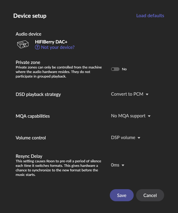

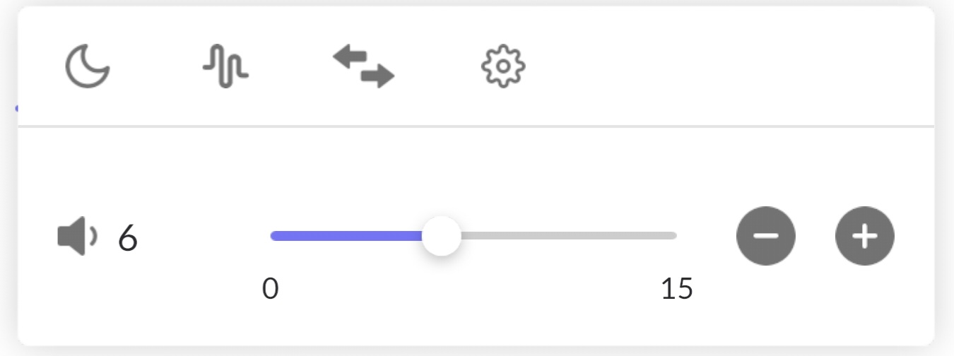

I see on screen that You have DSP Volume control in roon endpoint on. Please check volume slider in this zone.
Maybe this happend low sound noise.

@Oyvind_Rosmer
Why are you using, in “Device Setup”, the “Volume Control” as “DSP Volume” instead of “Fixed Volume”?
I would think that, if you are using your amplifier as volume-controler, you do not want to modify the digital stream to not to play bitperfect.
YMMV.
Kind regards, Frank.
Hence, I advised checking the DSP Volume option. Try changing it to Device volume or Fixed Volume and check it works.
Have tried that
Hello and thanks for your comment.
I use DSP volume because general ease of use and i also have a physical remote for play/pause and switching songs which also can adjust the Roon volume.
I do not find it deteriorates the sound quality so much that i notice it in daily use
To be able to figure this out it is needed you switch back to device volume (hardware volume control). Keep in mind that DSP volume is just software volume control which can interfere.
Switch to device volume control and see if things behave like expected. To do that, focus on a single streaming solution, preferably Roon. Do not switch to other platforms like Spotify.
And report back how things behave.
