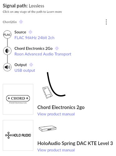

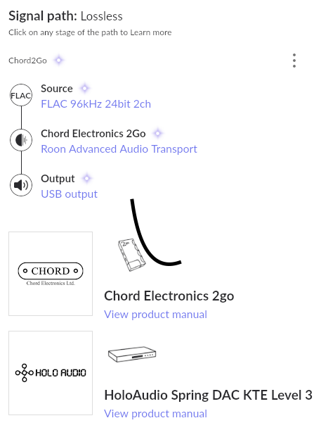

You probably did check the signal path in Roon to verify it’s “unmolested” - care to share comparative screen shots?
Screenshot here

Thanks for the suggestion, My Roon Core/Mac mini is about 10m from the DAC so I can’t do that. I have connected a laptop to the DAC USB and the volume was fine. I also connected the Chord 2Go/2Yu to another DAC comparing optical and the USB and the volume levels are the same so the Chord streamer is fine. The Roon software is somehow screwing just the USB volume around on the streamer and leaving the BNC/RCA/Optical alone. The USB is a pass through on the streamer so I something weird is going wrong.
