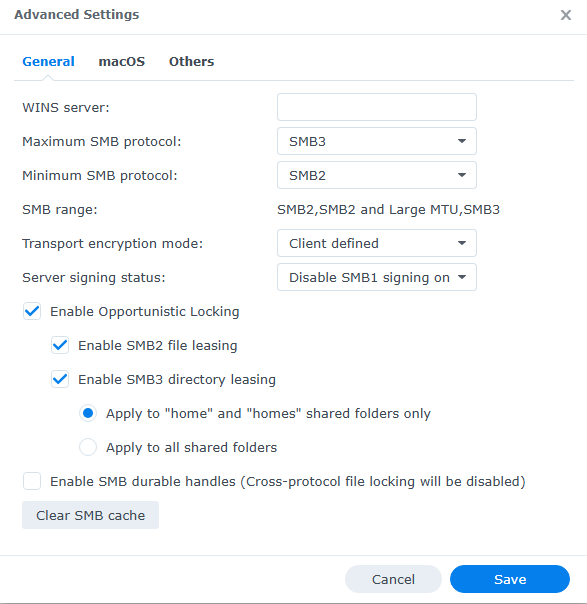

Here are the SMB settings on my NAS:
So it seems that nothing is wrong with Roon Server and that Roon Server can access the remote share quite well. Waiting until the scheduled rescan happens should work too for you.
Realtime watching though depends entirely on the host (of the files) OS and its capability to monitor files / folders and communicate changes to interested parties. For shares it additionally requires that SMB 3 is negotiated as transport protocol. Hardly any of this is under the control of Roon Labs’ software.

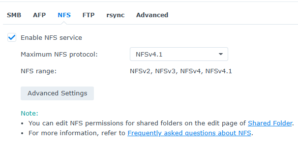

The only thing I recently modified in my setup is the NFS version, I recently moved it up to NFS 4.1 but I don’t think NFS settings impact the Inotify services since Roon uses SMB and my music library is not an NFS share:

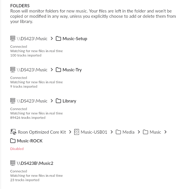

As far as the Roon storage settings, here is a screenshot where you can see both Synology NAS units (DS423 and DS423B) configured and reporting as “watching in real time”
So it looks like Roon negotiated successfully for receiving filesystem change notification. You need to troubleshoot your NASes to find out why they don’t send those notifications as you expect. The most likely reason is still an insufficient max_user_watches value on your NAS.
