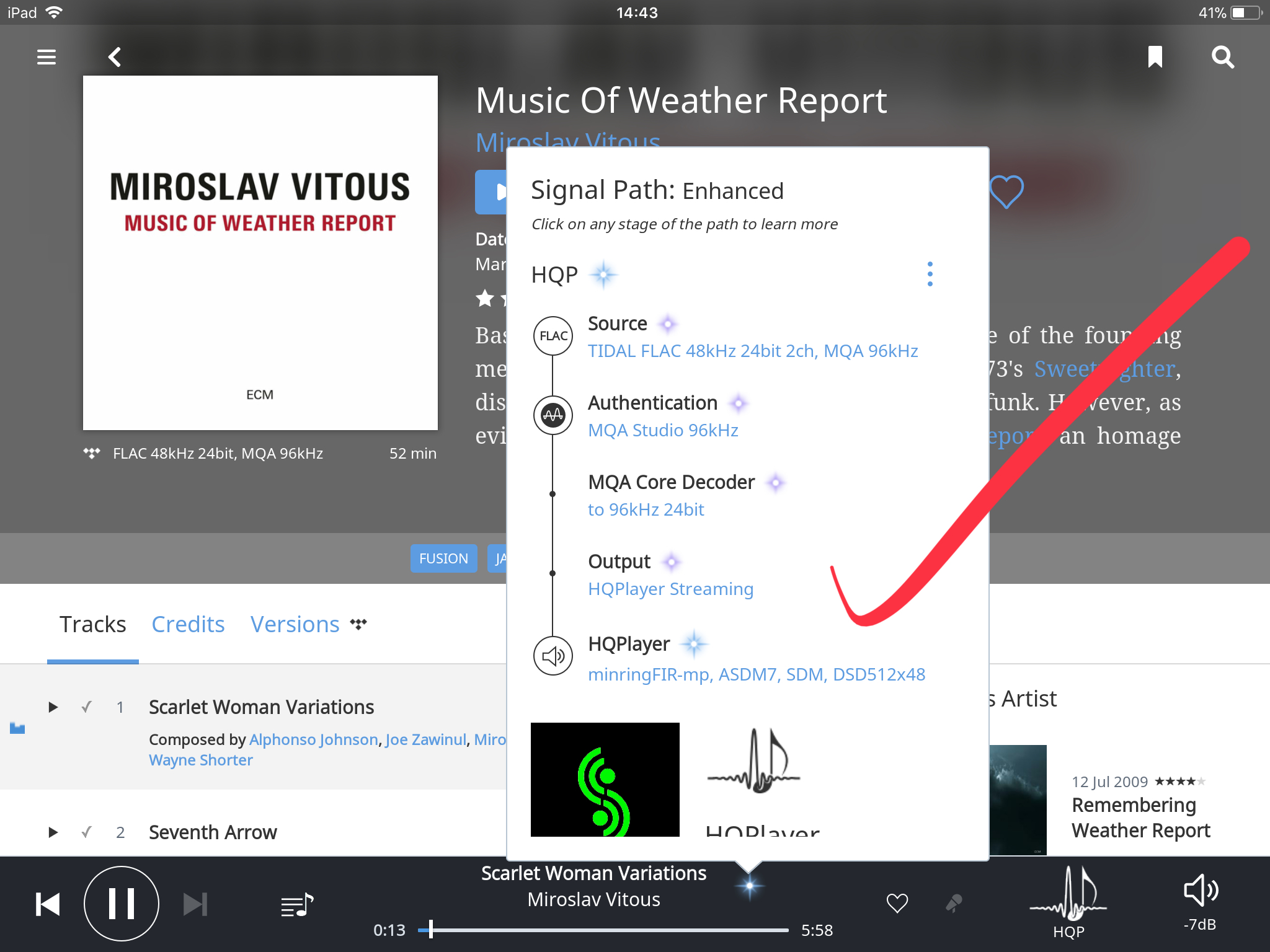

I do indeed! Much of my high res listening is jazz. Spacious, airy, wide soundstage with unmuffled, accurate treble extension is how I would describe what I hear. Hereās a screenshot of the zone setting with the new iOS app. This was the default.

Roon will default to HQP upsampling an unfolded MQA file, but it is best not to unfold files where the MQA content is only 44.1/48 because that is just upsampled to 88.2/96 and HQP can do that. HQP does not render MQA files (in an officially authorised way, it does an equivalent job as per Jussiās post below), but if you set Device Settings for HQP to Renderer only then the information for your DAC to render might be passed through. Havenāt checked it out.
Ok, please forgive my being slow here but are you saying Roonās decoder should be set to off for 44.1/48 and just allow the file to play as normal with HQP filter being applied? I upsample everything to DSD generally
You could do that, but I would find it annoying to change the Decoder setting according to format. Instead I decide which version to make Primary. If all that is on offer from Tidal Masters is 44.1/48 ORFS, then Iāll make a local or Tidal Redbook version Primary. If I can get 88.1/96 ORFS or better, then I make the MQA version Primary. That way I can just leave the Decoder on.
Itās not a huge issue for me and I wouldnāt be bothered turning the Decoder off if all I can get is 44.1/48 ORFS. The Decoder is just upsampling that material, there is no recorded hi res content there. Might as well get HQP to upsample.

Edit: Brian has noted that when the Decoder outputs an 88.2/96 stream for an ORFS 44.1/48 MQA file then Roon is not upsampling. The decoded content has been created in the MQA encoding:

Seems to me that you would setup Roon to just do the unfold (decode, no renderer and have your output in Roon set as HQP. Then the unfolded file should get sent to HQP and HQP will treat it just as it would any other file. You wonāt get the MQA ārenderingā this way, though, just the unfold.
