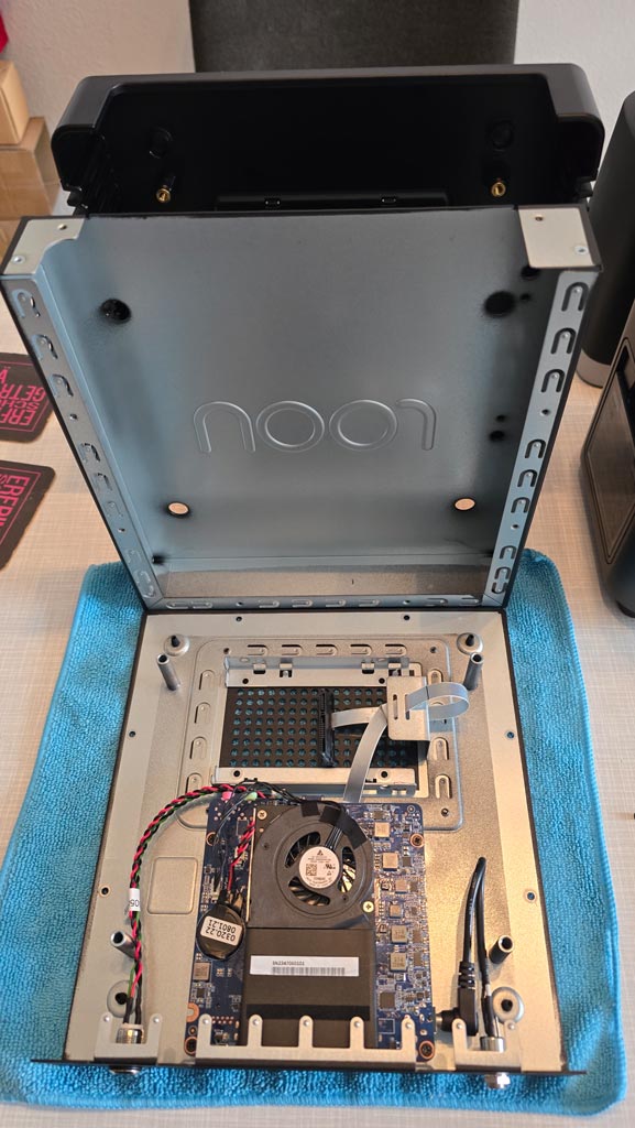

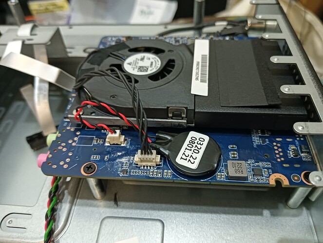

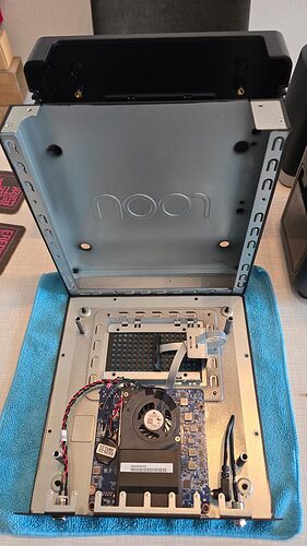

Based on images on the internet the RAM slot, if one is present, would require the whole board being completely out of the casing.
IMG_1466
Edit: I stand corrected. You can upgrade the RAM.
Maybe @daniel can advise further when he picks this up next week

Unlike the NUC8 I am playing with Rock, there is only ONE RAM slot in the Nucleus One, perhaps that’s why it is called ONE.

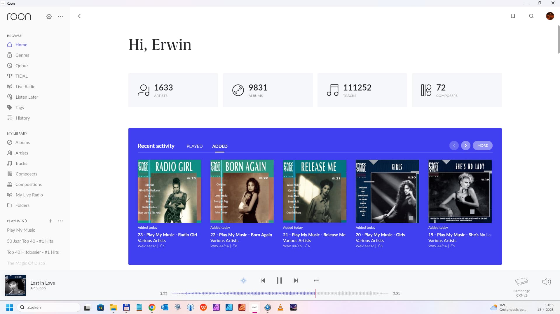

From experience a 124k track library, occasionally jumped to 5 to 6 gb RAM consumption (DietPi). On a N100 CPU I saw good enough performance for some DSP. This computer had 8gb RAM and never crashed.
My current music server is an i5-8500T with 16gb RAM. in the past running Roon with the same sized library as above it consumed the same amount of RAM but achieved better DSP performance and allowed me to run more DSP.

I’m using one of these as my Roon Server running on ROCK. It has 12 gb soldered on the mainboard and a 12th gen Intel N97 CPU. I reckon it is similar to the CPU aboard the Nucleus One.
It handles my 3 endpoints with volume leveling and my iPhone through Roon ARC.

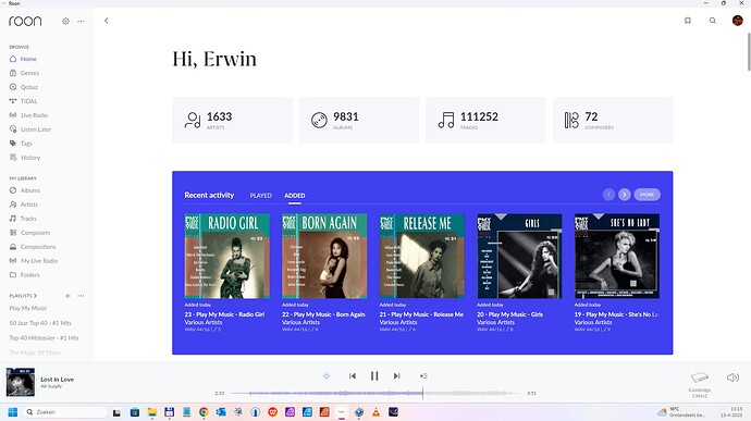

Current library size (local, Qobuz and I’ve just readded Tidal). It still is quite fluent in usage. I believe 16 gb of RAM in your Nucleus should be more than enough for what the system can handle library size wise.

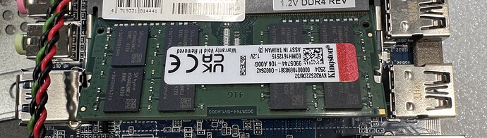

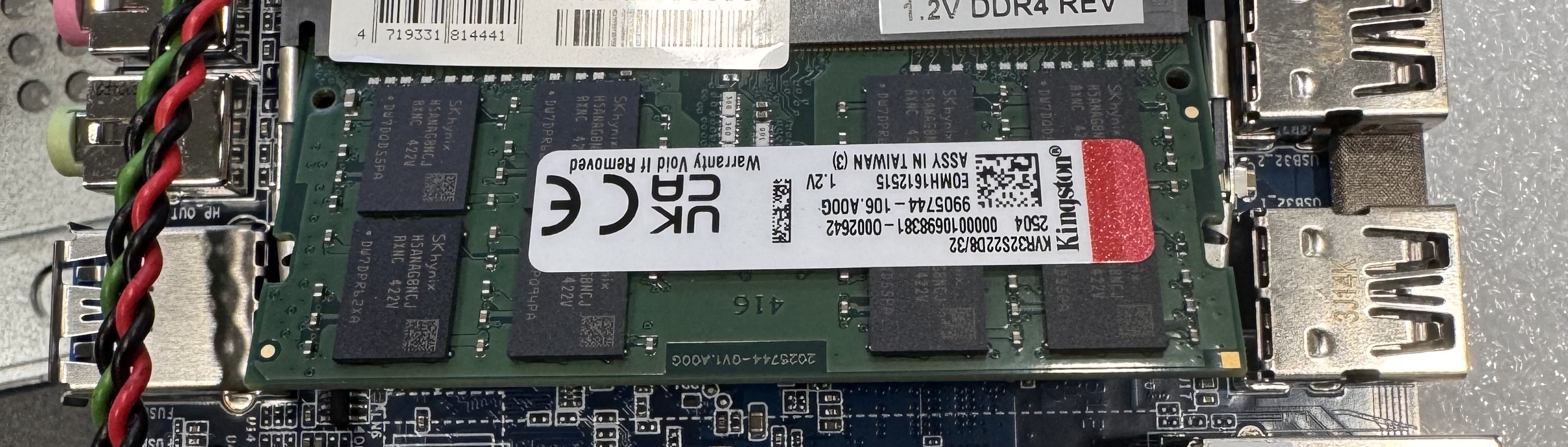

But it’s too late to take further suggestions from you guys because I was out and bought the 32GB RAM already.
It’s okay as the price difference between 16GB and 32GB is about USD10 only.
Truly, I don’t hear any difference in sound quality with the extra memory.
However, whether it’s placebo effect or not, I do feel the machine runs smoother especially when listing my 5000 something CDs in album views, and sorting customized playlists, etc.
That’s 100% worth the upgrade in my case.
