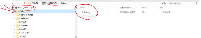

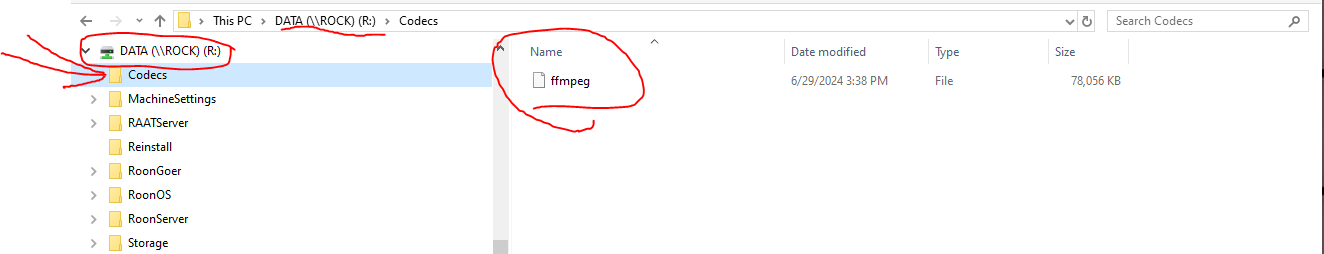

There should be an FFmpeg in the uncompressed file and it should go here:

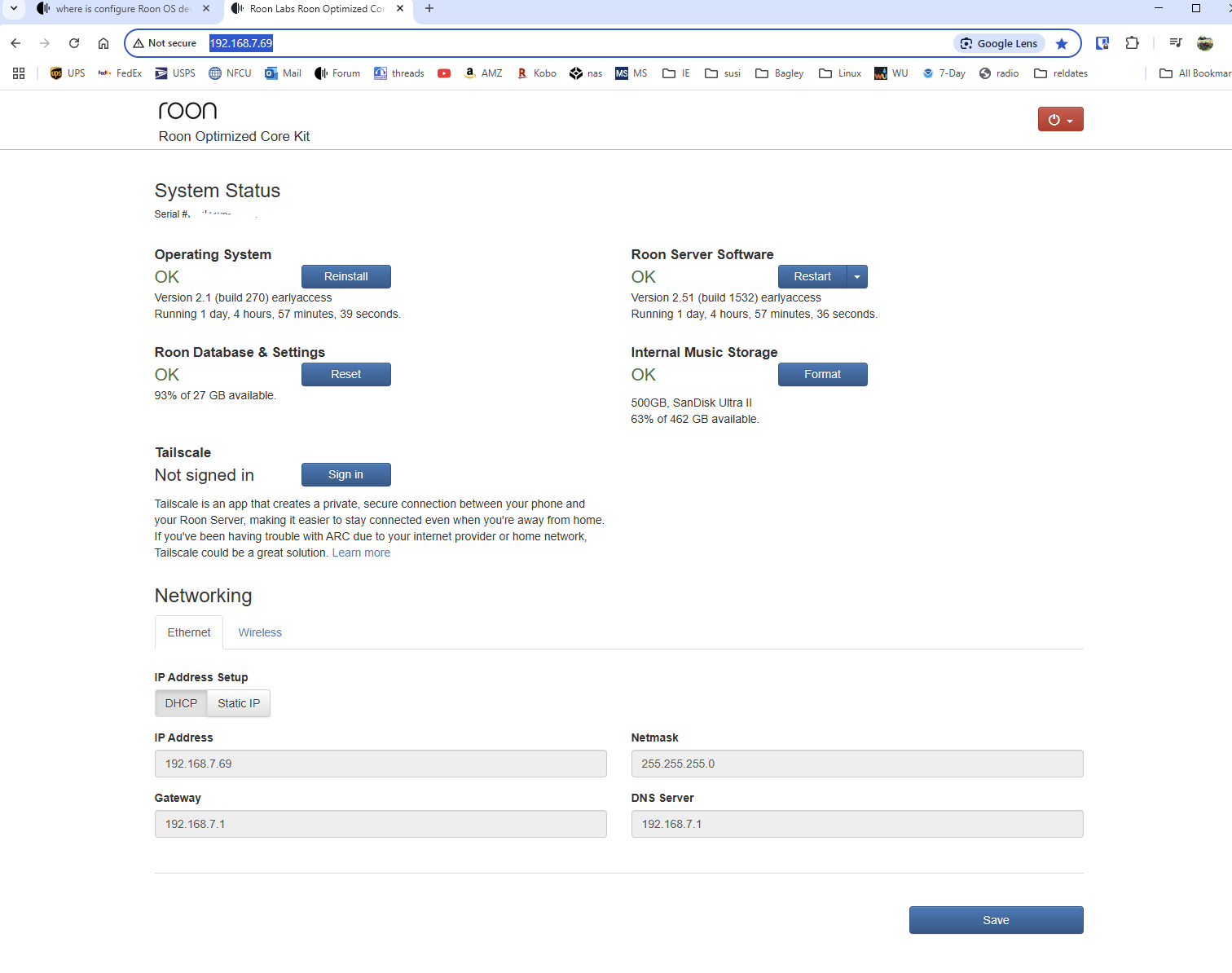

There are some settings in the WebUi (WiFi, ethernet, internal disk, etc) and some settings are in Roon/Settings. So depending on what you want to change you will need to search around a little to find it.
To check the configuration of the Rock(Roon OS) you can use your browser and enter the IP address.
assuming you have proper access setup in your pc/macs firewall/settings.
It should look like this:

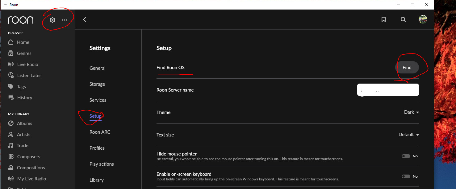

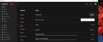

You should also be able to access it from within Roon from the ā€œsettings/setupā€ page by clicking on ā€œfindā€ in the ā€œfind Roon OSā€ section (again assuming your firewall allows the connection):
