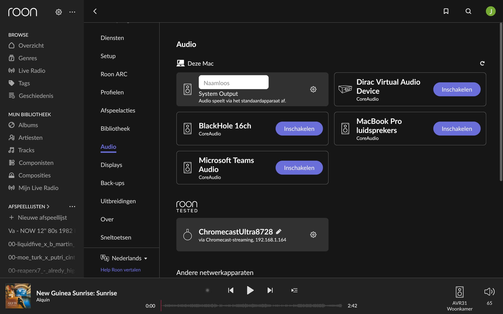

Too bad, HDMI doesn’t provide me with multichannel setup either. Besides the Arcam, 2 other output devices show up: ‘Dirac Live’ and ‘16 ch BlackHole’. Both have the multichannel setup-possibility, but I can’t seem to get any sound from these outputs.

Can you post a screenshot showing these devices in Roon’s Settings > Audio screen?
Hello Geoff,

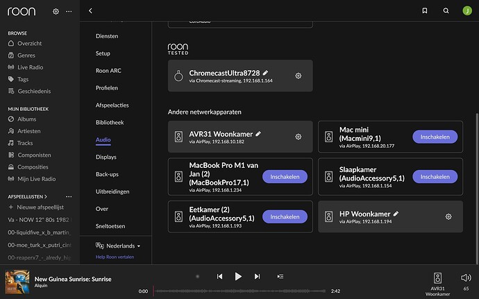

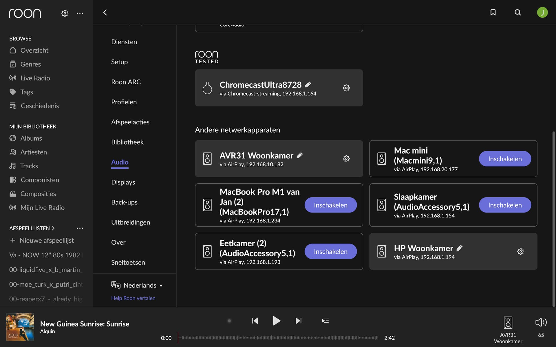

it has been a long time in which I couldn’t visit the forum for a number of reasons, but having a new ISP is the main cause for being ‘back in business’. During this time I’ve lost my working Roon setup, i.e. I’m not able to play any music (stereo or multichannel) through my AVR31. I cannot figure out what the problem is and although I’d still aspire to make multichannel audio possible through the Arcam, first I’ll have to establish a working Roon-connection to it. I will post the screenshots of my Roon Settings->Audio for clarification:
Looking at that second screenshot, I notice something odd about the IP addresses. Most seem to be in the IP subnet of 192.168.1.x, but your AVR is in a different subnet: 192.168.10.x, with its address of 192.168.10.182. This is probably the issue…
