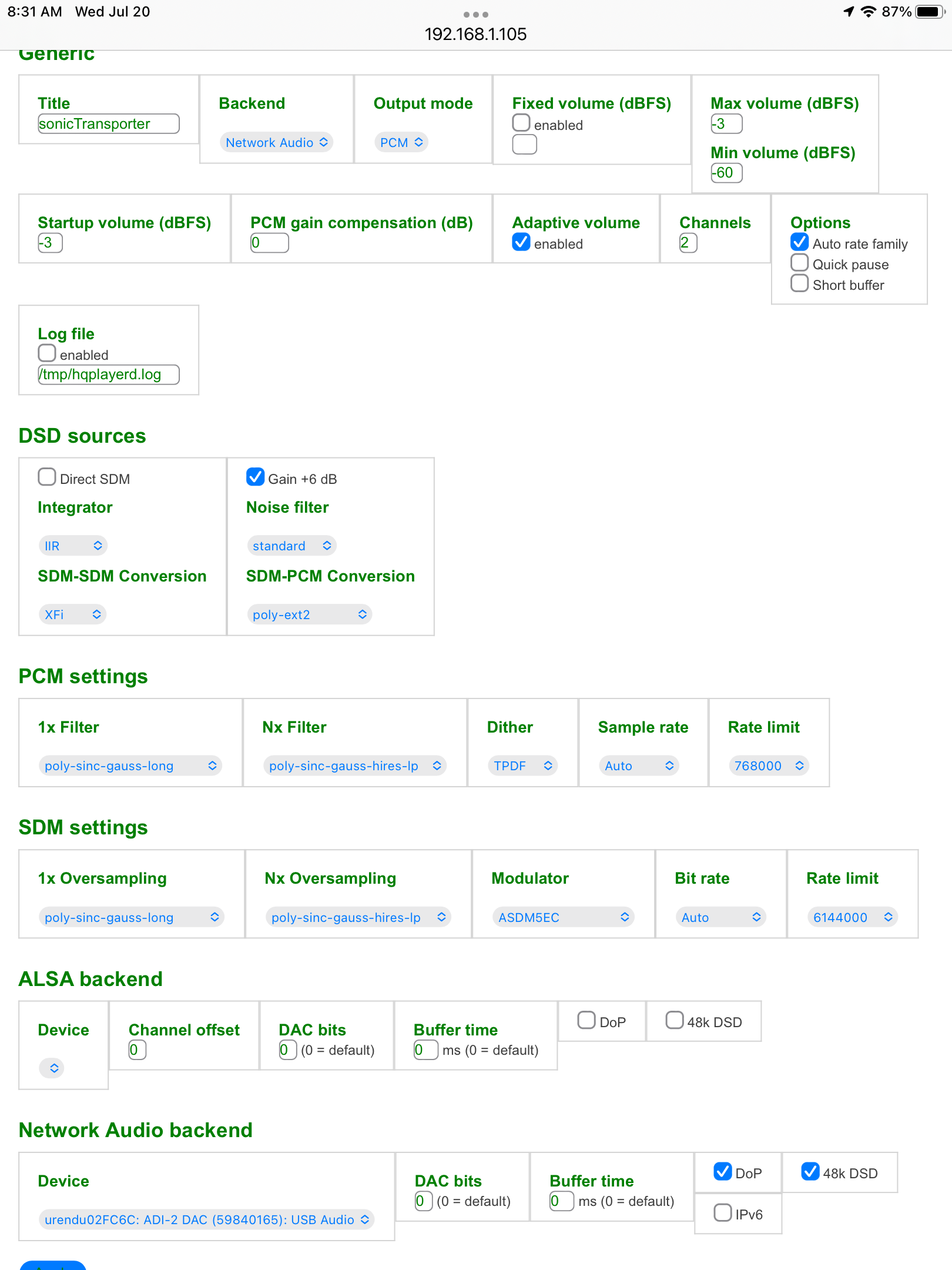

So I’m good on DSD but can’t get audio from PCM…any ideas?
Check if the ADI-2’s volume knob is down low? Or are you using headphones?
Also enable ipV6 at the bottom there
Also use LNS15 for dither at 768k
Everything else looks fine
Thanks, it was the Dac. Forgot the remote volume was active in PCM. Had it muted.
No worries. Those other things I mentioned above weren’t related but still recommended
