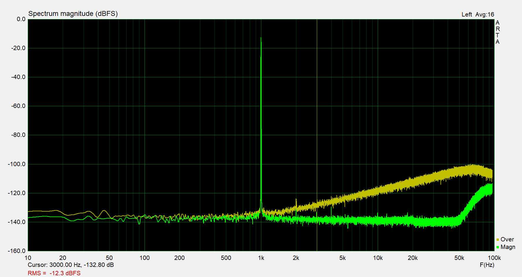

Hi, I am using mostly AMSDM7EC 512+fs for DSD512 and AHM5EC5L for DSD1024. I might be interesting to know the noise levels, as Jussi points out that the AHM modulators have increased noise level.
The measurement shown is done with Focusrite soundcard connected to my DAC output. The noise bump at 100kHz, when using DSD512 (green), is from the sound card, as this bump is also measured with input cable unplugged.
You can see that the DSD1024 noise increase is 6dB/oct, starting at about 1kHz.
what app are you using to monitor your hqplayer host there?
The spectrum analyser function of ARTA software. Kaiser7 window.

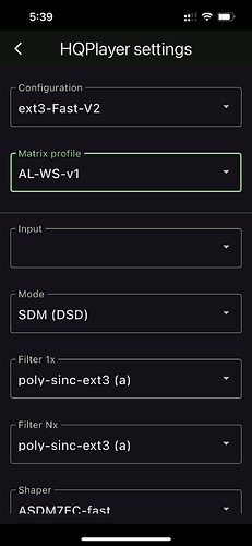

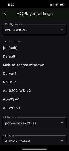

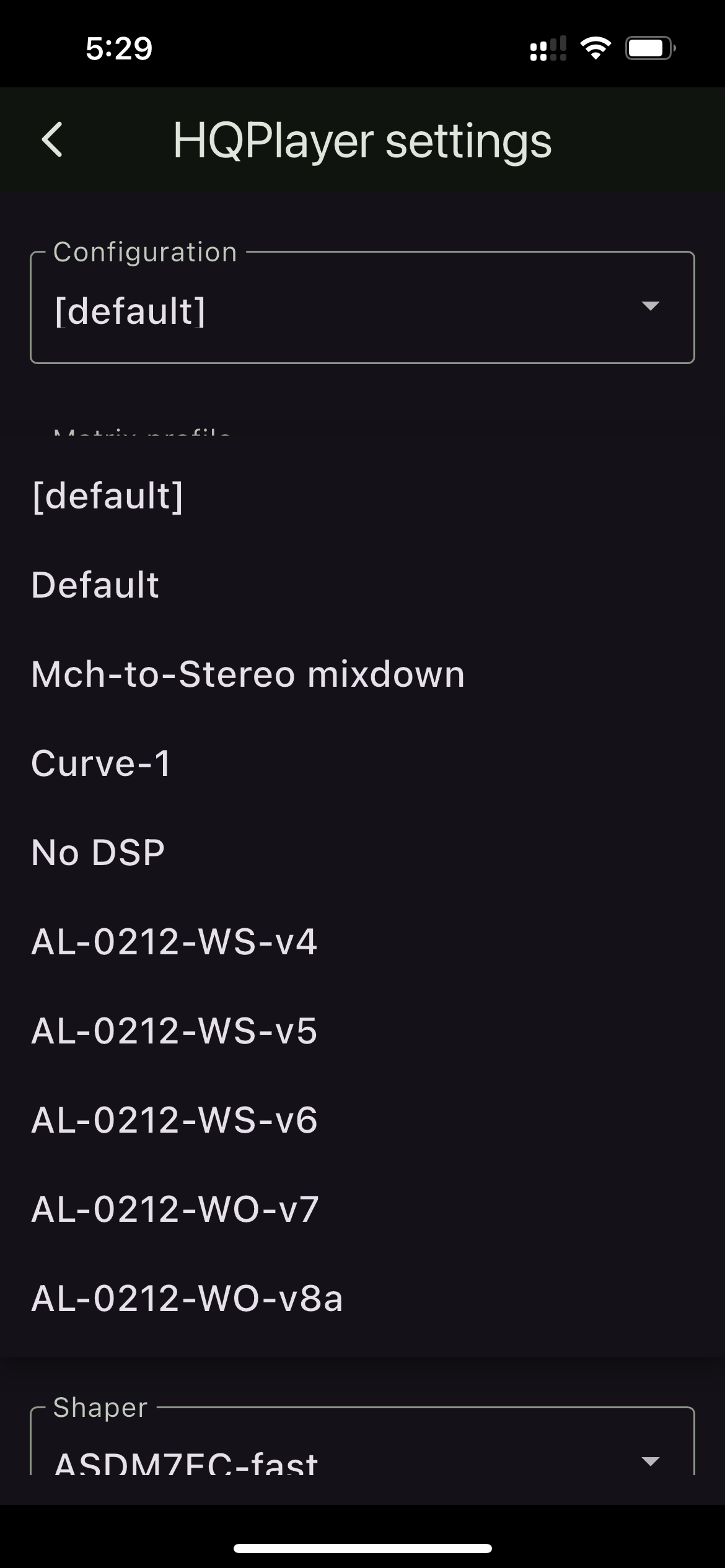

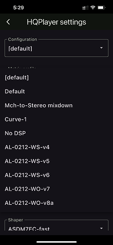

Found a bug :ant: on the HQPDControl mobile app. If you are in [default] configuration, you can see all updated matrix profiles. All work’s fine.
But if you open any particular configuration, it will show you only the matrix profiles that were created the last time but they will not show the ones that you created on [default ] configuration.
And also will show you matrix configuration profiles that have been deleted “AL-WS-V1”.
Will play with no sound because that matrix profile shown is non existent.
Anyone seen this on?
Same, why ?
Don’t know but I’m sure @jussi_laako will check and fix the bug :ant:.

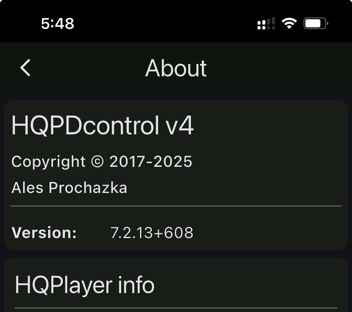

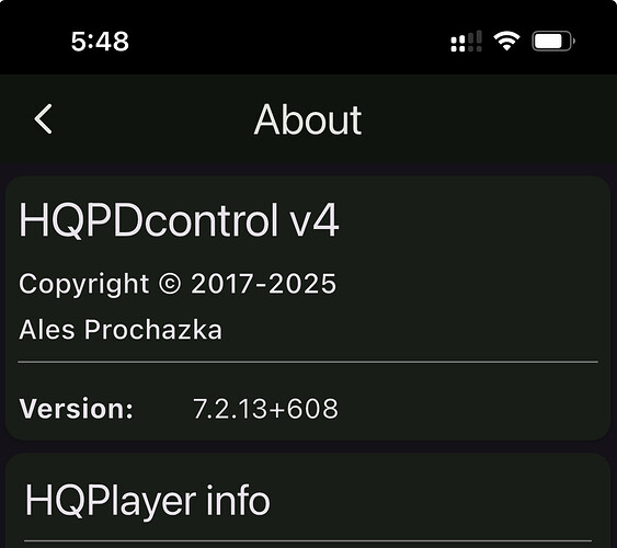

Edith: I just realized the bug is on Hqplayer Embedded 5.11.0, the app mirrors the server
