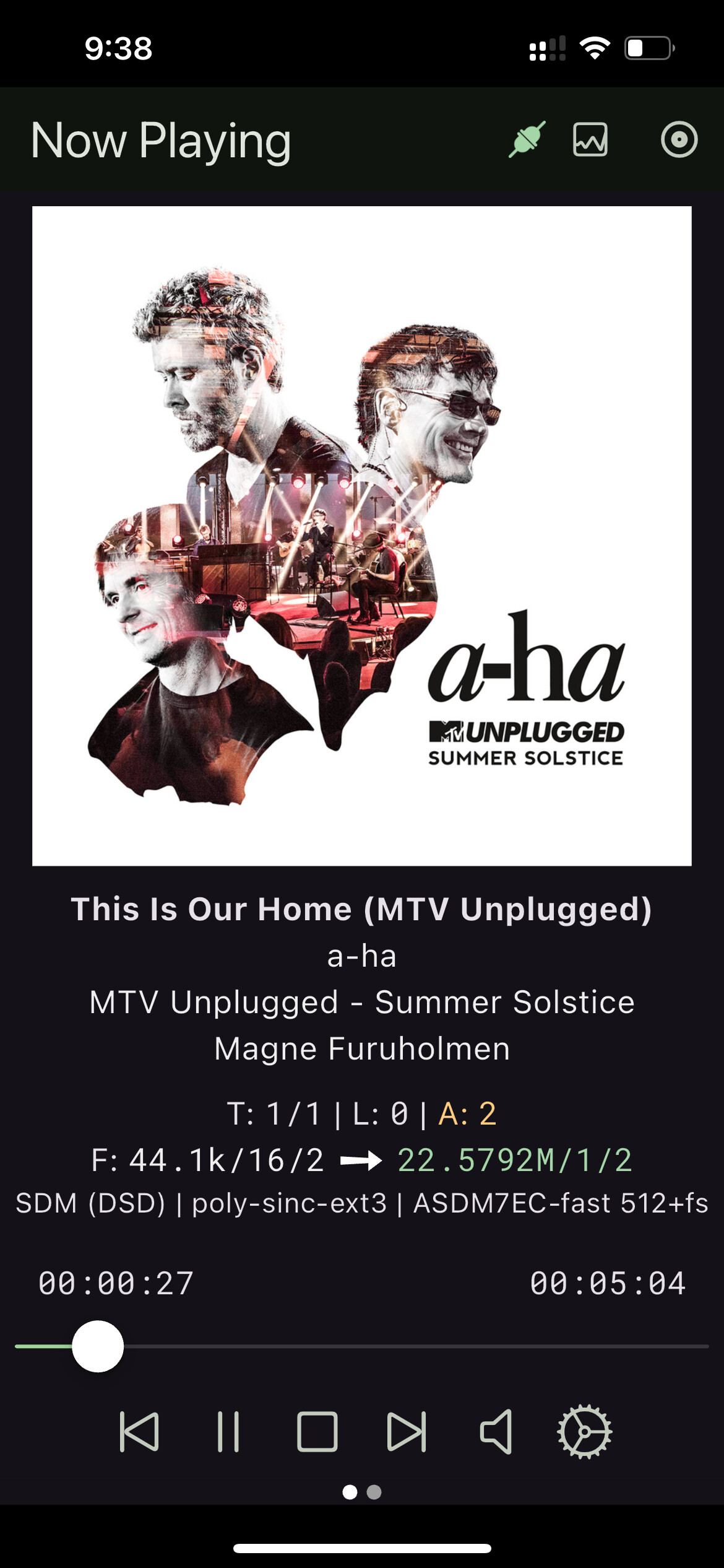

I used to default to ext-3 for, like you, timbre, but these days I am really diggin’ sinc-MGa + ASDM7EC-fast 512+fs. I am a set-it-and-forget-it kinda person and don’t want to have to adjust filters with every song. Of course, I probably spend almost as much time comparing different permutations to find that elusive perfect setting :slight_smile:
