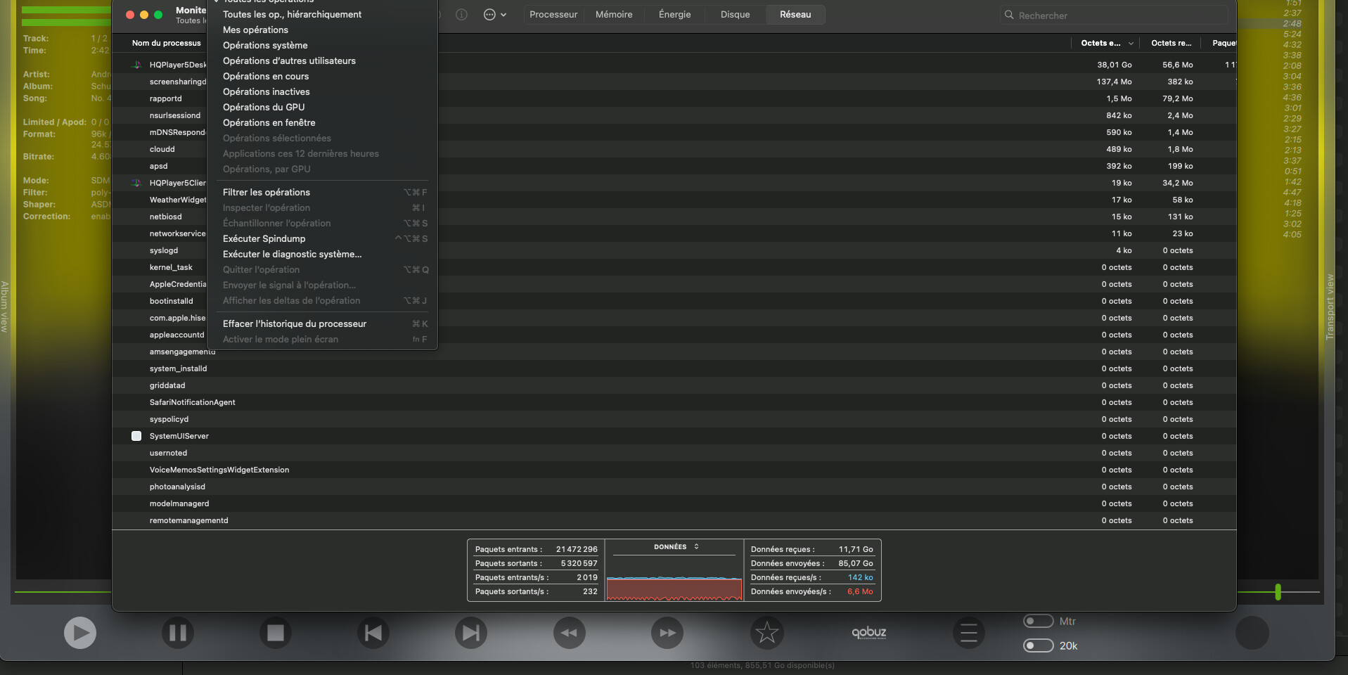

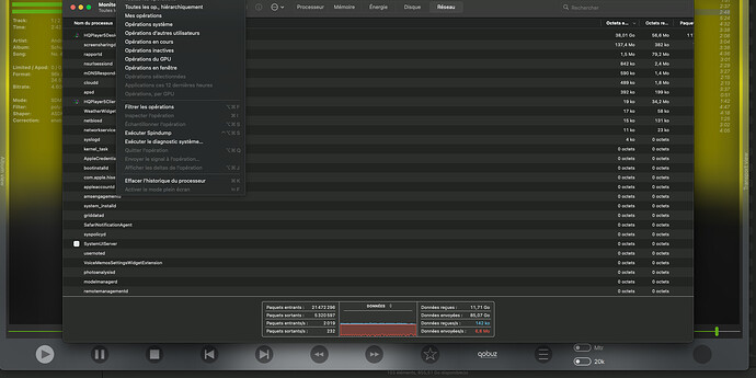

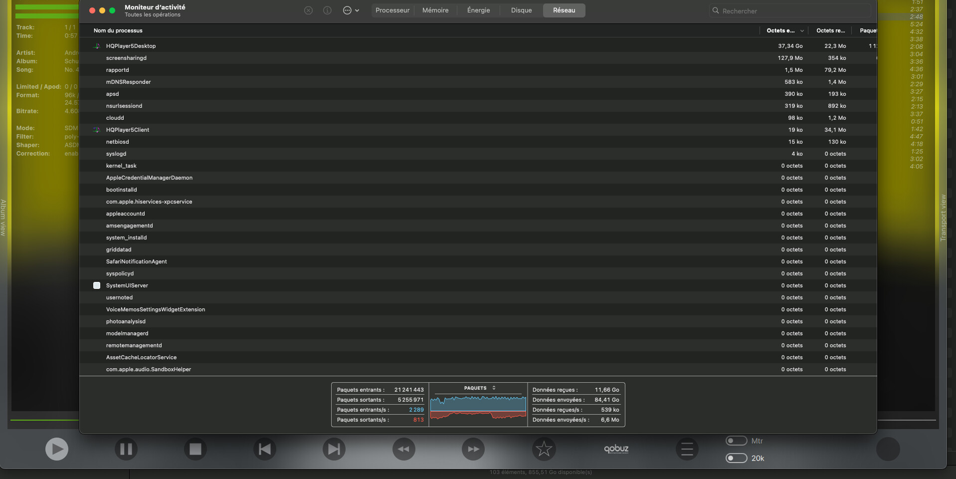

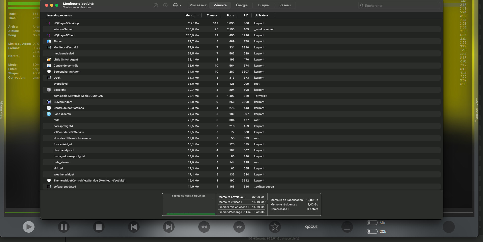

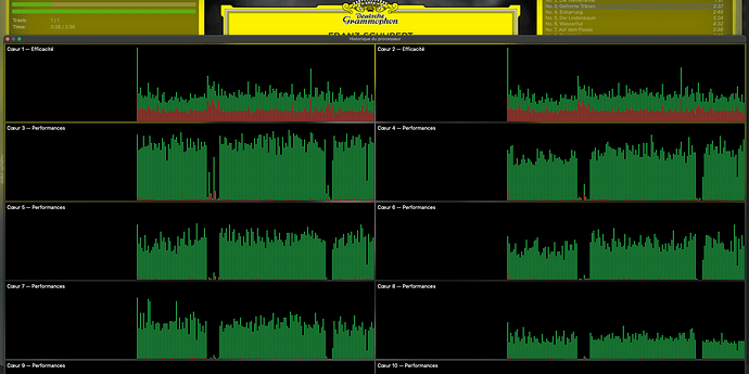

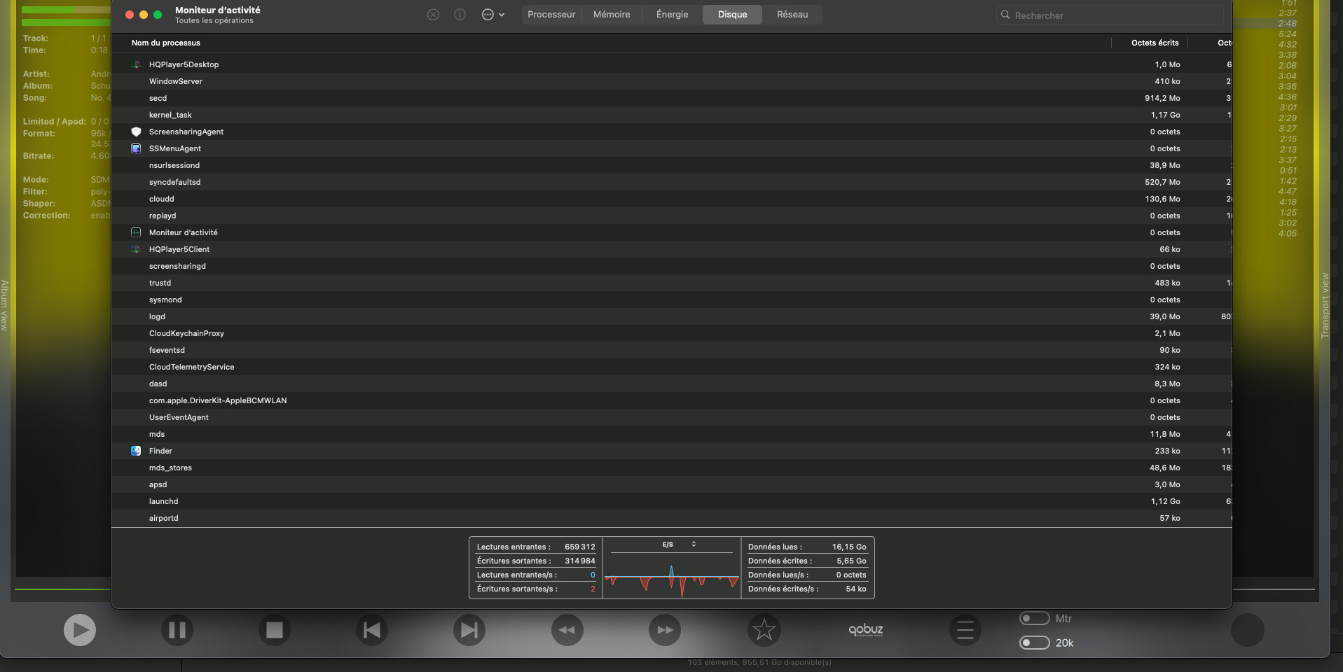

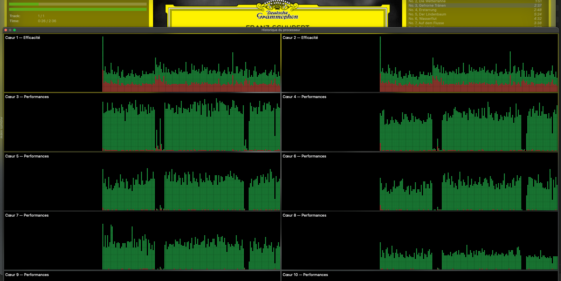

Can’t do DSD64 to 44.1 x 512, can’t do 192 to 512 be it 44.1 or 48 based. 1 s interrupts every 20 seconds or so. 96 to 44.1 x 512 is the most I can do.
Don’t know what to investigate. In the attached screenshots is recorded a sequence of 44.1 to 44.1 x 512, 96 to 44.1 x 512, 96 to 48 x 512 streaming Qobuz with poly sinc gauss long filter, convolution, correction. Same issues if tapping from Library, tried once but not recently using 384 convolution filters instead of 352.8 and no luck.
All settings per standard recommendations( FIR2 XFI convo add etc

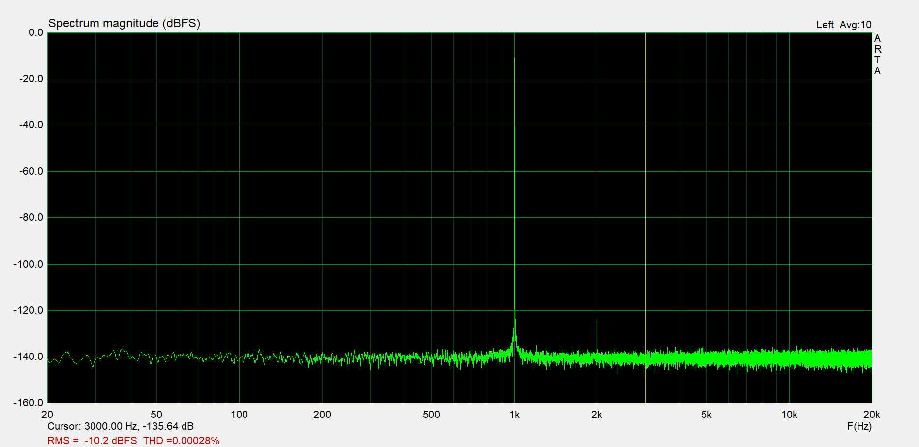

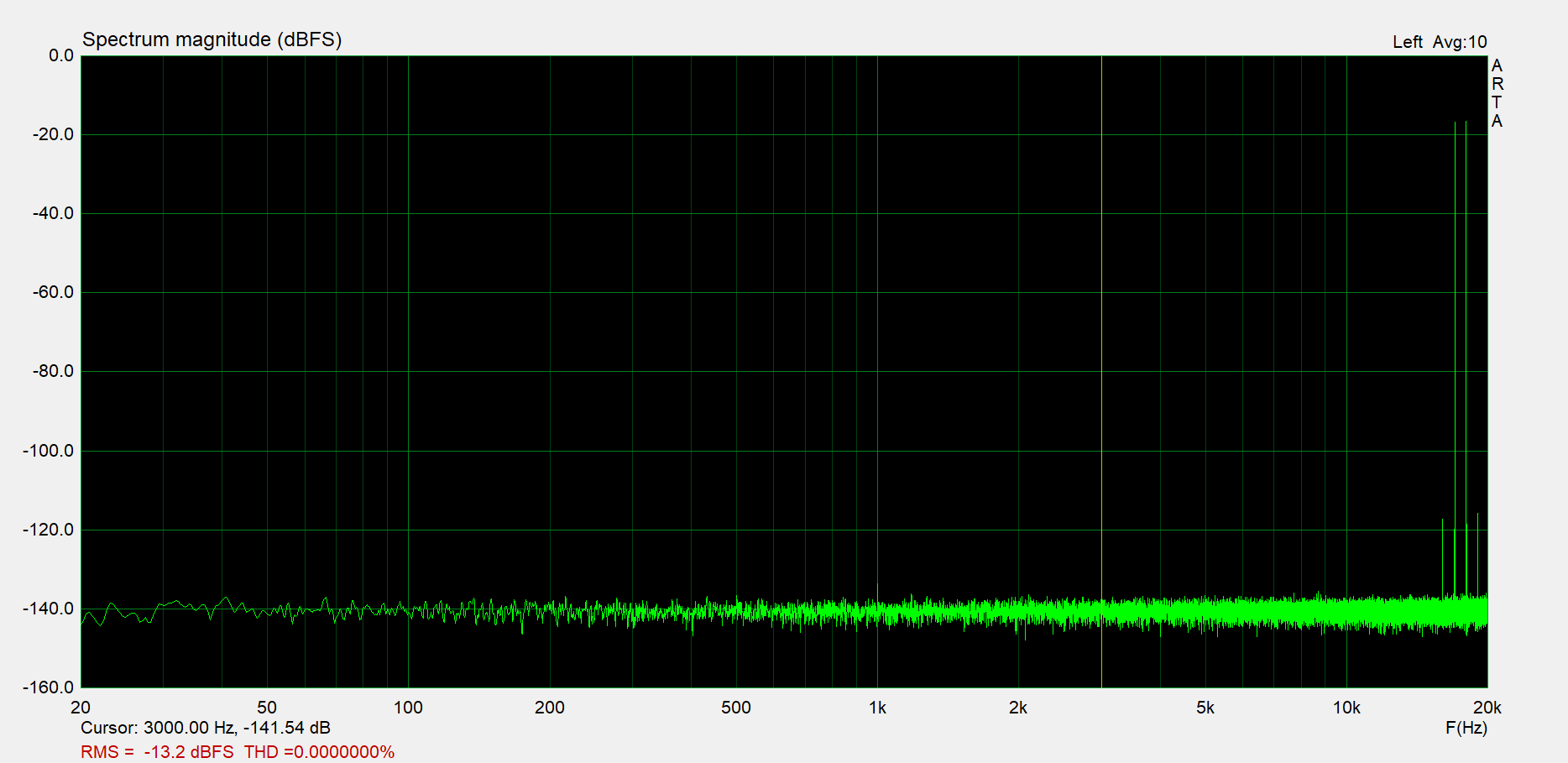

Jussi, I found out what the problem was. A bad capacitor in one of the two channels terminating the resistor network of my DSC DAC.
Now I have a veeeery clean signal. DSD1024 with AHM7EC8B now gives the best objective performance of all modulators regardless of DSD rate!
