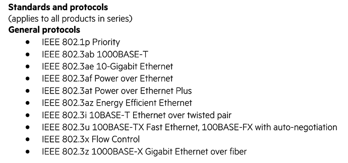

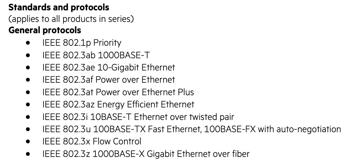

I now have a Aruba HPE 1420 and the issue of vinyl like static /packet loss is not solved. This might be expected since you rather diagnosed a USB packet loss issue but as much as I could think of the Time capsule or the ISP box as liabilities I don’t fig what goes wrong between a Holo Red and a Holo May linked by a Holo provided USB cable… (Holo’s OS & drivers did not solve the issue, neither a certified Belkin cable…)
Just for the laugh I began to very much enjoy anew AHM7EC8B the while it worked without static. Its sound is very very different compared to other EC modulators and even PCM. I know HQP goes to show that there’s no absolute in digital but either AHM7EC8B is phoney or the rest is… Technically how do you explain the laid back, further back in the soundstage (comparatively the rest is more “in the face”) with the drawback that it sounds less lively ?
So the only network device between HQPlayer and NAA is now the HPE switch? Seems to be a big mystery…

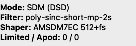

M2 Max doing good with be below combo, 7EC 512 sounds great with poly since short mp

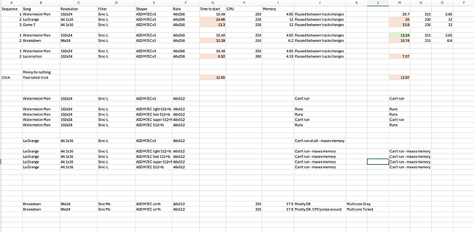

Just an update on my new Mac mini.
I upgraded from the M4 Pro with 12 cores and 24 GB of RAM to the 14 core with 48 GB of RAM
I ran a few tests including speed to start a track, and CPU and memory load.
I used Sinc-L as that was my preference at the time, and because it was demanding and slow to load. I could perhaps have done other options but didn’t have time.
In short absolutely zero difference.
Perhaps unsurprising as online reviews and Geekbench seemed to show no difference in single core performance with the extra two cores.
The memory usage doesn’t seem to go much past 26MB on the worst case scenario I could design, so it doesn’t seem to take advantage of the extra memory either.
It still couldn’t do 512 with ASDM7EC-super with Jussi’s default filters (PSG long or in my case xls, or hires-lp). It can do fast. Again, this matches the performance of the 12 core.
