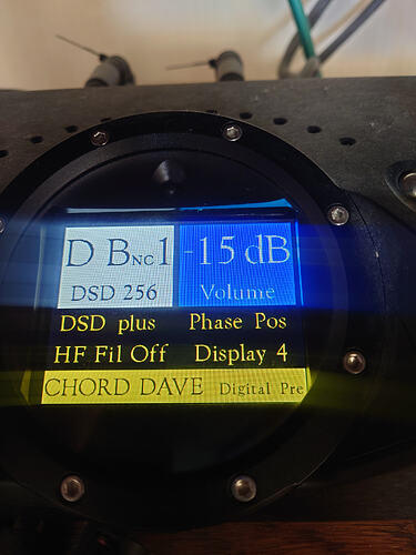

Or get a Chord Dave. I am playing 256DSD dual BNC input to DAVE. No changes like other Chord dacs do.
