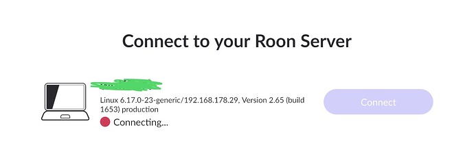

Hello all, I did manage to install ROON-Server on my Linux MINT device. I can “see” the server from my iDevices.
But the connection does not establish.
Any advice on where to look for making things work?

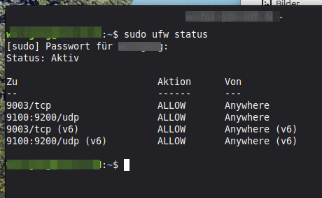

Are you running UFW (Uncomplicated Firewall)?
How can I find out? I am new to Linux. How would I check this?
In the terminal, type the following:
sudo ufw status
sorry, I did not understand that UFW in the end means “the firewall”
Yes. it is running. And these are the ports in use…
Is this correct? Anything missing?
Okay, you’ll need a few more rules. But before you try them, please turn off the firewall first to check that Roon connectivity works.

Just a quick note: With the firewall disabled, I can easily connect to the ROON server via my iPAD. :grinning_face:
That confirms what I expected, i.e., you are missing some rules. Of all the guides in the forum this should be the definitive version for UFW.
I have found the time to follow those wonderful instructions you provided, and “tataaa…” The ROON App on my iDevices does find the new Roon Server with no problems. I can proceed configuring it. :grinning_face:
