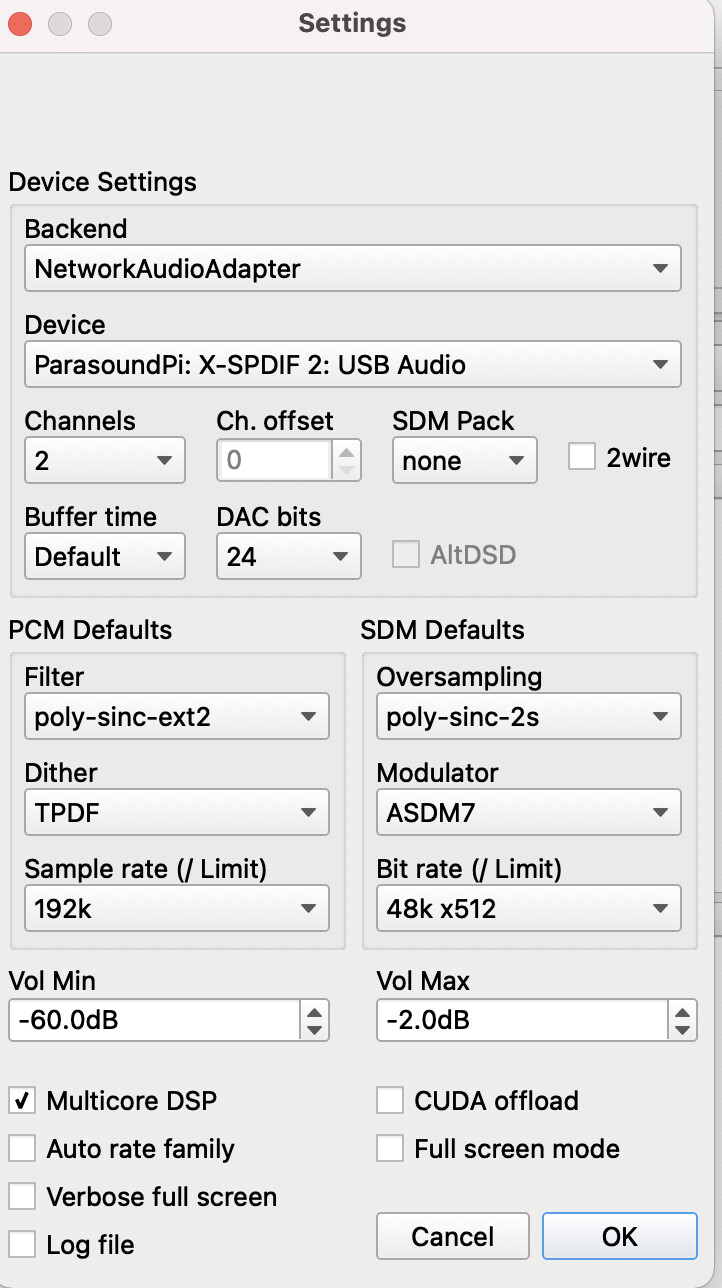

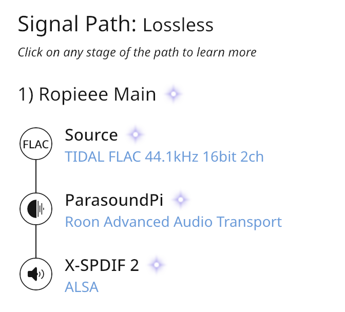

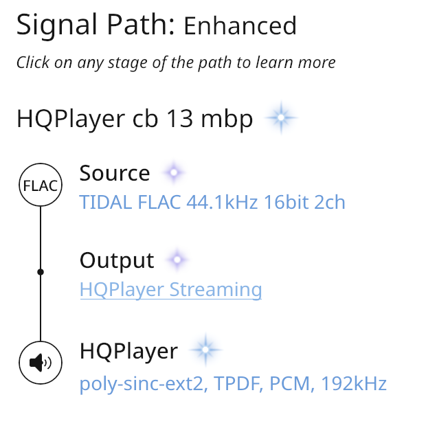

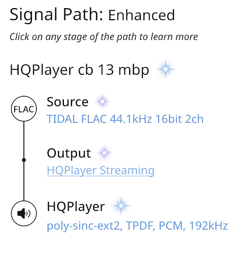

How does Roon signal path look like in both cases? And HQPlayer main window during playback?
Ok here are the screenshots but I just discovered something…
If i’m playing through Roon directly, and increase the volume (because it’s set to device volume, not fixed) and THEN transfer to the HQPlayer zone, the volume level is increased along with it. (So, it seems I can get plenty of volume in HQPlayer, but I just need to increase it in the previous zone.)
Volume in HQPlayer stays at -2.0 dB either way.
