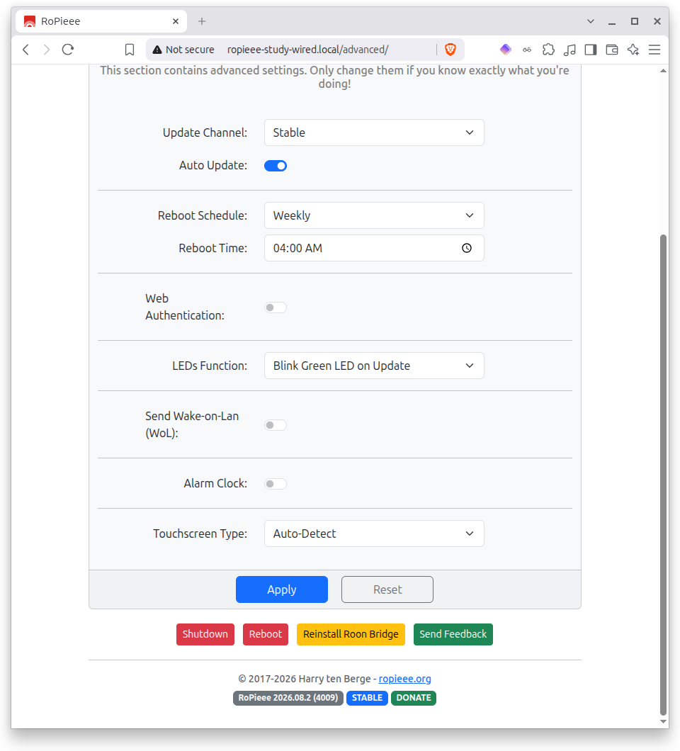

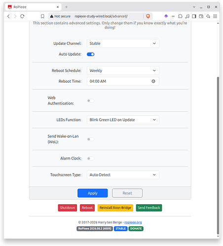

For @spockfish to see the logs, please use send feedback for the code.
Also, if you haven’t already done so, reconfigure Ropieee so it is using either Ethernet or WiFi.
hi - sorry who is@spockfish and is there a github repo where I can post the logs? My wifi is very strong and the pi is basically floating in air a few feet from AP where I also use for my work laptop. Something in OS is going wrong…unkess I got a bum Pi…
Harry AKA @spockfish is the author of Ropieee. To send feedback, go to the web interface, and select the Advanced tab…
Use the Send feedback button to send logs.
