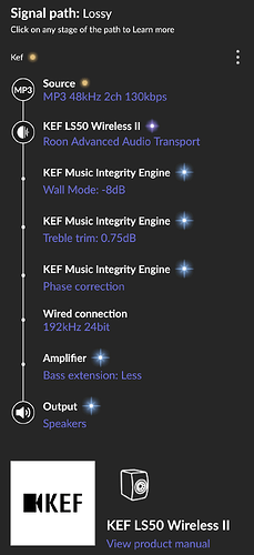

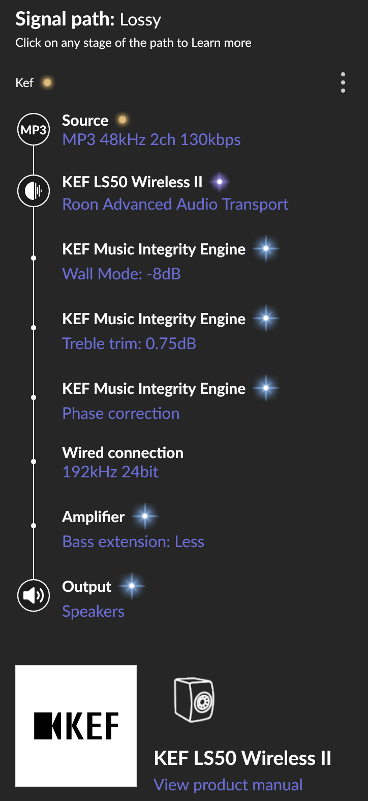

How much does ROON know about the endpoints connected to it?
I know that ROON can tell if I am using a WASAPI, ALSA, or Sonos endpoint.
In the case of ALSA, ROON knows the device name and hardware capabilities. Not sure about WASAPI and whatever WiiM is using.
I doubt that ROON has a mechanism to know what kind of EQ and other parameters are being applied downstream, or even if those parameters are fed back to the host by the driver.
Anyone have a definitive answer?
This depends on what the device reports to Roon and is different for different devices. There is the option in RAAT but it doesn’t seem to be a requirement in Roon Ready specification to do it.
Hegel, e.g., reports something:
Agreed. Check this out:
