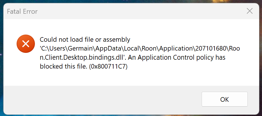

· I can't log into Roon
Have you been redirected to [https://account.roon.app](https://account.roon.app) (the Roon login page) in your browser?
· No
Record the timestamp
· It keeps happening since 10am in Belgium (+1) when I started my PC.
I get the message: Could not load file or assembly 'c:\....\Roon.Client.Desktop.bindings.dll'. An application control policy has blocked this file. (0x800711C7)
Lenovo ThinkPad (new since 1 month) , home network based on Telenet router and cabling to Unify antenna at 5m from laptop
Hi @Germain_Verbeemen
Thanks for the details. That error is coming from Windows or your security software, not from Roon: something on the machine is set to block unsigned or newly seen executables, and it caught Roon.Client.Desktop.bindings.dll because that file is new, it came in with your last update. This isn’t a sign of anything wrong with Roon, it’s a false positive from an Application Control policy.
To get past it, could you please check the following:
If this is a personal laptop: open Windows Security > App & browser control > Smart App Control, and check whether it’s turned on. If it is, you’ll need to either add an exception for the Roon folder or turn Smart App Control off to let Roon run.
If this ThinkPad is managed by your employer, or came with pre-installed corporate security software (worth double-checking given how new it is): the policy blocking the file may be centrally managed, in which case only your IT department can add Roon to the allowed list.
Please let us know which of these applies and how it goes, we’re happy to help further once we know what’s blocking it on your end.
