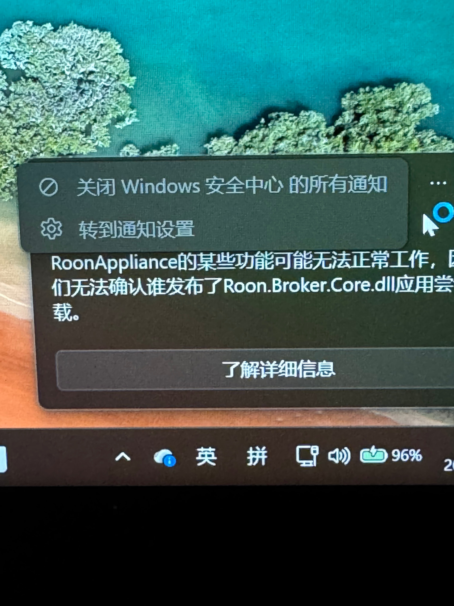

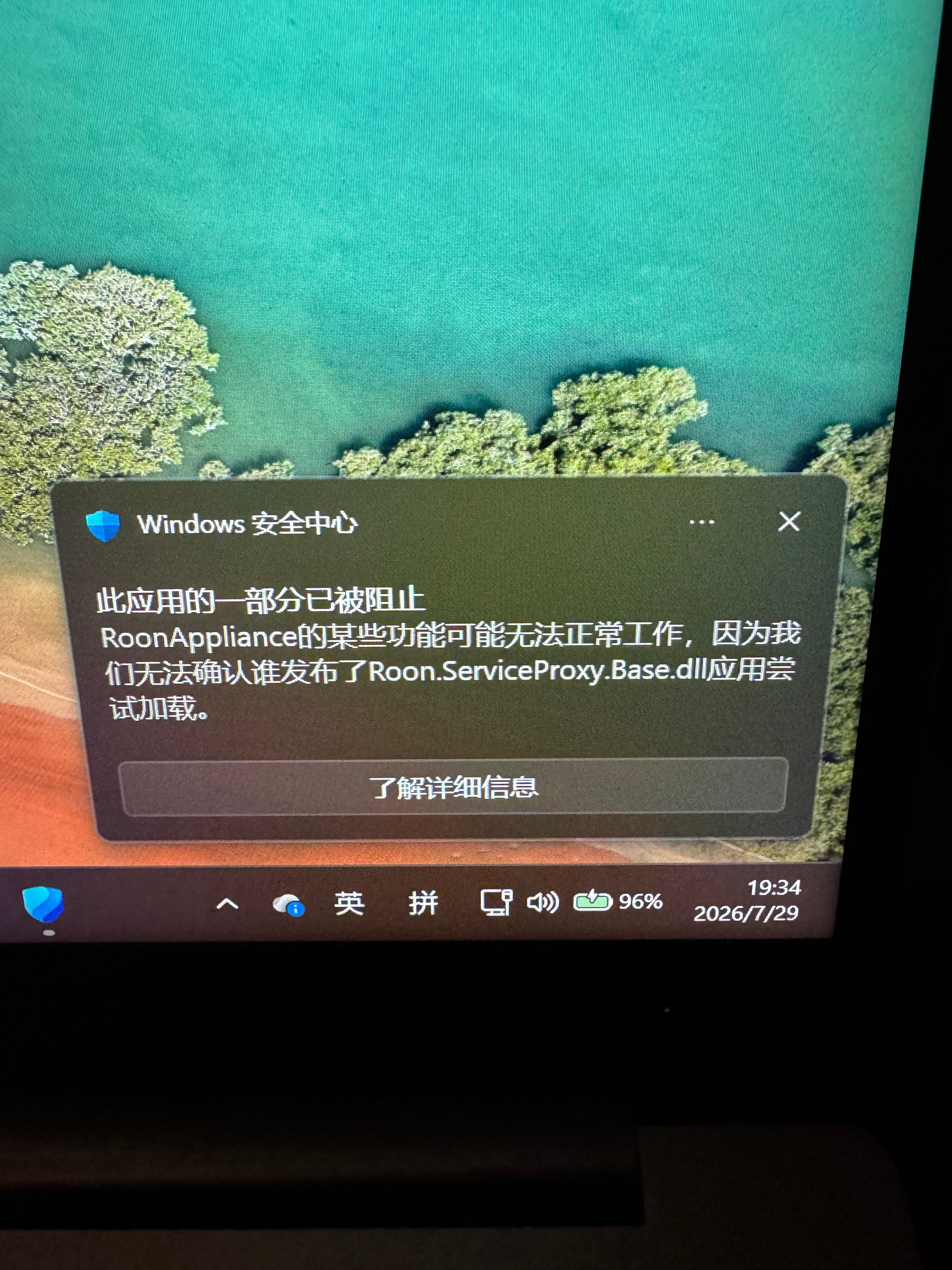

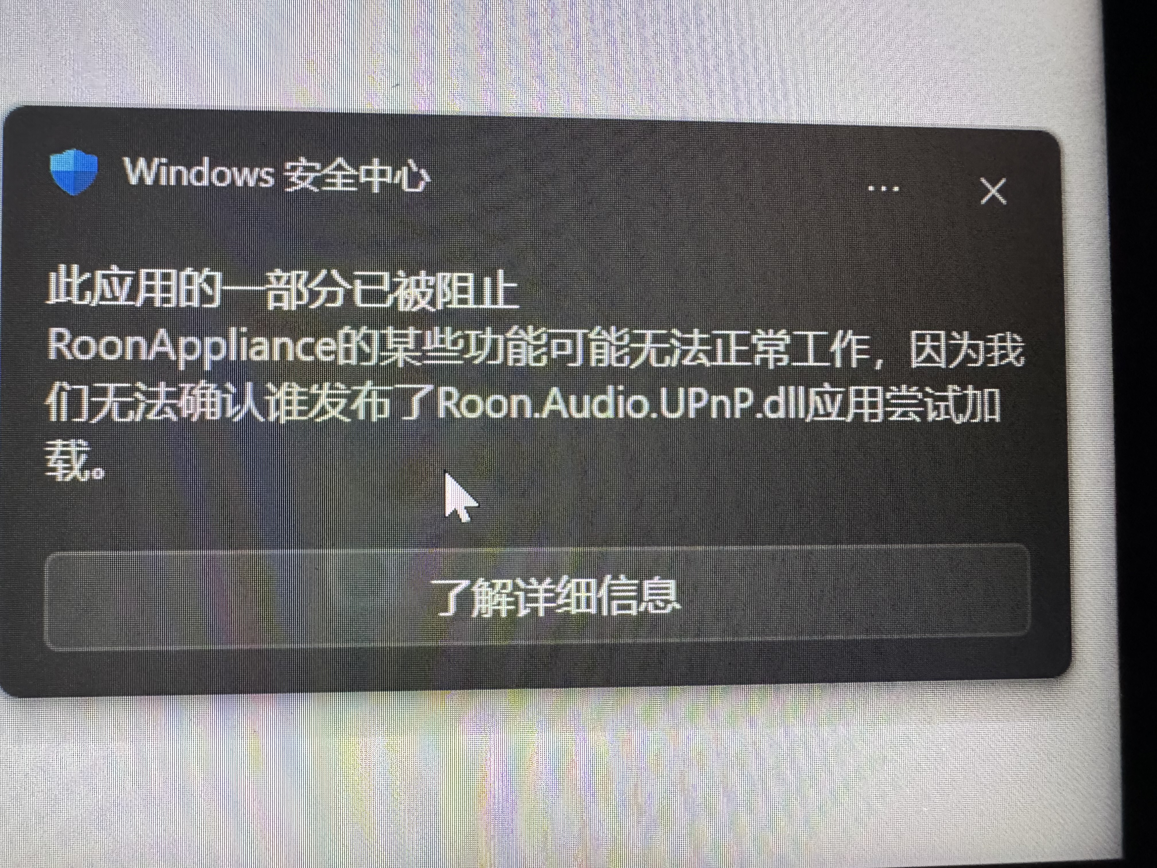

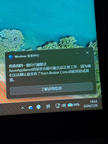

Roon已被Windows阻止,无法使用。重新安装Roon可以暂时解决此问题,但重新启动计算机会导致阻止重新出现。这种阻塞行为的发生有多个实例(3—4个类似的问题)。此外,Roon无法识别存储在客户硬盘驱动器上的DFF和ISO文件。在识别DFF文件的情况下,Roon报告不支持这些文件的播放。
网络方面没有问题,目前主要是Windows系统会阻止roon的几个文件运行,防火墙也关闭了,也无法恢复正常,只能重新安装后可以运行,但再次重启电脑后,还是那几个文件被Windows系统阻止运行。

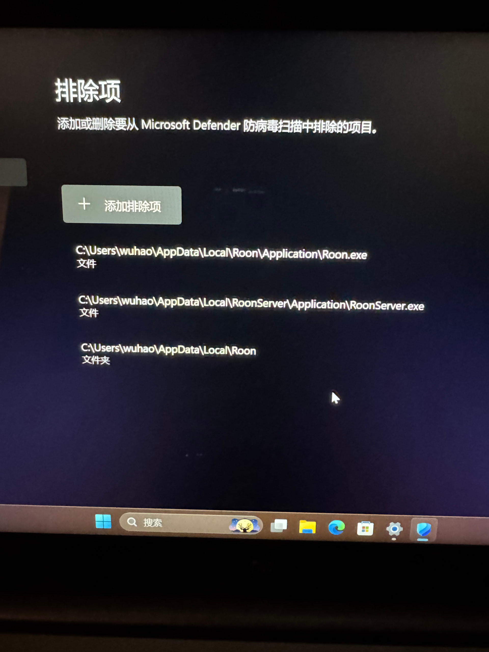

已经试了白名单,但还是被强行阻止,所以不知道该怎么办了。谢谢您。
Hi @859731836,
You can follow the instructions in this guide. There are a few background processes associated with Roon, namely RoonAppliance.exe, Roon.exe, and RAATServer.exe, that you’ll also need to whitelist.
Take this step in any third-party network security as well. Roon requires access to the loopback ethernet interface to communicate with your local drivers.
We’ll watch for your reply. Thank you!

尝试了,还是失败了,RoonAppliance.exe这个找不到,所以没法加入防火墙排除名单里。
Hi @859731836, thanks for the screenshots, they’re very helpful. Two things are going on here.
1. Why you can’t find RoonAppliance.exe
It isn’t a separate download, it lives inside the RoonServer folder. Rather than hunting for each .exe, the easiest fix is to exclude the whole folders. Your exclusion list currently has the Roon folder plus Roon.exe and RoonServer.exe, but it’s missing the RoonServer folder, which is where RoonAppliance.exe, RAATServer.exe, and the blocked .dll files actually sit.
Please add this folder as an exclusion:
C:\Users\wuhao\AppData\Local\RoonServer
To find RoonAppliance.exe directly, paste this into the File Explorer address bar and press Enter:
%localappdata%\RoonServer\Application
(AppData is a hidden folder, which is why it wasn’t showing up.)
2. The real cause of the block
The pop-ups say Windows “couldn’t verify who published Roon.Broker.Core.dll / Roon.ServiceProxy.Base.dll.” That message doesn’t come from the antivirus scanner, it comes from Smart App Control (Windows 11), which blocks files it can’t verify regardless of your Defender exclusions. That’s why whitelisting hasn’t worked.
Please check: Windows Security → App & browser control → Smart App Control.
  • If it shows On or Evaluation, that is what's blocking Roon Server.
  • Important: turning Smart App Control off is a one-way change, Windows won't let you turn it back on without resetting/reinstalling Windows, so decide carefully before doing so.
If Smart App Control is already Off, look just below it under Reputation-based protection → Check apps and files and try turning that off temporarily to confirm it's the culprit.
Suggested order:
  1. Add the RoonServer folder exclusion (above).
  2. Check Smart App Control / Reputation-based protection.
  3. Restart the PC and confirm whether the block reappears.
  4. If it still returns, do a clean reinstall of the latest Roon build — the unverified DLLs can be a sign of a partial/corrupted install.
Let us know what you find at step 2 (a screenshot of the Smart App Control screen would help). Thank you!
