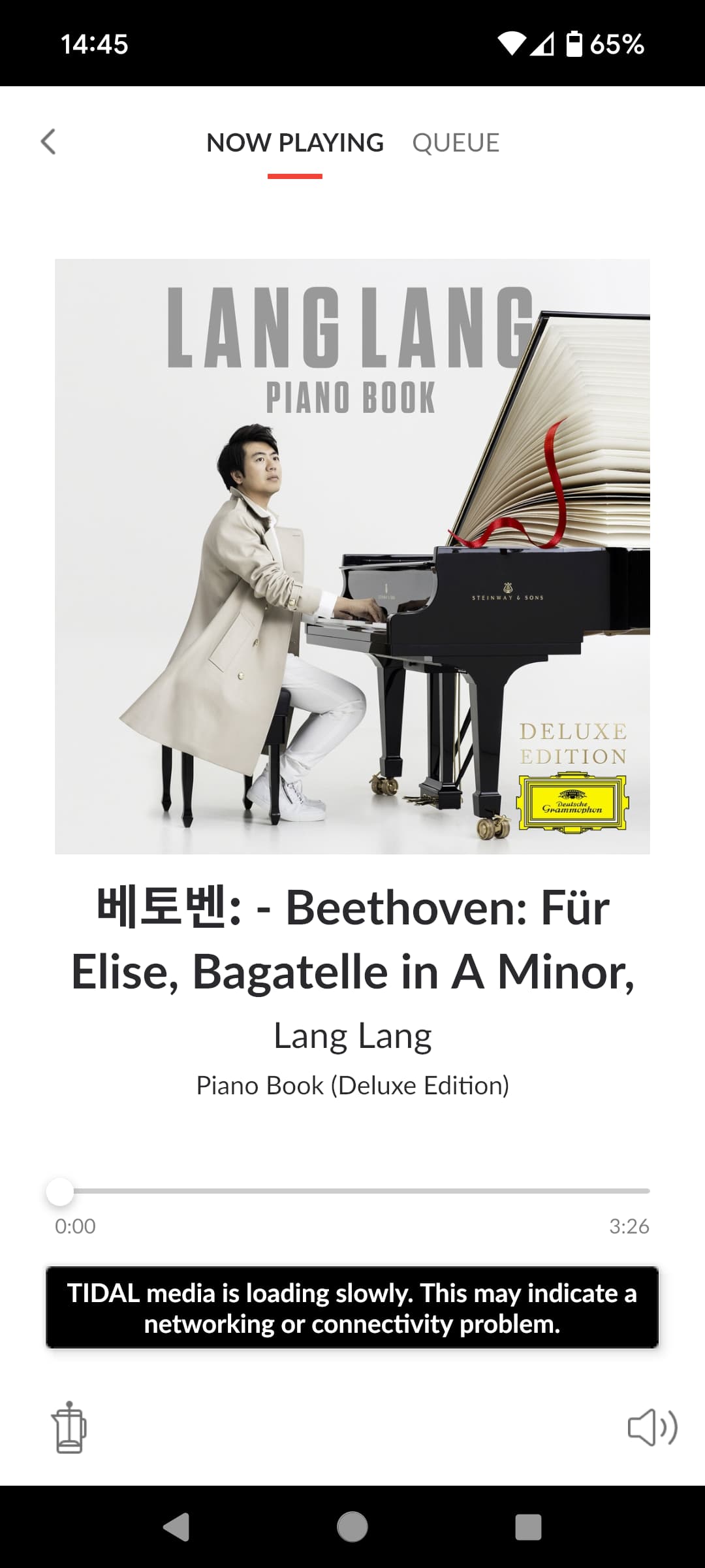

I have uploaded some screen shots that show my issues.
  1. Music stops suddenly (Tidal Media loading Slowly.png)

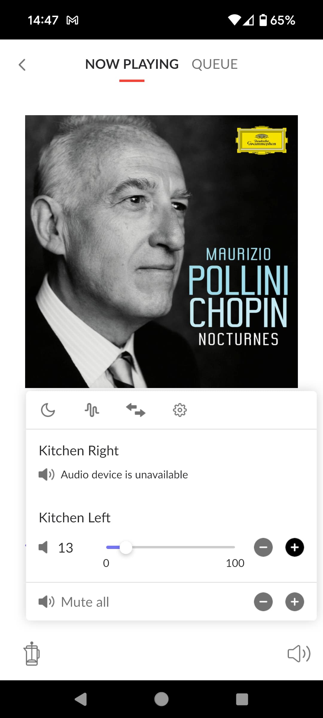

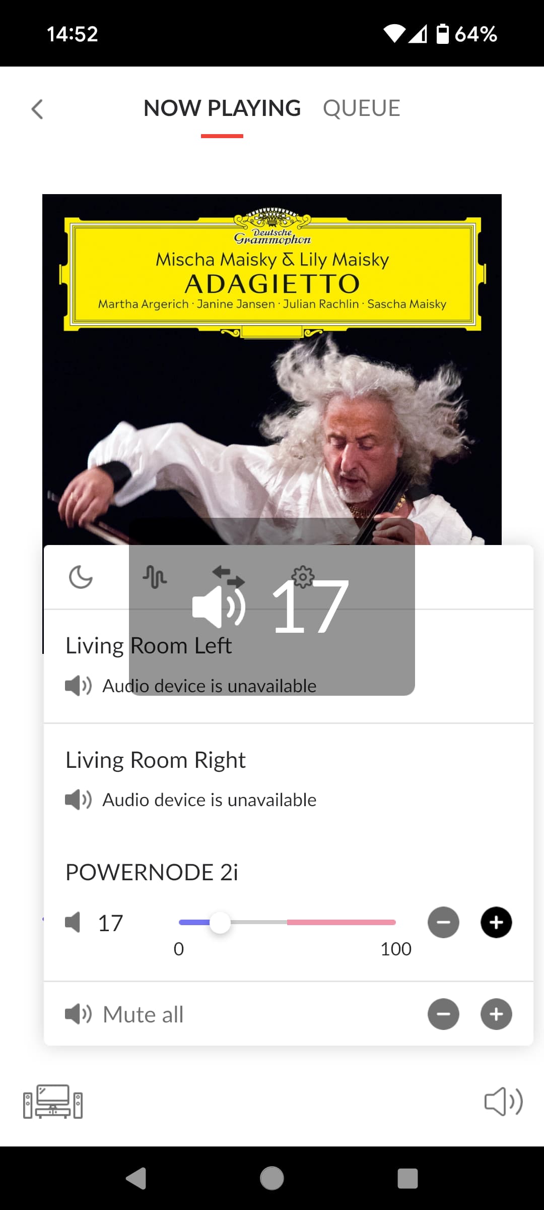

  2. Auio Device unavailable (from different groups). Note that I can hear the music in players.

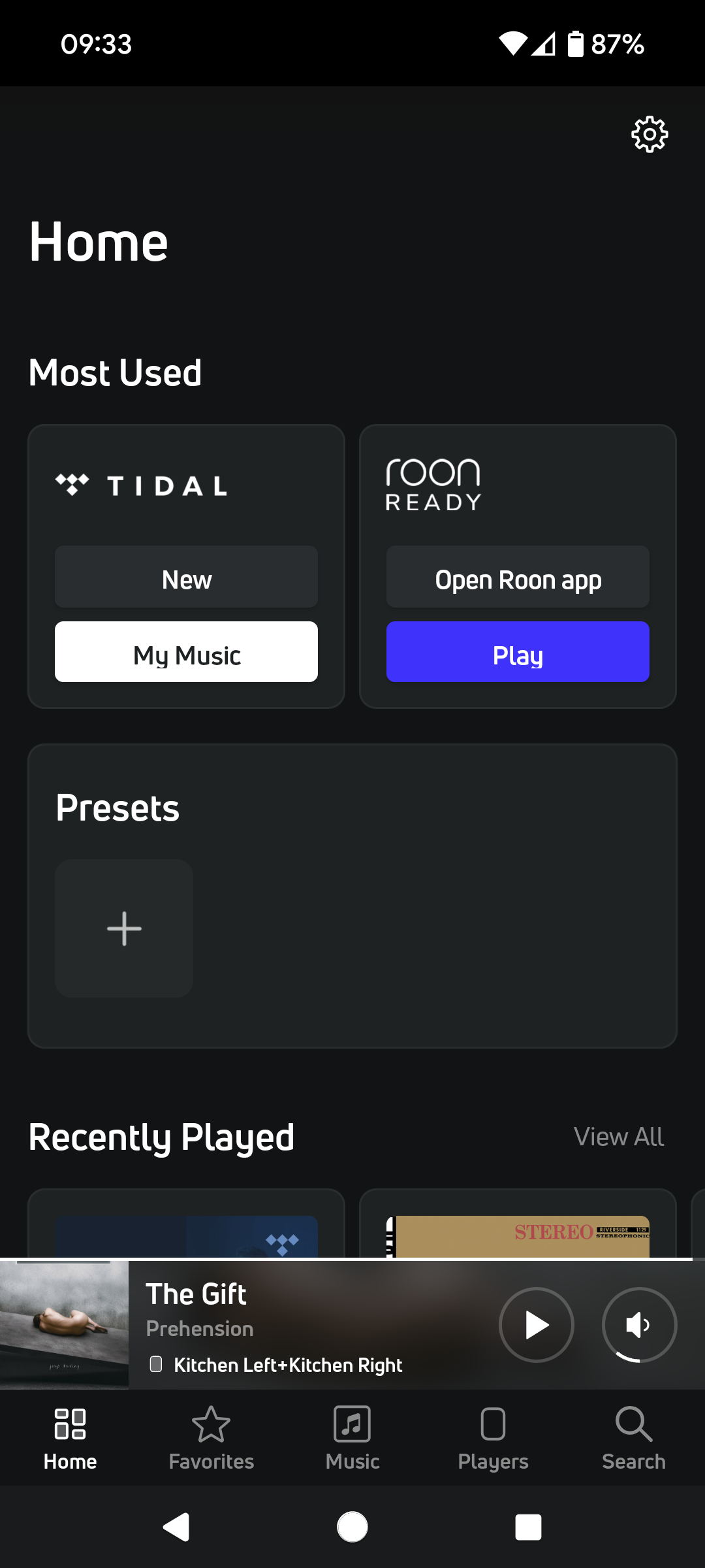

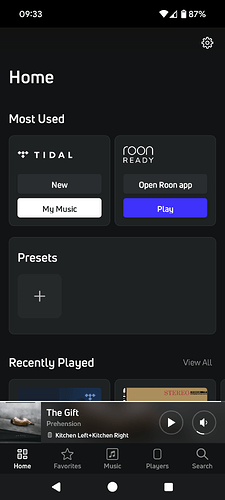

With my first trial I remember having problems with my BluOS when the Roon Icon appeared within the BluOS app. It is not present now, though. I would prefer to play all my music through Roon, not BluOS, for many reasons. However, should the Roon icon be present in the BluOS app?

Any news on my issue? I have noticed that when the Roon Ready icon appears within the BluOS app the music also stops when I play it with BluOS.

When I play in my Kitchen zone it says that the Kitchen left player is unavailable, the volume bar is not there. I can hear the music in the left though, but only if the right is on. The track is Blessed Feet - Tord Gustavsen Trio and the time is 14:49 CET.
The same happens with the Bedroom zone, this time the Bedroom Right is unavailable. And also with the Hometheather zone, here the Livingroom Left player is unavailable.

I changed zone with the same song playing until 14:52. So, I can’t manage the players individually.

What is more worysome is the second problem:
“When I play in my Kitchen zone it says that the Kitchen left player is unavailable, the volume bar is not there. I can hear the music in the left though, but only if the right is on. The track is Blessed Feet - Tord Gustavsen Trio and the time is 14:49 CET.
The same happens with the Bedroom zone, this time the Bedroom Right is unavailable. And also with the Hometheather zone, here the Livingroom Left player is unavailable.”
That means I can’t control one of the players individually.
Any ideas how to fix that?
