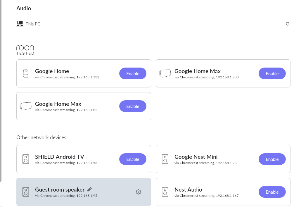

Roon Server runs on MiniPC, hardwired to the router (asus rt-ax86u pro). The affected Windows PC is also hardwired to the router (but I tried Wifi with the same problem)
Further Description
I've had device dropouts on this PC occasionally, but they were always resolved with a server reboot. Since 2.49 and 2.50, no audio device is showing on this PC at all, and no reboot of PC or Server helps.
I have reinstalled Roon on the PC, deactivated all other network devices, restarted the router, deactivated firewall, and nothing helped. All other PCs in the house connected to the same network work absolutely fine.
The RAATServer_log.txt finds the Audio devices:

But further down in the log I get several instances of ‘destroying client’
04/29 12:47:08 Trace: [jsonserver] [192.168.1.6:37654] accepted connection
04/29 12:47:08 Trace: [jsonserver] [192.168.1.6:37654] read error: connection reset by peer
04/29 12:47:08 Trace: [jsonserver] [192.168.1.6:37654] destroying client
04/29 12:47:08 Trace: [jsonserver] [192.168.1.6:37676] read error: connection reset by peer
04/29 12:47:08 Trace: [jsonserver] [192.168.1.6:37676] destroying client
04/29 12:47:08 Trace: [jsonserver] [192.168.1.6:37666] read error: connection reset by peer
04/29 12:47:08 Trace: [jsonserver] [192.168.1.6:37666] destroying client
This looks similar to this thread, but now even a server/PC reboot does not help anymore.
