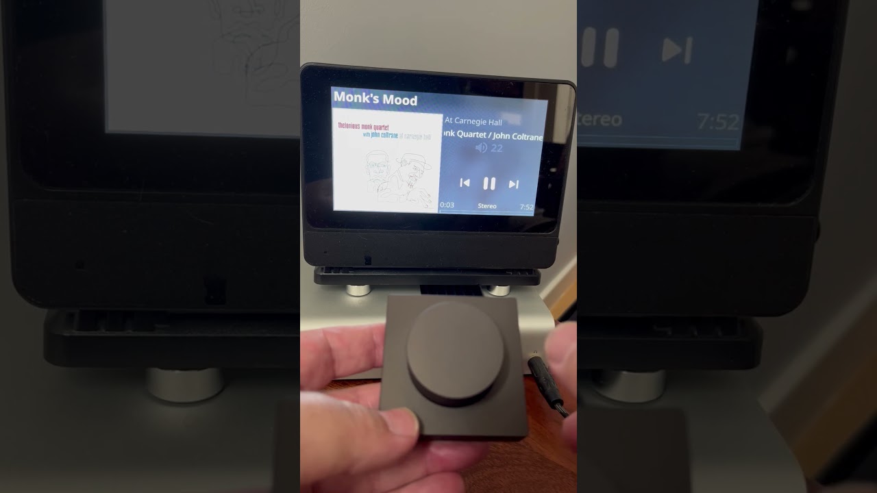

The setup in Ropieee was the same as any other USB HID controller, I just plugged the dongle into the Pi and it showed up as a “Generic USB HID” in the Remote tab.
The volume up/down and mute functions worked right out of the box, but I had to download the software onto my laptop and connect the dial with a USB cable to reprogram it and get all 5 functions as I wanted. The manufacture’s YouTube video below shows the process with the software in Chinese and it is a bit confusing, but the software I got was in English and the process fairly straight forward. The 5 functions I mapped are now what the dial does with every device I connect it to, my computer, phone and of course my Ropieee Pi!
Here is a link to a video of the VK-01 controlling Roon through Ropieee:
With the work you did last year to add the USB HID feature and this cheap device I think we have all the functionality of the rooDial with a lot less complexity and cost!
