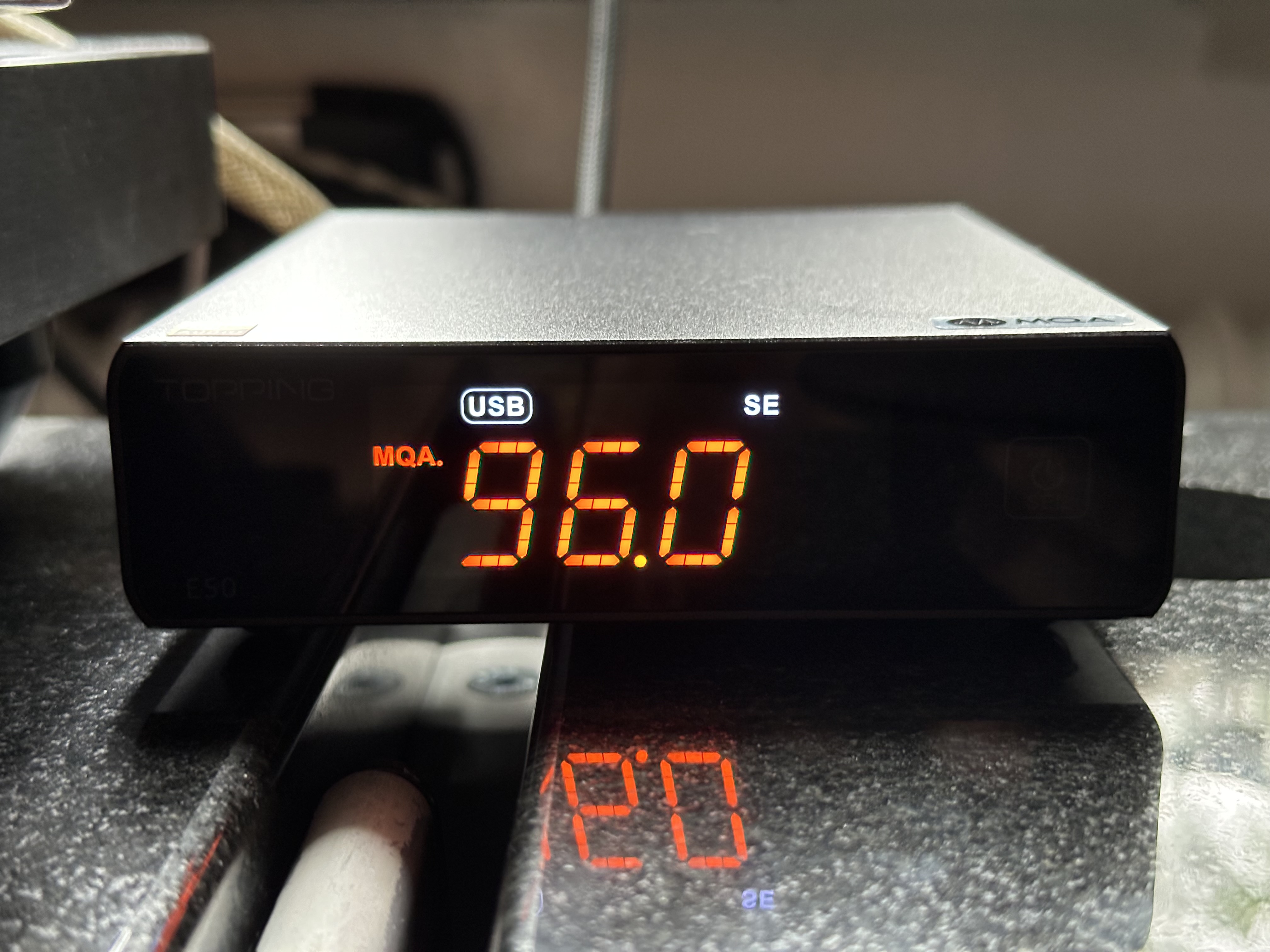

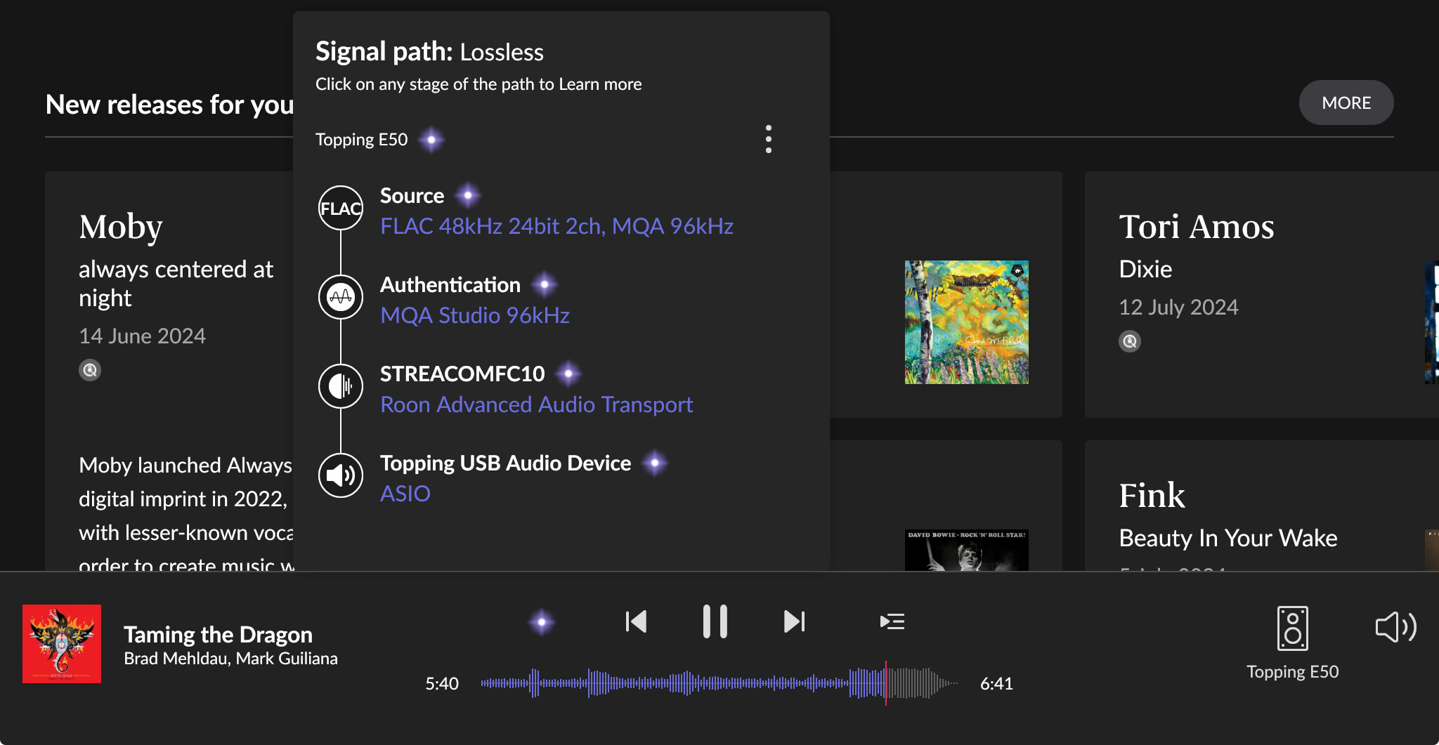

It seems right, but is there a proper reason for this?

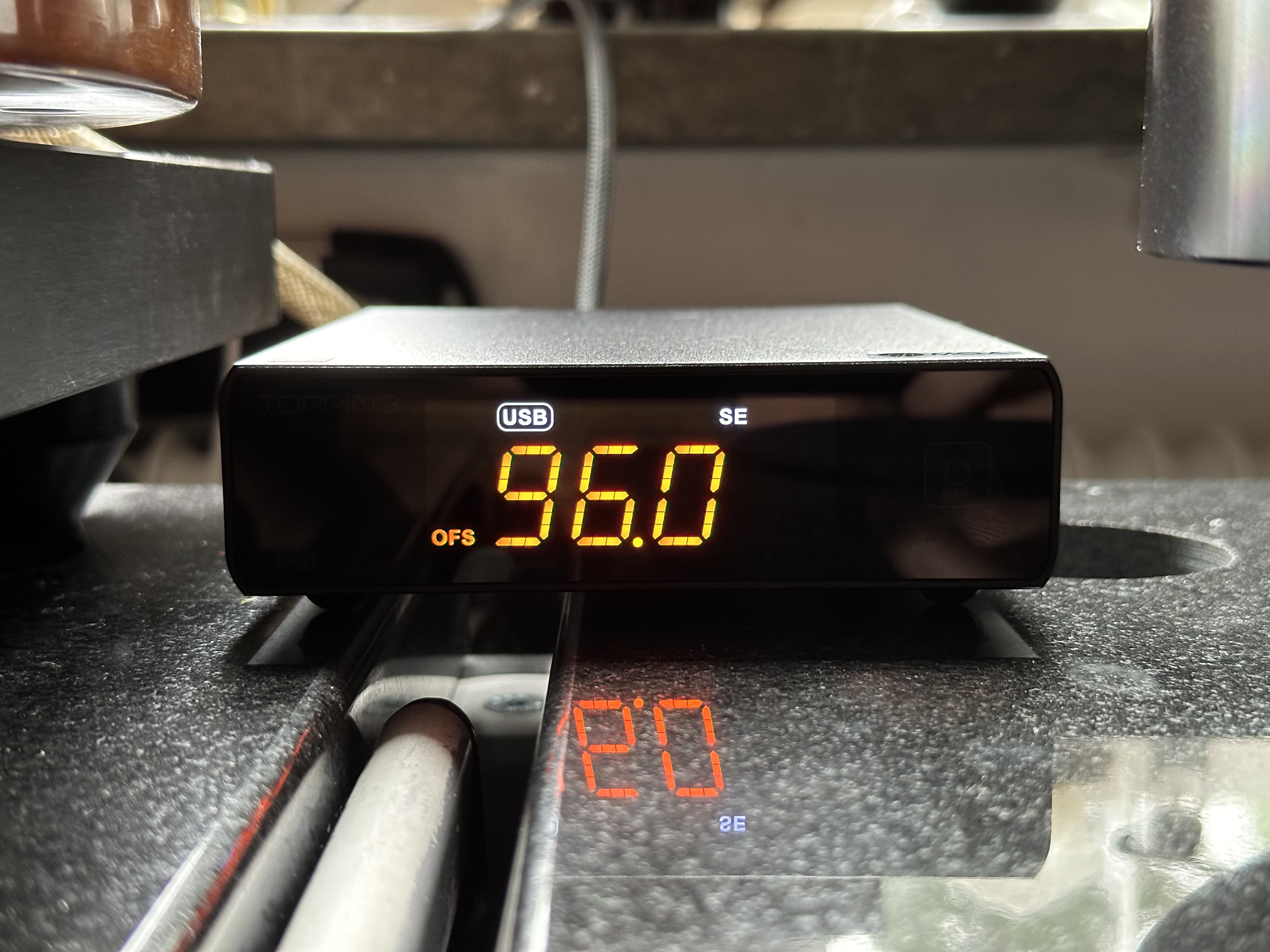

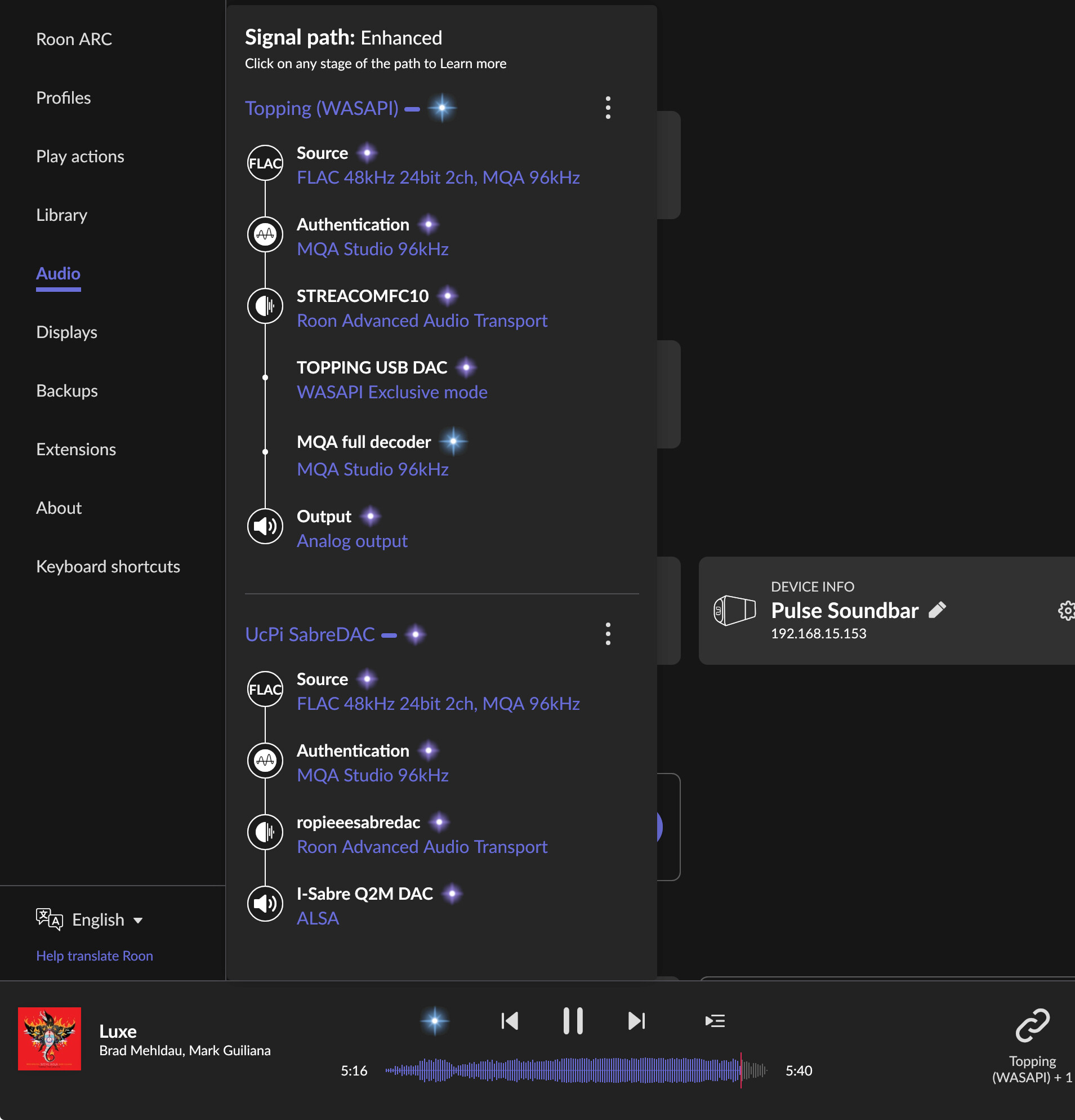

When grouped, with another Zone, it seems the MQA capable DAC get the renderer treatment from Roon.
Here it plays as a single Zone, MQA Decode and Render works as intended.
And when grouped with a non MQA-compliant endpoint:
I’m just curious if this is a Roon behaviour or something other software/hardware handles differently?

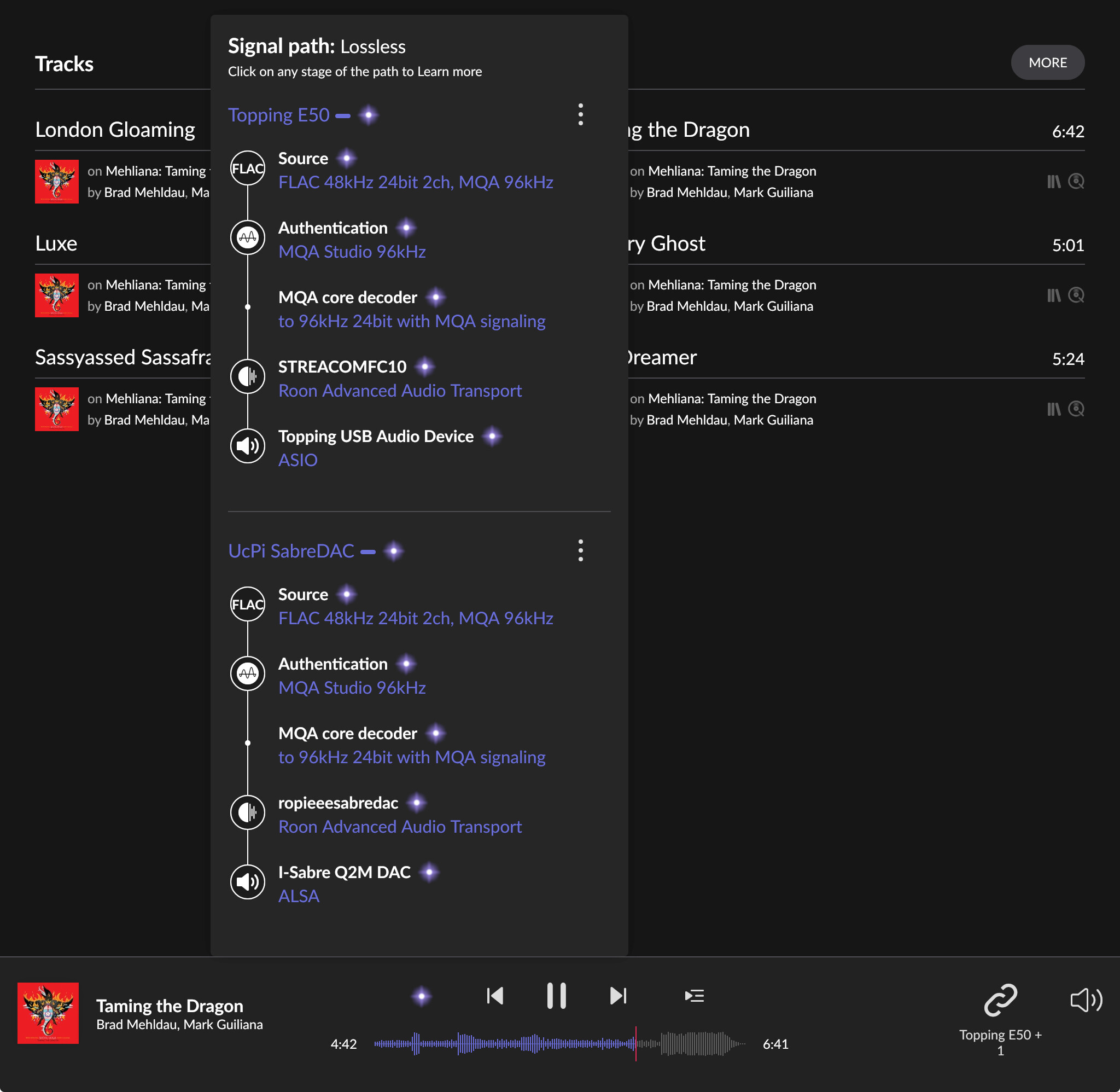

Edit: If i turn off “Roon MQA Core Decoder” for the non-MQA device the Topping does the full Decode, and the other DAC gets served unprocessed material:
