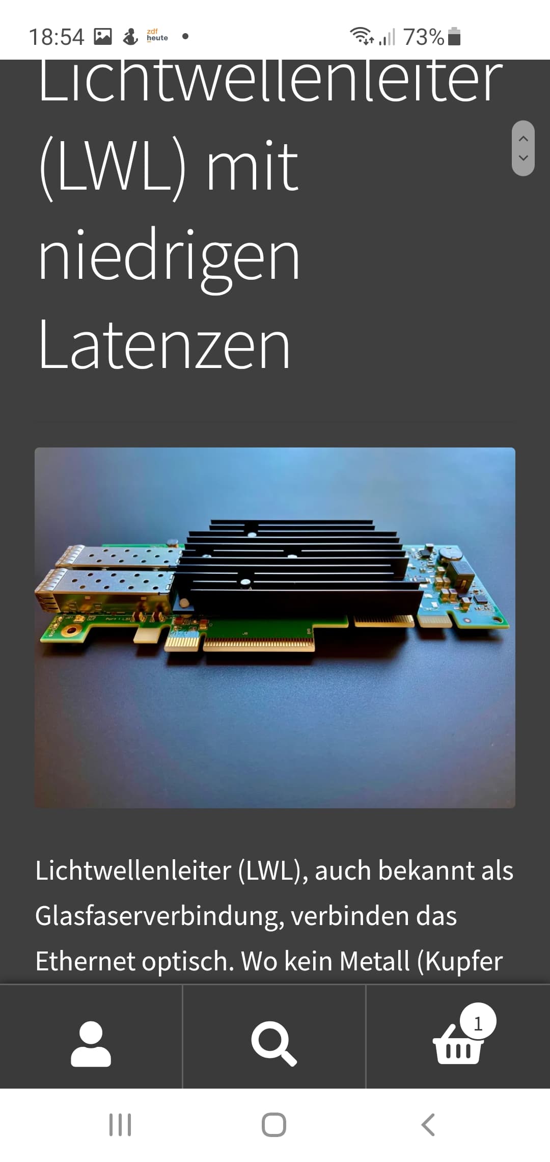

XILINX Solarflare Flareon Ultra SFN8522 – LW
would this network, fiber optic card work under Roon / Rock, i.e. under Linux, without having to install a driver?
Thank you very much .

I can’t speak to Linux in general, but if it requires a custom driver, it won’t work on ROCK.
Looking at these docs, it looks like it needs a lot of custom drivers and maybe an entire Dataplane subsystem in Linux, but I have zero familiarity with this thing.
Thank you for answer
is it even possible to subsequently integrate or install a driver in the system under Roon / Rock, i.e. under Linux?
Didn’t roon claim that all USB cards or LAN cards would be recognized automatically?
Not under ROCK. You need to install your own Linux, get the card working, then install server.
Your other option, and probably the path I’d take…
Get the card working in a hypervisor (I use Proxmox VE) and then ROCK in a VM. The hypervisor will present a standard network interface to ROCK at that point. ROCK won’t need to know anything special about the physical hardware. You’re well into a tinkering / MOCK build at this point though.

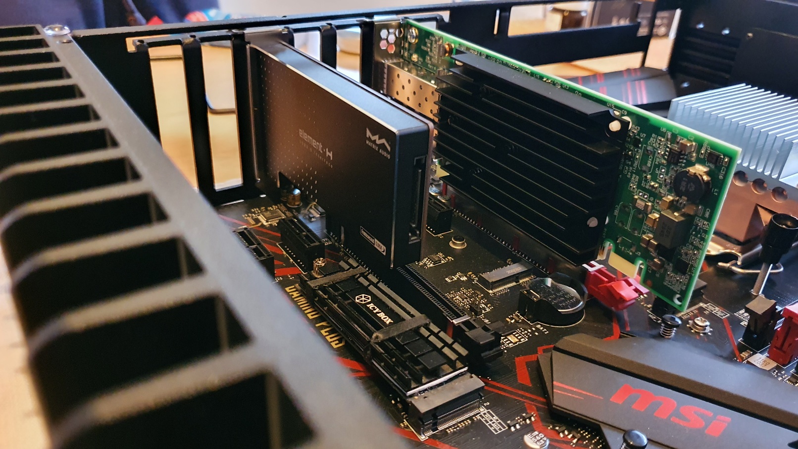

I will try another card, for example 10Gtek® 10GbE PCIE Netzwerkkarte for Intel X520-DA1-82599EN Chip.
It will work.
My Matrix Element H USB card works too.
Enjoy your music…
