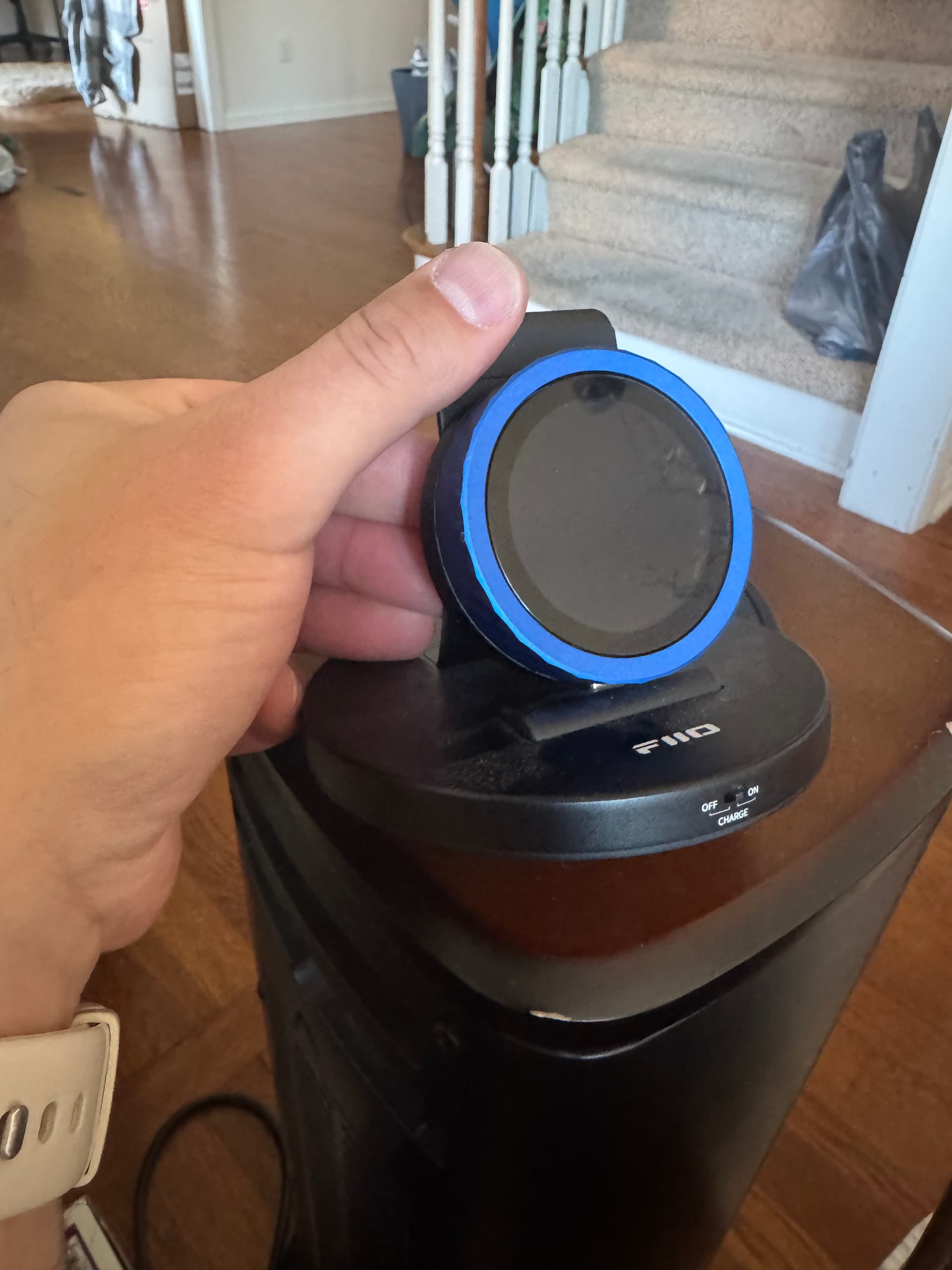

Another hobby of mine is… 3D printing and electronics wiring. I’ve made some cables and a charging only USB-C with an 3D printed enclosure would be so fun to work on.
What do you have in mind?
This FiiO stand would work though overkill for just charging: it’s meant as a phone → DAC stand.
