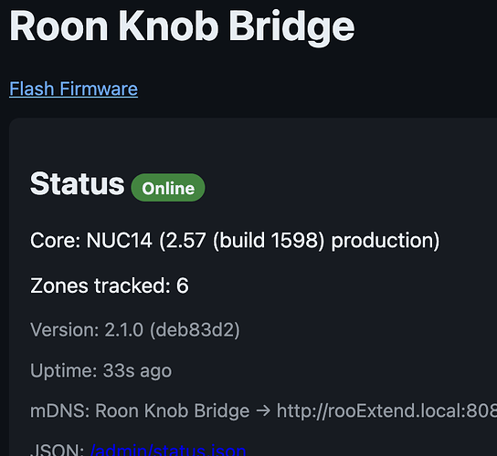

I updated the bridge, but how can I see the actual version of the bridge? In the GUI, I see still “Version: 0.1.0 (unknown)”, so this is not implemented (not an issue for me). Is there a command to see the real version of the bridge? I thought I would see the version in ”docker compose ps”, but the info of the image tells “muness/roon-extension-knob:latest” and that before and after the upgrade. So this output is not the reliable to check the version.
I also tried to do an update of the knob via selecting the zone and going to Settings", than “check for update”. Then I see “checking …” appearing, but it is not going out of that state. So this is not working. How must the knob be updated, or checked it is on the latest version?

Fixed now, thanks for the bug report!
2.1.0:
  • Show correct version and git_sha in admin interface
  • Hide settings panel when update notification appears (so you can actually see it update!
  • Show bridge URL and discovery method in settings
