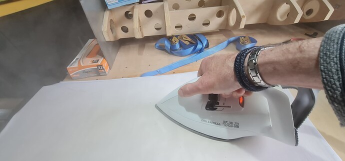

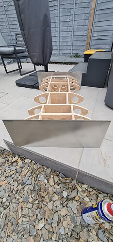

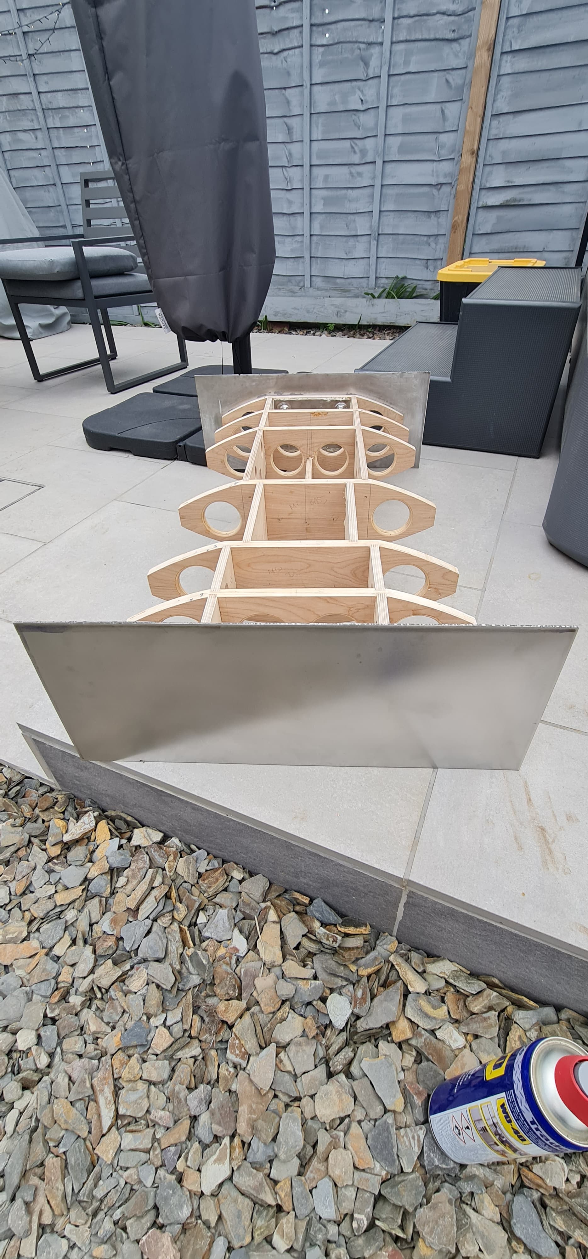

I’ll have to tidy it up first. I’m mid way through a speaker build at the moment, so it’s standing room only in there right now!
A version of Troels Gravesen’s Poor Man’s Strad utilising curved cabinetry, constrained layer damping, a 3k 2/2 carbon fibre wrap, 304 stainless top and bottom panels and a 304 stainless plinth.
A few pics of the build below. I’ll get around to a proper build thread soon.
A few more:
That’s cool! Looks like an audiophile hamster house…
Wow. My woodworking projects just involve right angles only. I see that you have a track saw, which I have heard is all the rage - need to get one for sheet material. Will be curious to see how they turn out, and what other neat features you can reveal from the mancave!
The curves were easy. I worked out the radius needed and made up a jig. A bit of ply screwed to the router base, with a hole for the cutter and a pin made from a 3.2 mm (1/8") drill bit to anchor it to the base ply. Routed out a template for the horizontal braces and then used that to make 14 of them with a bearing-guided template router bit. The big circles were cut with a circle jig, the small ones with a forstner bit in the drill press. The curved panels are kerf bent birch plywood. Cut enough kerf slots in a sheet of ply and you can bend it into any shape! A bit of steam can help to persuade it!
The track saw has been one of my most heavily used tools ever. I don’t have the space for a panel saw, so the track saw is ideal for working with large sheets. I have a router adapter for the tracks too. Used both extensively during the fitted wardrobe build in our bedroom.
