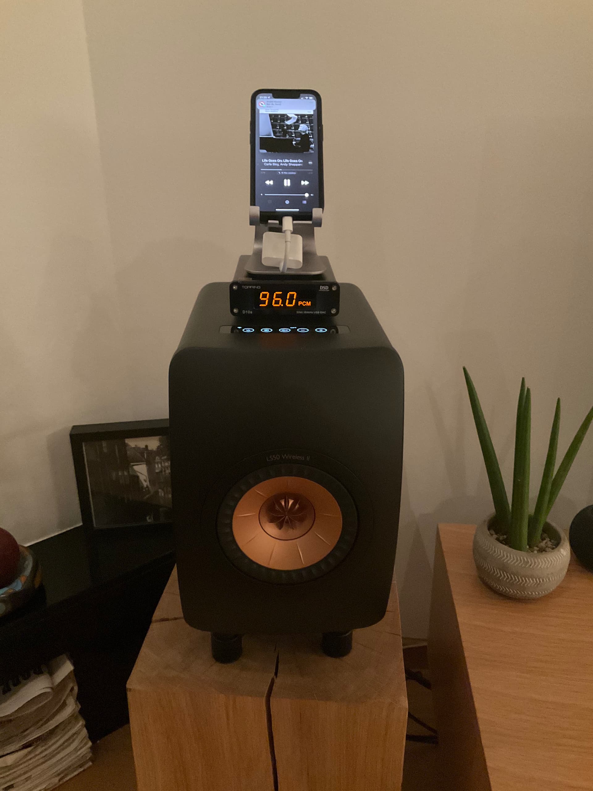

Nothing that hasn’t been proven yet – but the D10s just came in and nicely does autoswitching, lossless and highres from Apple Music. It’s currently a bridge to the KEF:
iDevice > Lightning tot USB adapter > USB > Topping D10s > optical or coax > KEF LS50 WII.
Sounds great, but having to lift my lazy ass from the couch whenever I want to switch music is getting old quickly. It’ll make a nice toy for the Home Office though, where there’s a pair of LSX idly waiting… :smiley:

Nice KEFS, but since they’re active, why pump the output of your excellent Topping DAC into the aux of a set of active speakers with digital crossover? – i.e. it’s going to be bunging the analogue line level output which came out of your Topping through an internal ADC inside the speaker, doing the DSP crossover and then running that through its internal DACs (one per driver?) before amping it.
Wouldn’t you be (probably marginally but more logically) better off just feeding the USB out of your iPhone into a USB to SPDIF/Toslink converter and thence into the LS50II’s Toslink input?
Or am I missing something?
I use one of these to get music out of my desktop linux box into my RME ADI-2’s SPDIF input – The RME’s USB input is permanently connected to USB out of a Roon Endpoint.
Works well.
Oh… just realised you can probably use that Topping model as a digital passthrough IIRC and you’re taking Toslink out the back and just using the Topping as a format converter / sample rate display! So you’re all good. Please ignore my essay on how to suck eggs! :smiley:

I use that Topping when I want to feed my Naim Uniti Atom Headphone Edition with Apple Music via my iPad. The Naim doesn’t have a USB input so the Topping serves as a handy digital output pass-through converter into Optical which goes into the Naim.
