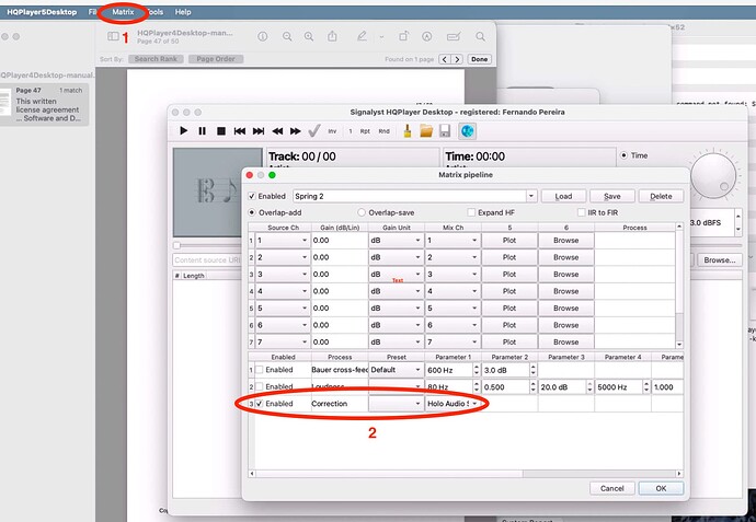

  2. How do you load DAC corrections? Nothing in the manual and there’s just a list on the website

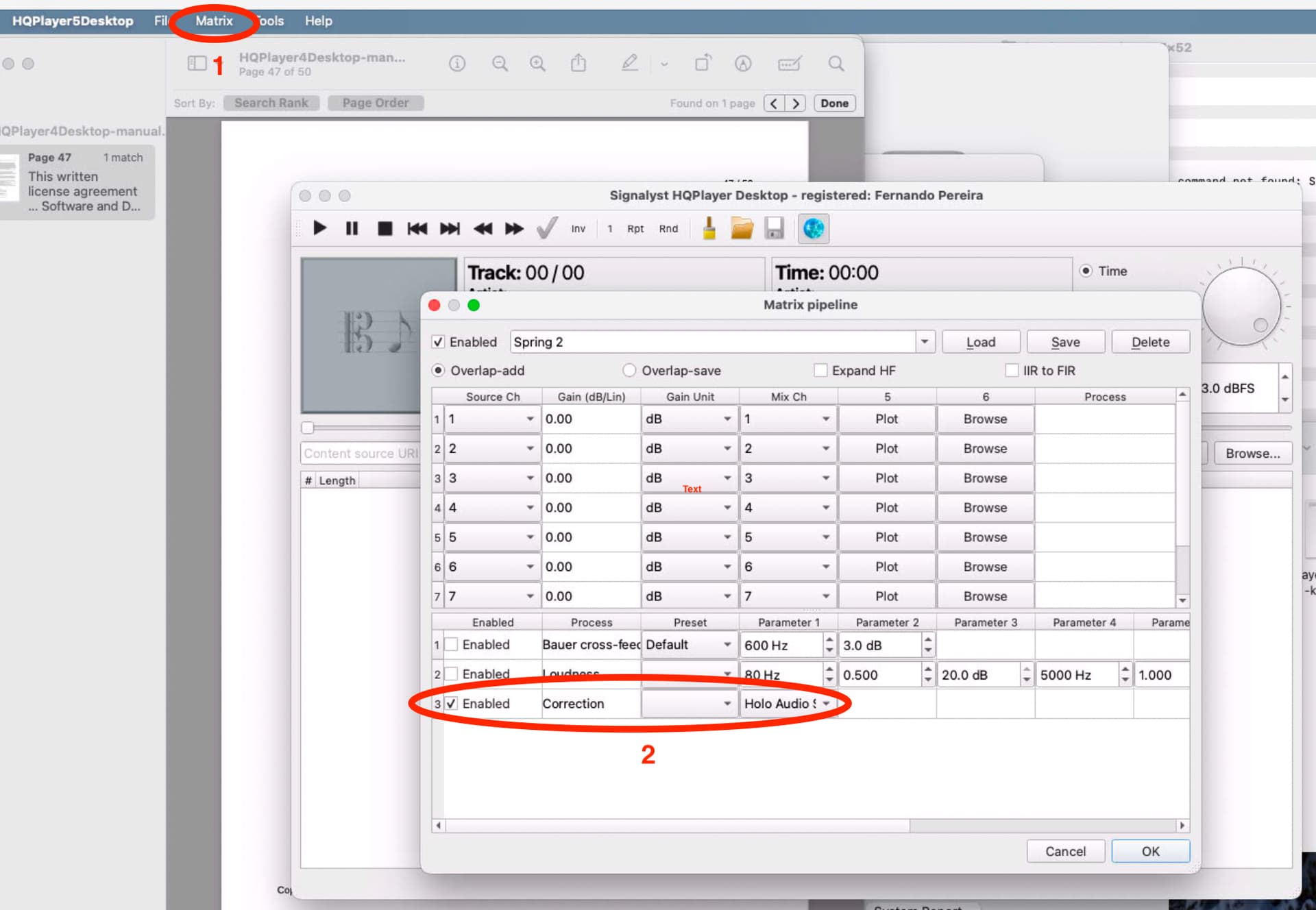

When potentially compatible DAC is detected, it appears under matrix configuration in HQPlayer. There’s the correction post-processing plugin, and there you can select the correct DAC. To enable the correction you need to enable both the matrix processor overall and the DAC correction plugin as well.
Many thanks. I found an online reference to the fact that Correction pops up only when your DAC is identified.
I enabled the DAC plugin, but don’t understand about enabling the matrix processor overall. Is there something else to press? Can’t see anything in the manual about it.
I’m using an R2R DAC (Holo May), everything is going to DSD256.
Many thanks for that. Hi, enable the correction as you indicated at 2. what your screenshot shows is that you have to give the profile a name and enable it, which I didn’t do.
The manual seems to be very good from a technical perspective, but perhaps could do with a five page guide for dummies on how you get the thing up and running and why you might want to change certain settings, with details of the setting options remaining in the detailed manual. It’s a difficult thing to do and most people either don’t bother or fail.
Remember the “Enabled” check box near top left corner of the matrix dialog…
That’s what I didn’t do !!!
