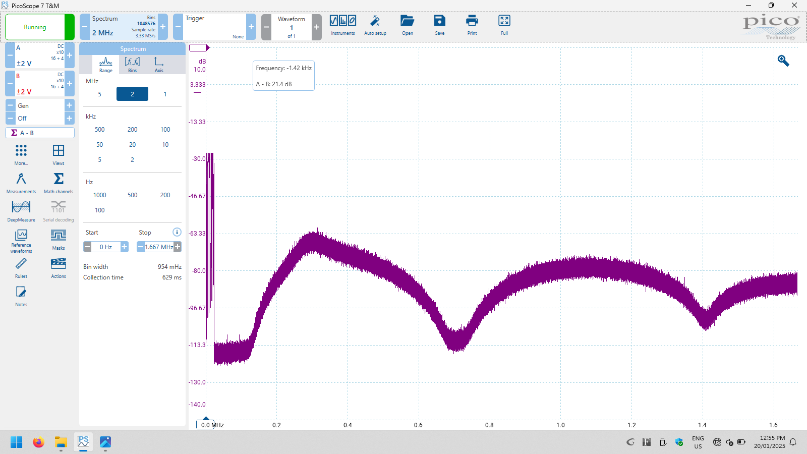

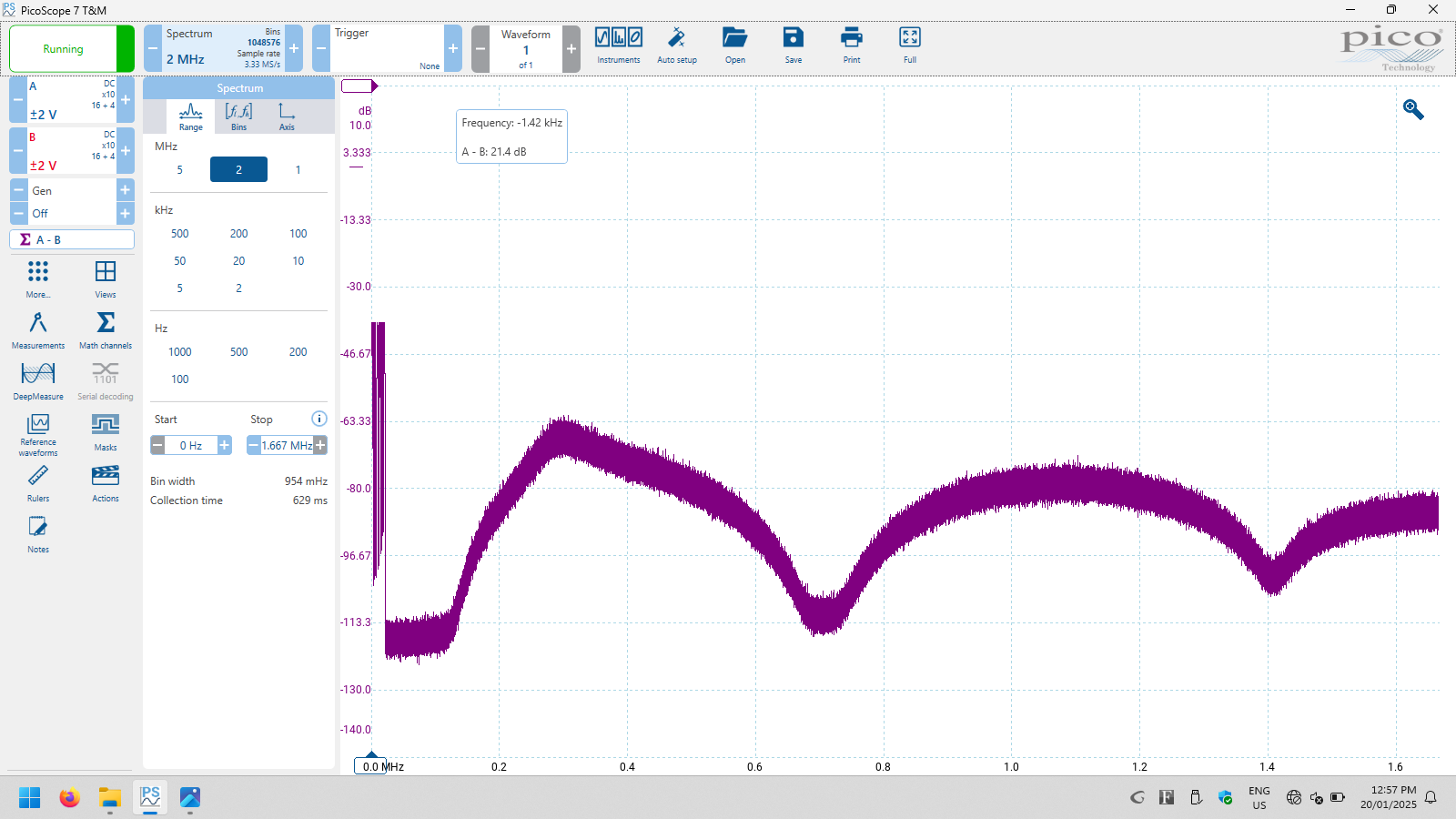

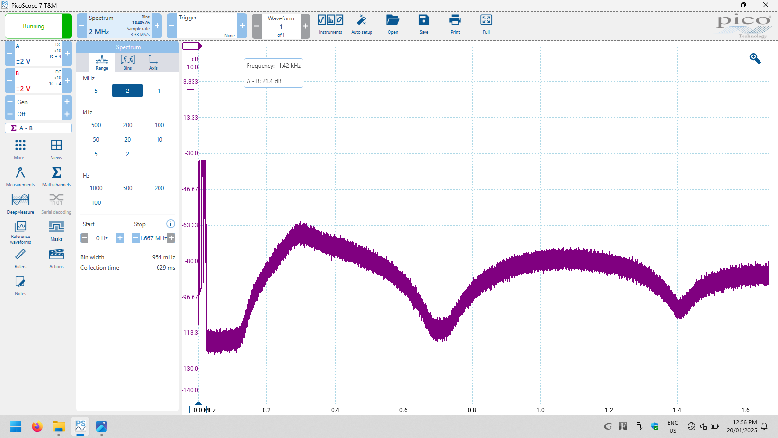

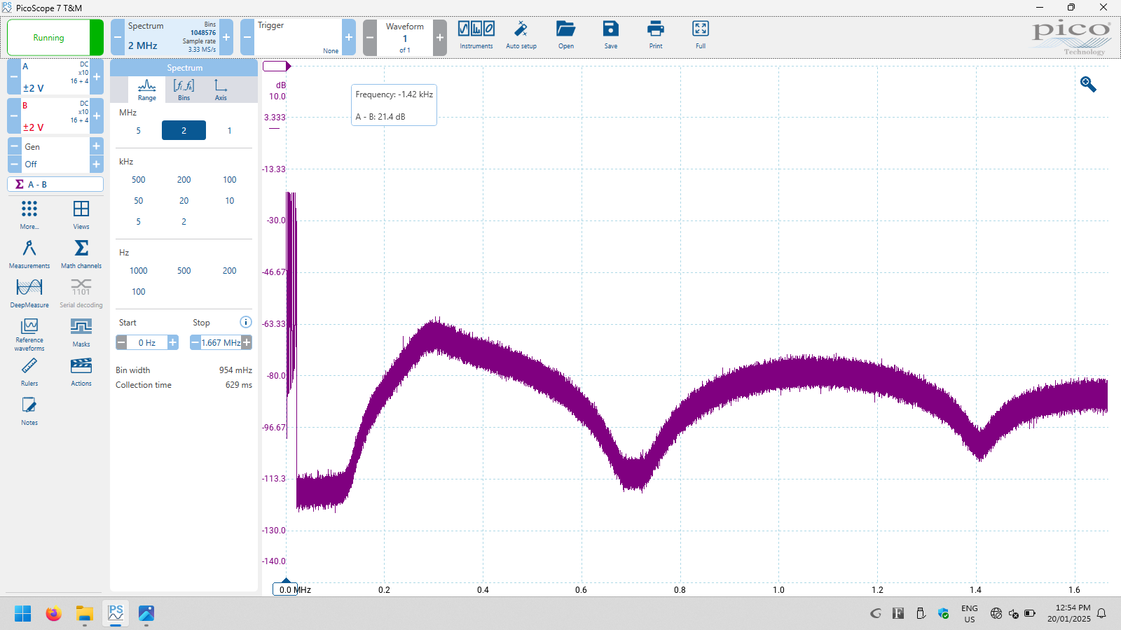

With my Gustard/Audalytic AH90 one measurement I didn’t do previously was to see run my linear sweep test files created in REW: 0dBFS, -6dBFS, -12dBFS, -18dBFS, -24dBFS etc input signals.
Since I have the same Picoscope, I can see what Jussi has been saying for over a decade, in action for myself.
You can see that as the input signal reduces from 0dBFS to -24dBFS there is no change in the fixed noise humps.
With my very sensitive IEMs, I hear no hiss going all the way down to -80dBFS input signal. So no worries!
In short, as music signals change in levels you don’t get any noise modulation ! No noise floor modulation. Its just a fixed noise that doesn’t change with music signals (hence its called un-correlated noise).
Fixed noise is significantly less problematic than modulating noise floor, assuming you don’t hear any hiss

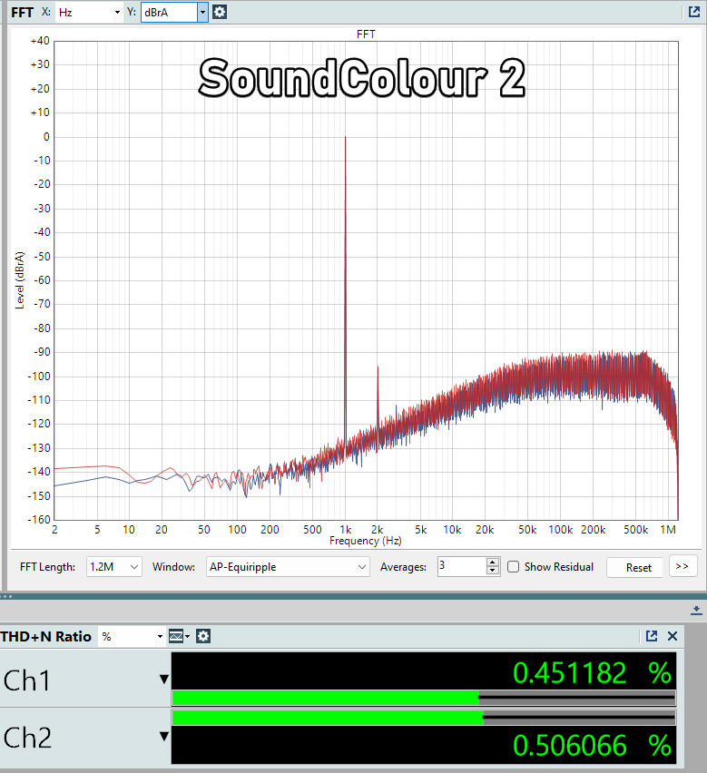

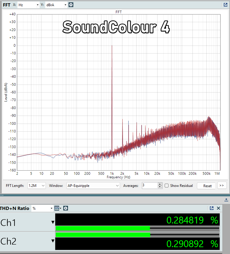

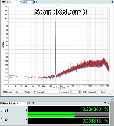

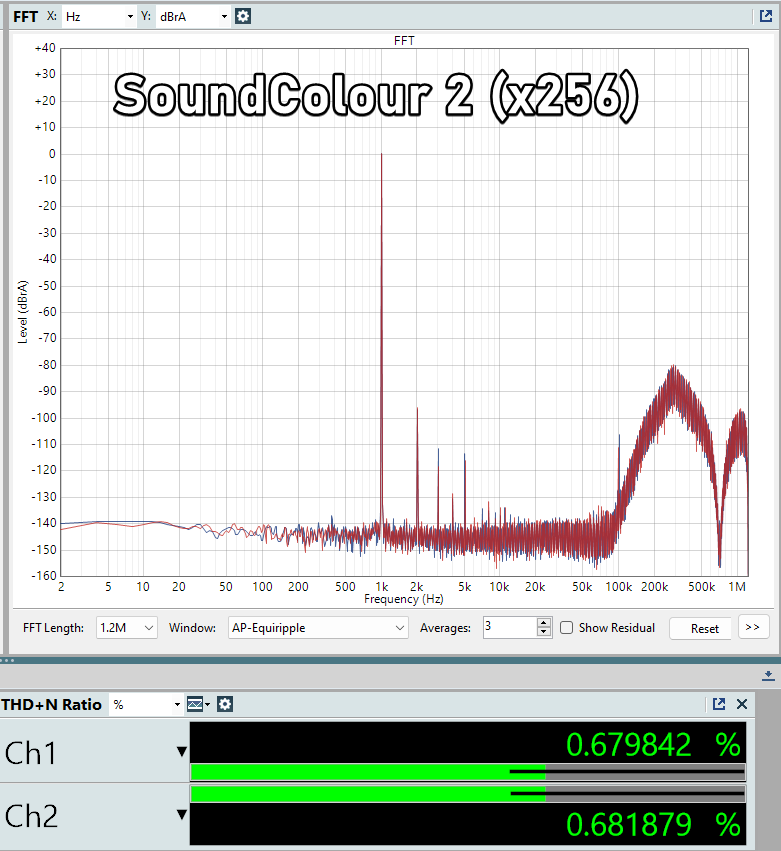

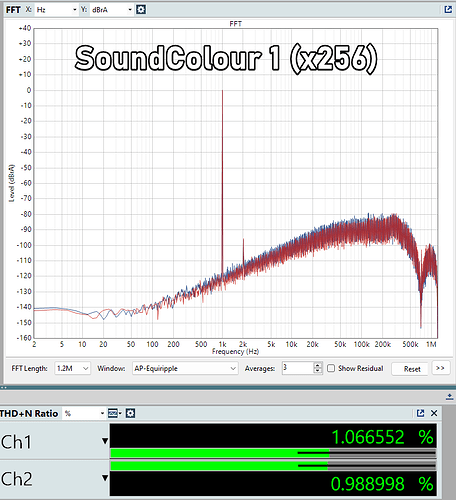

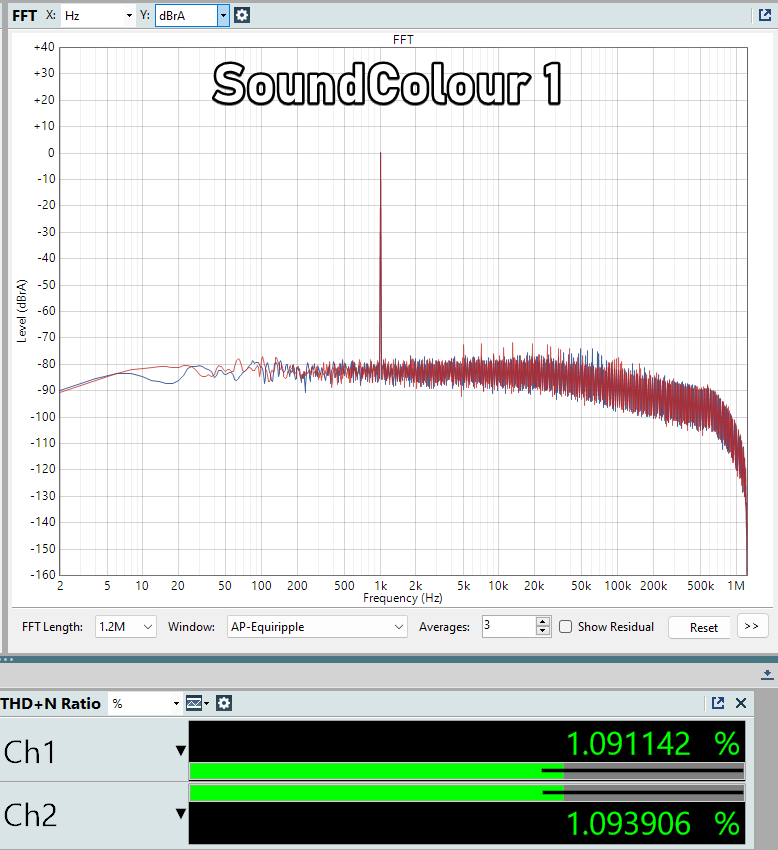

I’d be curious to know if you encounter the same issue I’ve been getting. I have the RAW-DAC1 and RAW-PRO-DAC here currently.

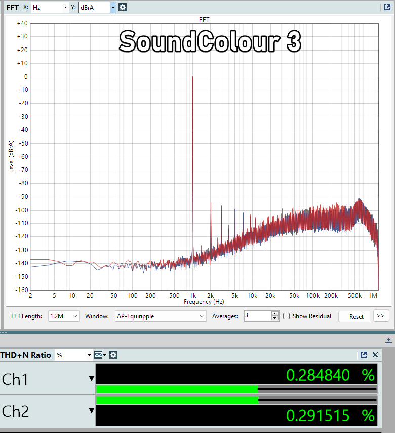

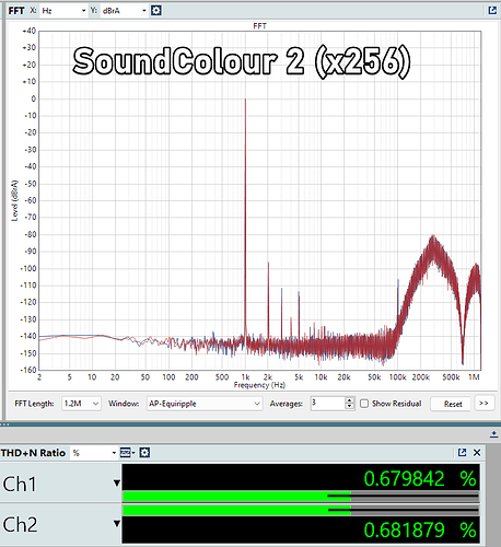

On the RAW-DAC1 (the AKM one), on DSD512 all the time, and on DSD256 about 90% of the time, either one or both channels shows massively higher noise throughout the audible band.
These are at DSD512 for example, and the behaviour changes depending on the ‘Soundcolor’ setting for the DAC:

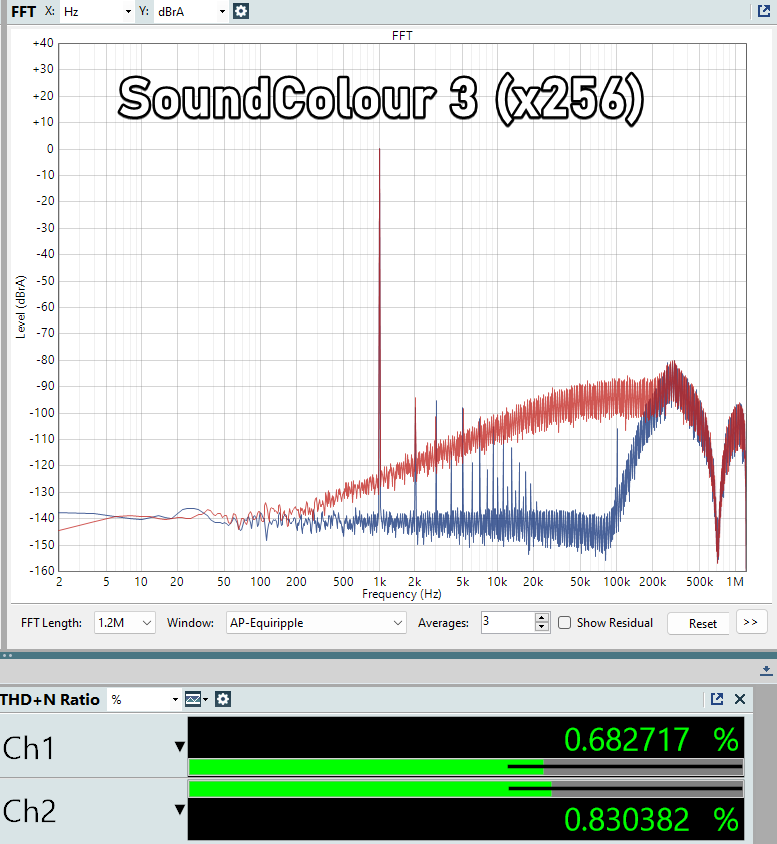

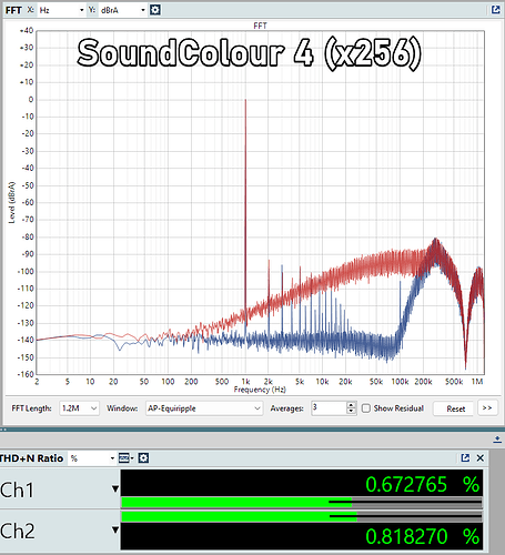

At 256 I can sort of sometimes get it to work on soundcolor 2, and one channel is fixed but not the other for the three other settings:
I did let SMSL know about this but it seems that they can’t replicate the issue, they said they’re seeing everything working fine:
I know @jussi_laako has mentioned he’s had trouble with SMSL/Topping DACs before, not sure if this is a similar issue to one you may have come across before?
I’ve tried various different USB sources to no avail, and the ESS variant doesn’t have the same issue at all so I’m not sure if this is just a dud unit or a wider issue.
PCM playback is totally fine

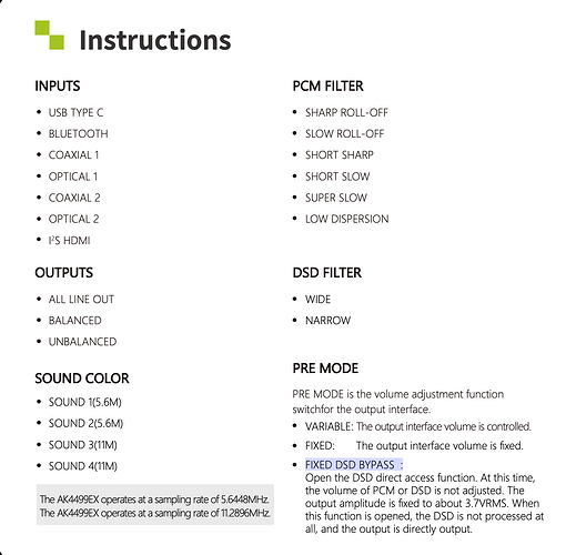

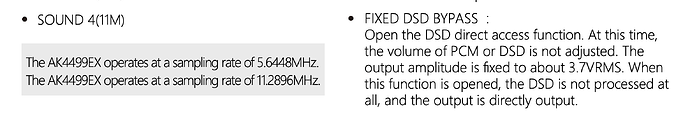

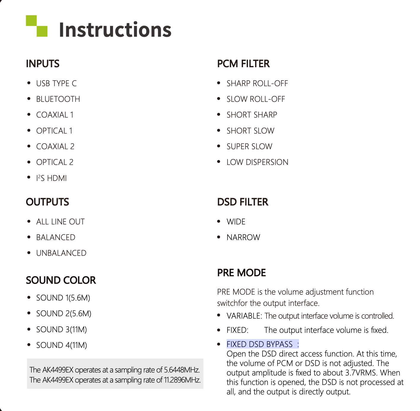

I wouldn’t bother measuring AK4499EX at DSD512 when the SMSL user manual and AKM data sheet (and Jussi has mentioned numerous times) states (see gray box):
If you see my AH90 measurements above in the thread (also AK4499EX) you will see I didn’t bother doing DSD512 measurements, since the above screenshot is well known. Waste of time.

I can do, but it’s hard to get too much useful info due to the dominating noise issue shown above (which also happens at 256x. The 2nd set of graphs is all x256)
@GoldenSound Your noise issues are at DSD512 (expected) and DSD256 with non-DSD direct mode
Those Sound Colour profiles are only in effect in non-DSDD
Can you try DSD Direct and share those measurements I mentioned above?

Ah I see what you mean, sorry I should have said, the DAC was in DSD bypass mode. Converting it to PCM instead works fine. But the native dsd mode does not (and the sound color still seems to be doing something). So I’m really confused what’s going on
Interesting if Sound Color modes affect DSD Direct output
