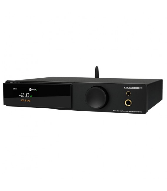

Ok I ordered an SMSL DO300EX
Dual 4499EX and no IMD hump and selectable DSD filters
User Manual actually states the DSD Direct mode has around 3.7V RMS output , which is not the worst
If its measured performance is not broken I keep it. Otherwise will return for refund
I will measure it. Lets see.
A comparison with your highly praised SMSL D-6 would be really interesting, as the DO300EX has all the relevant features for me (apart from DSD1024 ;). And it might even be a bargain during black week.
Ha well the high praise for D-6 is specific to performance for price.
DO300EX is significantly more expensive than D-6
But lets see

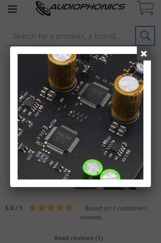

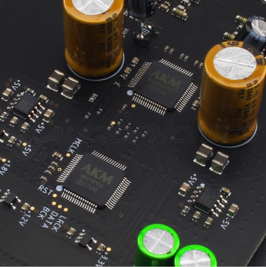

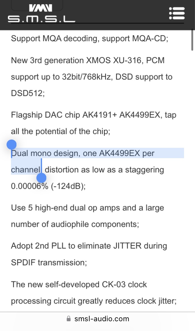

Can you confirm that the DO300EX uses 2x AK4499EX chips per channel? Maybe a picture from the inside?
Information about this is somehow not clear. Especially as the specs are almost identical to the D400EX which is twice as expensive and looks like copy&paste in the manual to me.
It doesn’t look like that here:
Looks like dual and the SMSL site I linked above says dual
If you take a closer look, the front chip is the AK4191 and the rear one is the AK4499EX.
