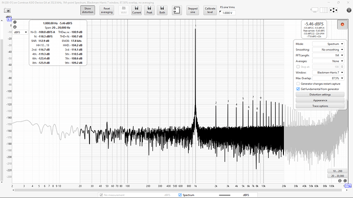

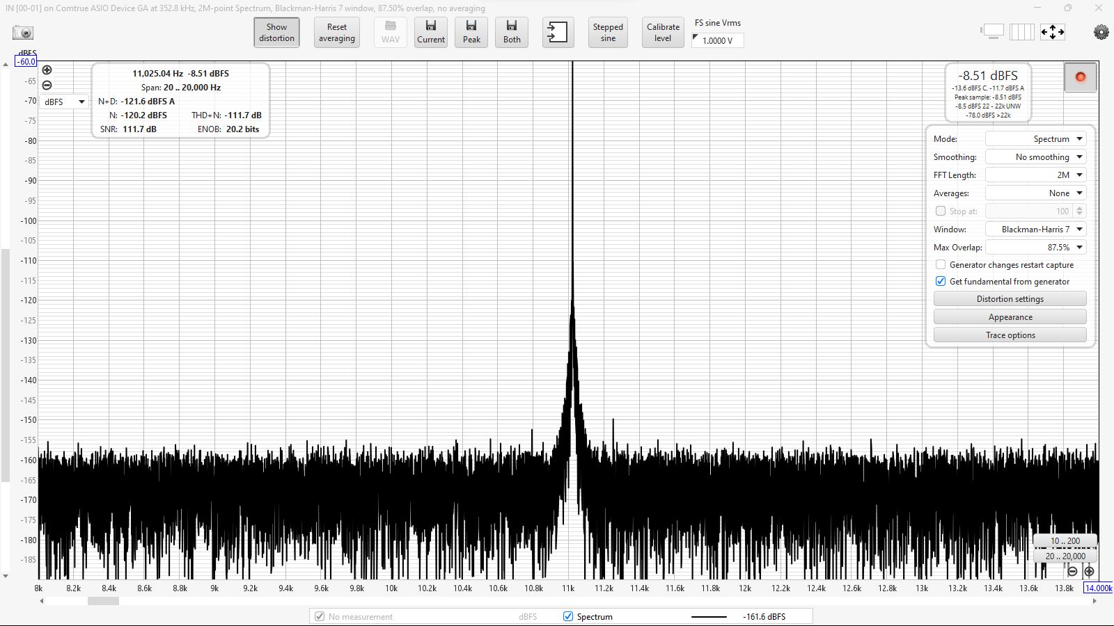

SMSL DO300EX - I am returning it
This is DSD256 with DSDD mode enabled of course - selecting 11MHz option on the DAC
It is not “broken” but…
