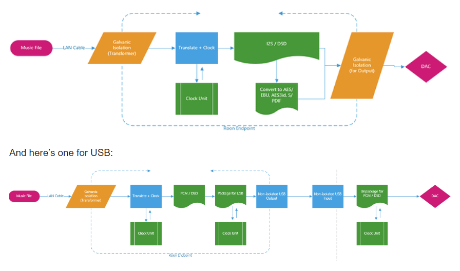

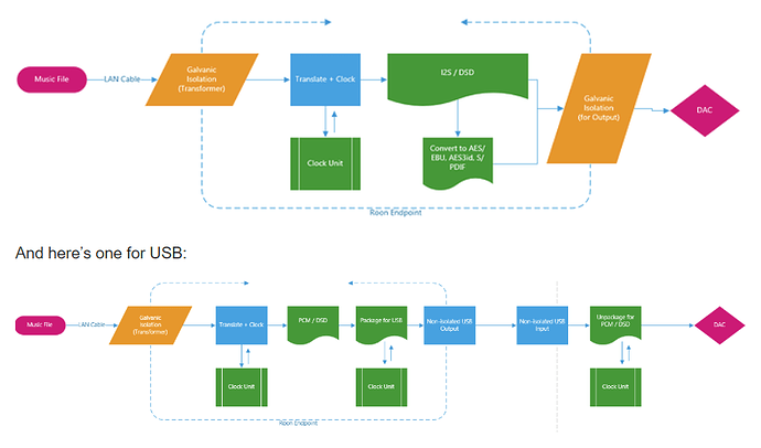

So in my case, I have a NUC on the network acting as a Roon Server and far away from my Hi Fi rack. The Hi Fi system is fed via an ultraRendu streamer (ethernet in, USB out) which is acting as a Roon endpoint. The ultraRendu is then connecting to my DAC via USB (the ultraRendu does not have optical out).
Which of the diagrams you shared above would be reflecting my architecture then?

Sounds like you have the original poster’s Diagram B.
NUC -> LAN > Endpoint -> USB > DAC
Just not sure which of these is the signal path for me, the upper one or the lower one.

I just took the courage to write , because of the 1st post up here , showing a diagram with a roon core connected to an endpoint via lan cable … and i believe , many people thinking that this a scenario , because i have seen it also in other places ! As i understand this is impossible ,right ?
Yes - a direct connection between a Roon Server and an endpoint using just an ethernet cable won’t work; that diagram at the top of this thread shouldn’t be taken literally. What it means in practice is that both the Roon Server and the endpoint should be connected via the local network.
And while the Roon Server connection should always be wired, endpoint connections can be wired or wireless (provided the WiFi network is good)
