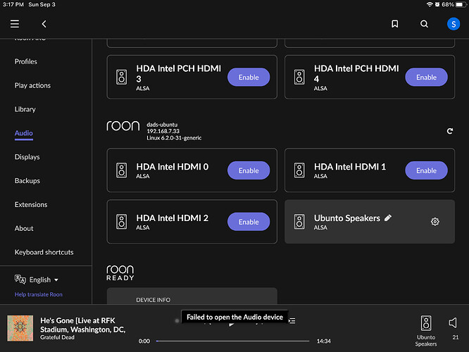

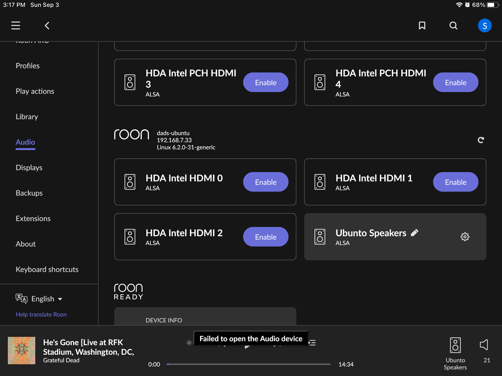

I’m having the strangest problem with RoonBridge in Ubuntu 22.04.3.
RoonBridge appears to be installed successfully. As does ALSA. Below is a screenshot from my iPad, set to the RoonBridge zone, showing the Settings/Audio screen, where RoonBridge is clearly recognized and enabled for the speakers of the PC that it is running on.
In this picture I had just hit the play button, and you can see the ā€œFailed to open the Audio deviceā€ error message. What gives? Advice anyone?

To provide a little detail, @Nickpi - in this thread - identified the fact that when I log off, RoonBridge should work, if controlled by a remote Roon app. And indeed it does work just fine when I log off Ubuntu… It’s when I log back on that the ALSA wheels fall off.
Funny that it worked just fine a couple of weeks ago. Something has clearly changed.
The problem is that pulseaudio allocates alsa as soon as you log into the desktop. You have to disable or remove pulseaudio to use your desktop and roonbridge concurrently.
Vice versa, you can play (using remote or roon-tui from the console) and then log in, roon continues playing, but you don’t have audio in other applications.
The most elegant solution (that I found) still is squeezelite, No change in your audio, just one additional package. Drawback is that it is restricted to 48 kHz by pulseaudio, if that matters.
