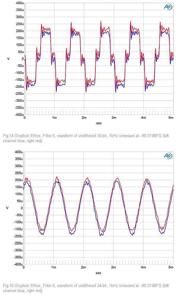

I don’t know! That is what I’m trying to understand. In John Atkinson’s measurements of CD gear he some times show graphs of a sine wave at 16 and 24 bit down at -90dB. Now this is without dither and extremely low in level, but clearly shows a difference which corresponds to my understanding of digital resolution:
Would dither help the 16bit reproduction here?
Those plots would be much more understandable as power spectra (i.e., plotted in the frequency domain, rather than the time domain).
You’d see a sharp peak at 1kHz, surrounded by broadband noise. In the first plot the level of the noise would be much higher than in the second.
Noise-shaping dither would change the frequency-spectrum of the noise: lowering it through most of the audio band, while raising it at high frequencies.
Thanks! Yes, that would show where the noise is. If I understand this right the resolution remains the same so John Atkinson’s curves would be just about the same with dither or noise-shaping dither applied.

No. he does something better than that: he shows what happens when you decrease the sample ratebit depth. (With dither) the sine wave stays a sine wave; it’s just that the level of the noise goes up. Even at 2 bits/sample, you can still hear the pure sine tone (though it’s almost drowned out by the noise).
