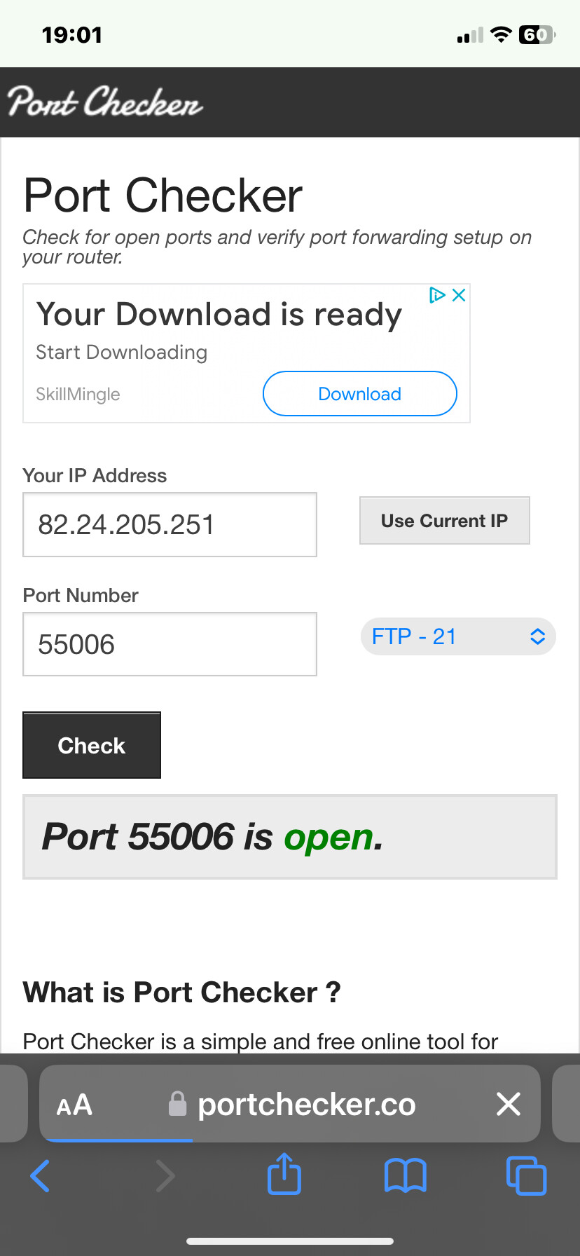

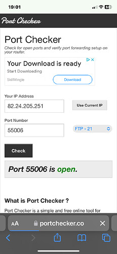

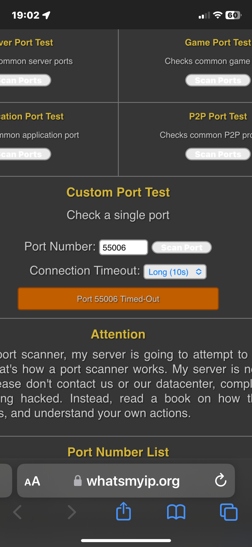

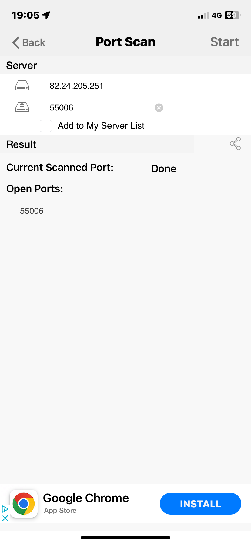

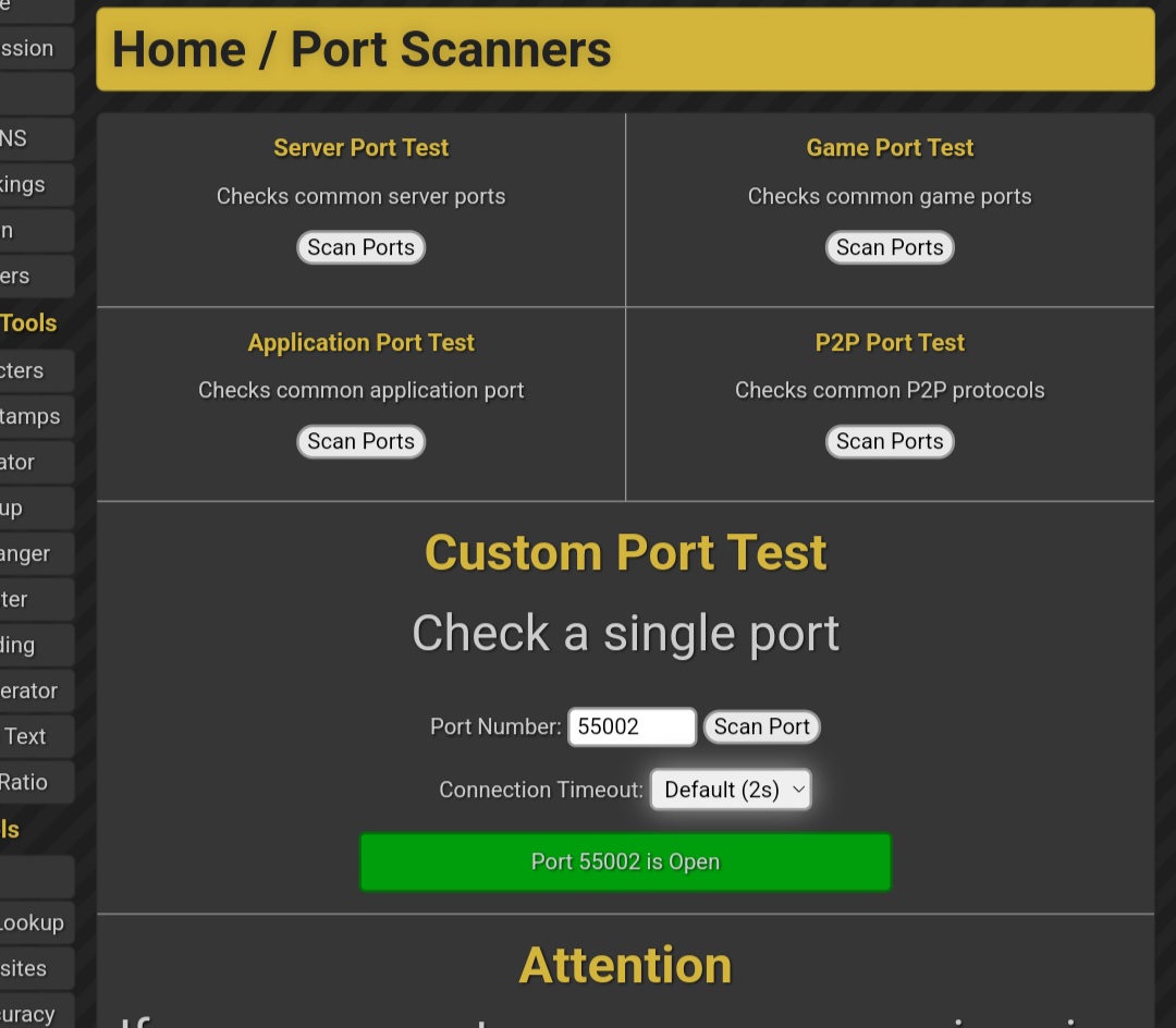

2 port scans shows the port as open, with a third timing out - not sure what this means?
I’ve reset my router, disconnected my rock from the power and deleted arc. Then I disabled upnp, enabled tcp & udp, set up a manual forwarding rule, switched the rock back on, entered the relevant port no in the ARC setting in the Roon app, downloaded ARC and logged in and connected to the rock while on my home network. I then tried to connect using 4g and still the same issue - it can’t connect.

I found the information that PortScan is a security tool, with the aim to find open ports and eliminate security risks.
Not a tool that proves accessibility from the outside.
Port Checker is also intended to detect open ports in order to test if port forwarding settings on a router are working.
In contrast, the application whatsmyip serves the purpose of proving accessibility from outside. Which is obviously not the case here.
