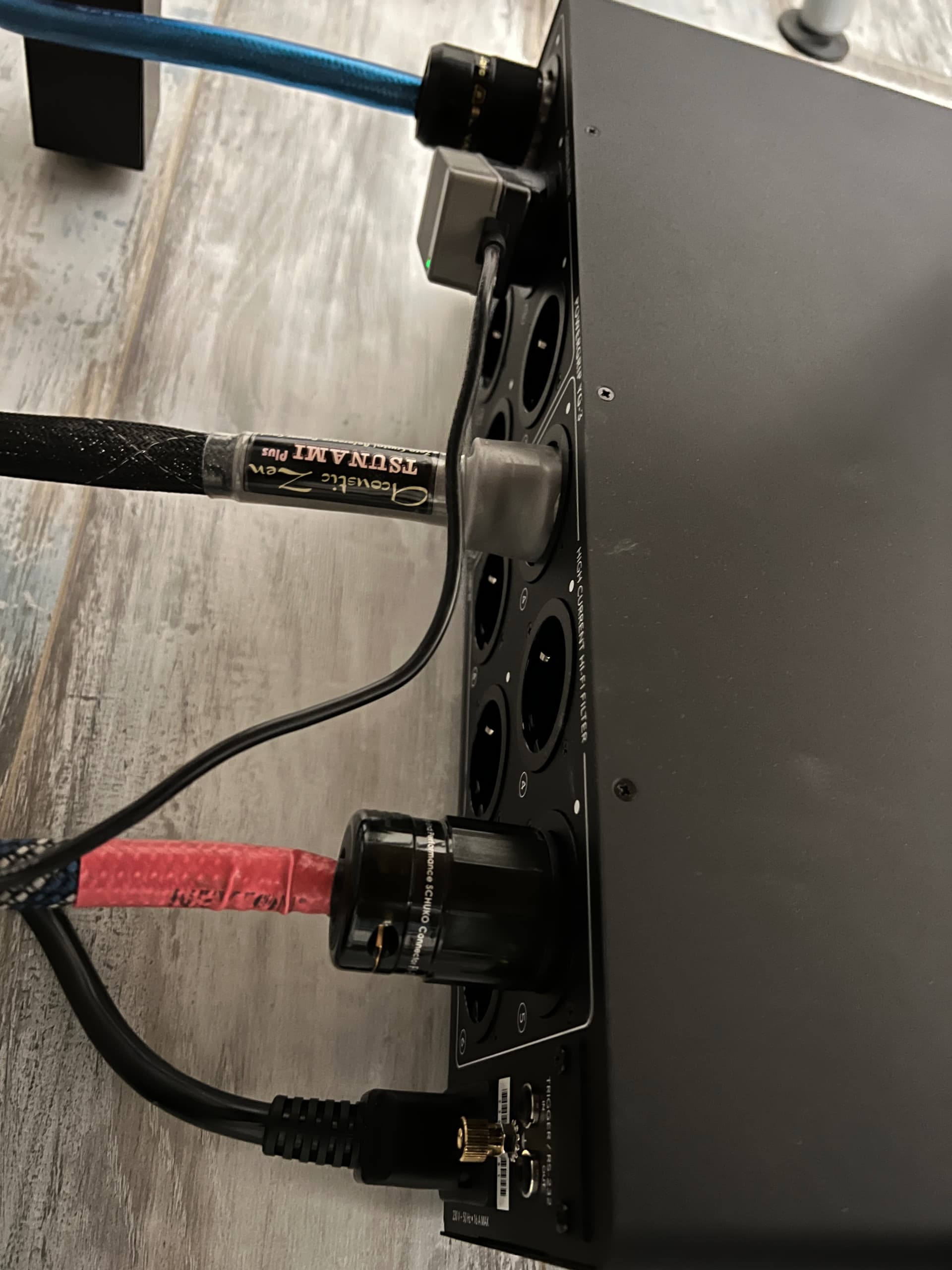

my DC Blocker 6 arrived today. Nice looking and well built bit of kit. Hegel is now considerably quieter and noise can only be heard within a few inches of the device itself, which is purely mechanical noise. The on and off buzzing which varies throughout the day seems to have stopped!
I’m now without the DC Blocker and at a volume level of 21 at 3.5 meters away I can hear the transformer buzz over the music (depending on the track). Pretty polluted power over here😄 So for that alone I want/need a DC Blocker… Can’t wait for the new one to arrive. I wish I would need more than 1 device so that the DC Block 6 would have made sense for me but it just doesn’t.

When the trans H390 was turned on for the first time, it buzzed, but after 2 seconds it became quiet. The DC filter turned on automatically. It works ![]()
