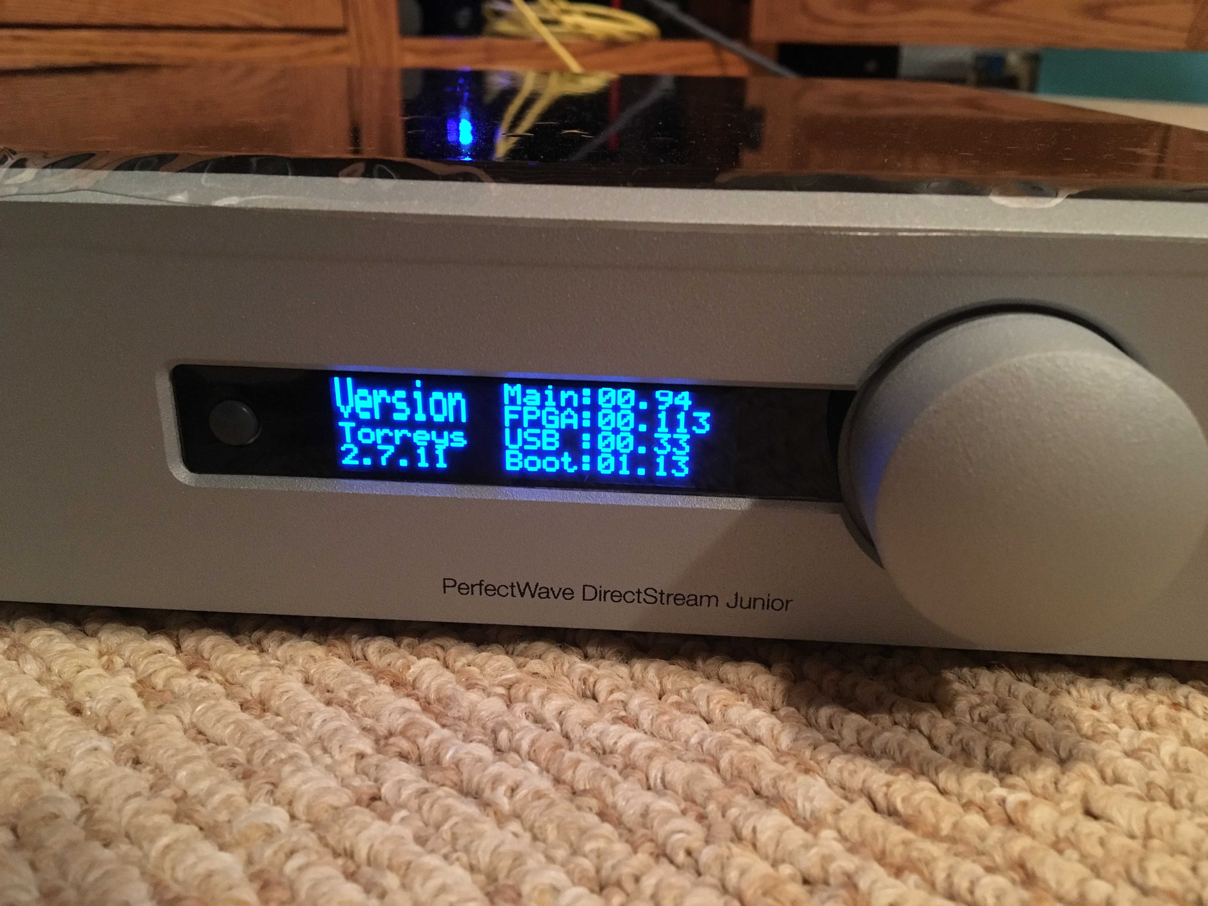

Device is not being recognized as certified...how to fix this
