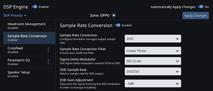

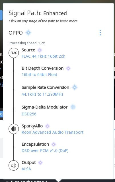

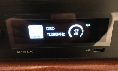

It is amazing Sonica can do DSD256 in DoP, this requires PCM transport stream of 705.6/768kHz which many of the DACs are out of reach. Does doing a DoP at such high sample rate take up a lot of resources when done in the software level, i e, encapsulation?
What CPU are you using to upsample to DSD256?

I also run RoonCore on my ReadyNAS_516, but it taps out at DSD128. I have ordered an upgrade (CPU and RAM) and hopefully will allow the same up-sample/convert my workstation does at DSD256. I prefer to run all servers on my NAS.
I am really enjoying the OPPO, I have a Bryston BDA-3 and I think the OPPO will take it’s place in my main listening room.
Wow, it needs to run almost to max 4GHz+ at 19% CPU resources! This is really power hungry when convert to PCM to DSD256. I saw low processing index 1.2, anything lower than that, it is going shutter the playback. I can’t imagine if you need to convert to DSD512.
Thanks, it is good to know that an i7-3770K will work, though evidently just barely.
Yeah, it seems like it would require Roon supporting the use of multiple cores on a single stream to make DSD512 feasible. Otherwise it looks like I’d have to stick with HQPlayer.
My i5-6500 can do the same at around 1.1x to Oppo Sonica @ 256. As 512 is not able to be tested yet I can’t say it will work but based on what I have heard then unlikely unless more cores are activated. A 6700K might cope with current limitations on cores
