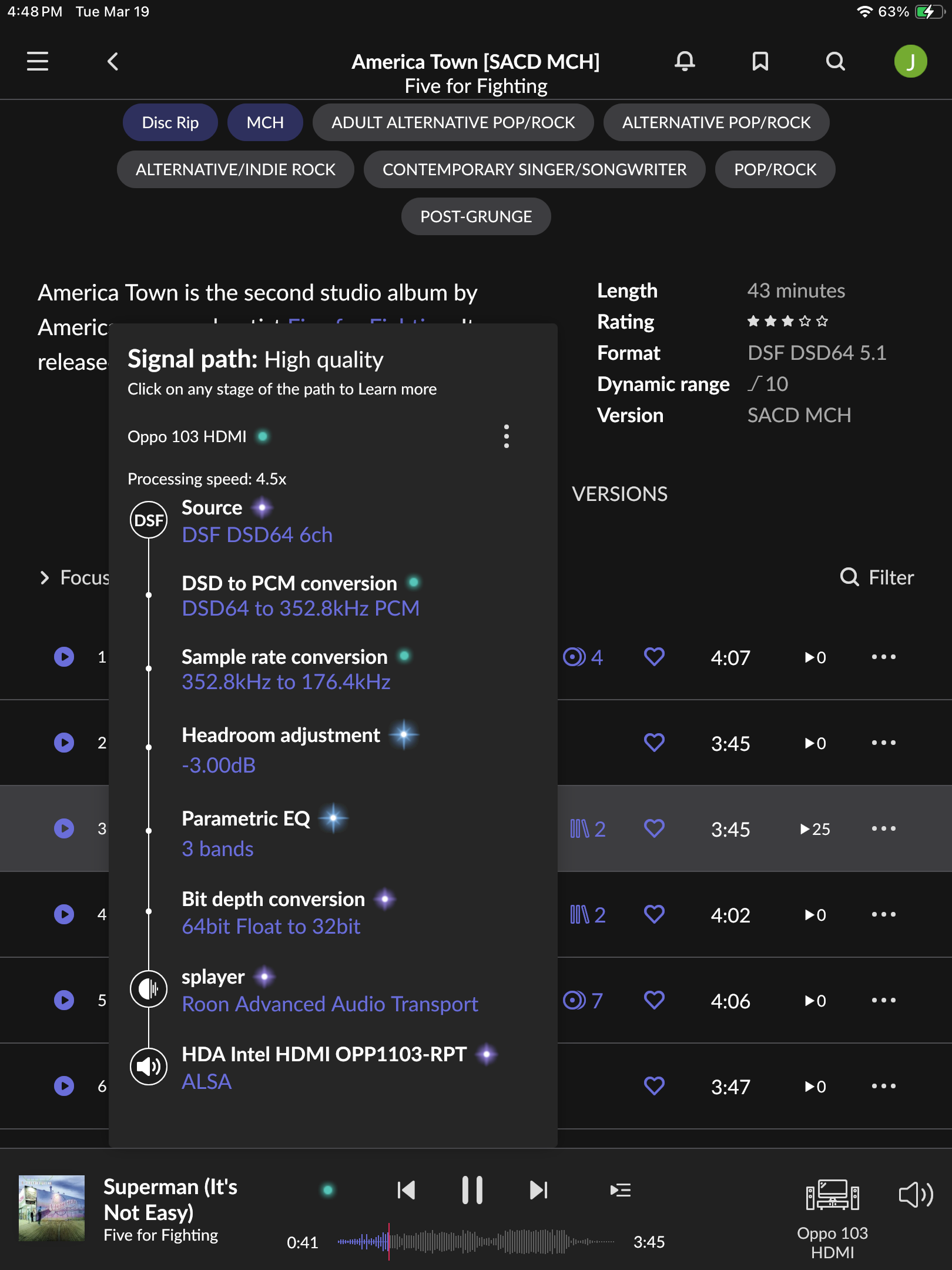

While I don’t do any DSD upscaling which I understand requires a bit of resources, I do play 2 channel and multichannel SACD files and may apply some DSP to them (Conversion to PCM, EQ, Headroom Management, Speaker Setup adjustments).
For example:
Hopefully, answers to these questions will be available if/when the time comes to replace my Salkstream.
