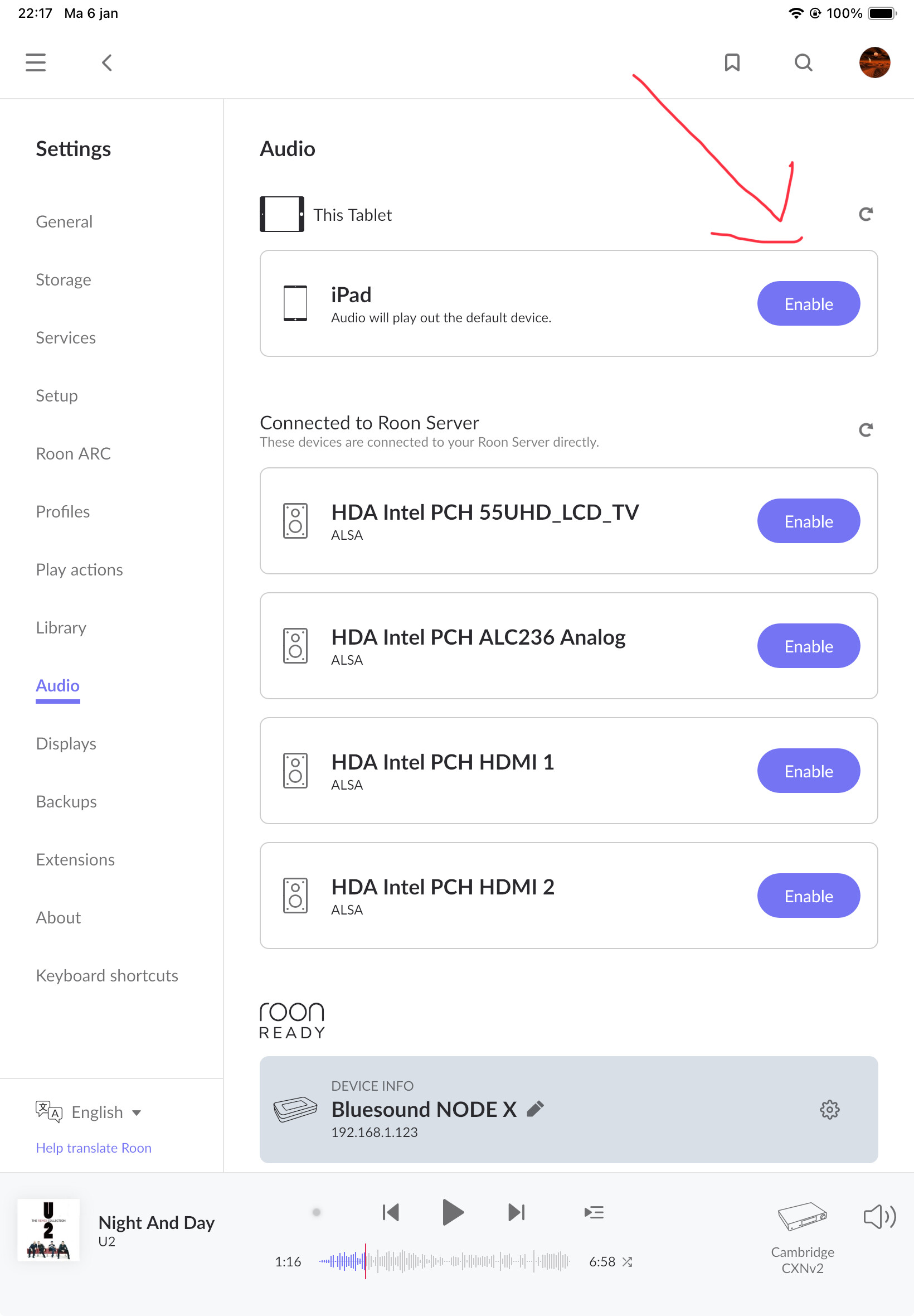

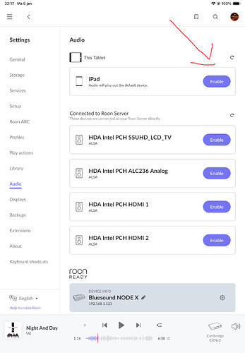

The scenario I was envisioning was my son listening via his iPad on headphones. Does that not require ARC when using the same app if on the LAN?
If he is on the same LAN then he won’t be needing ARC.
He can just install the normal Roon app and activate the iPad as an endpoint in Roon’s audio settings.
