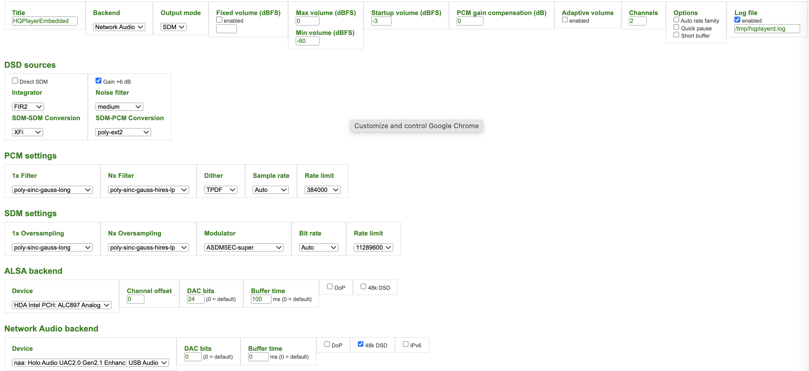

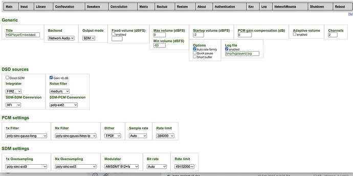

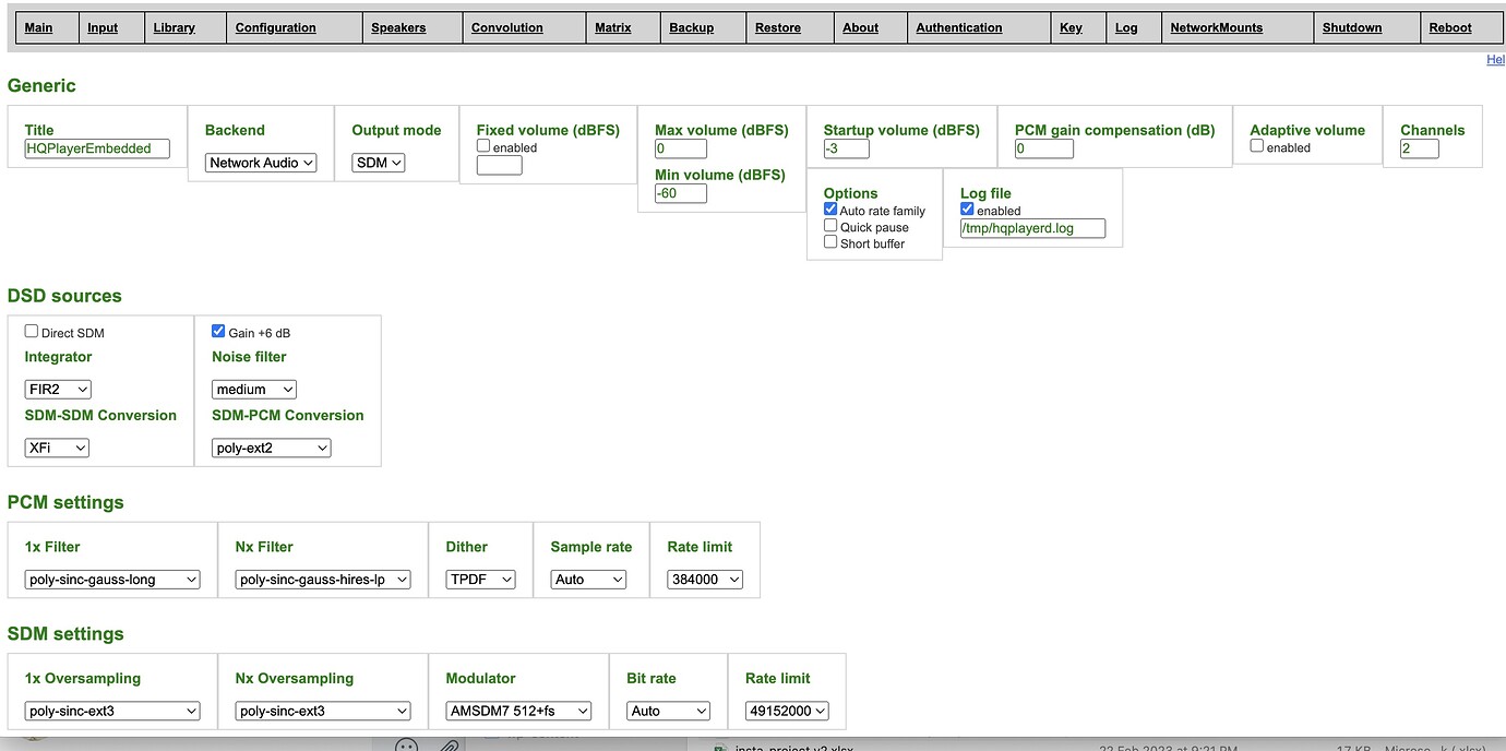

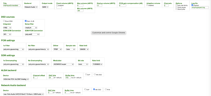

I use auto rate for my Holo DACs. My May settings (HQPlayer 5):
My settings (“Auto Rate Family” enabled on top and “48k DSD” support at bottom ) enabled.
@Michael_Huntington
Holo Spring 3.

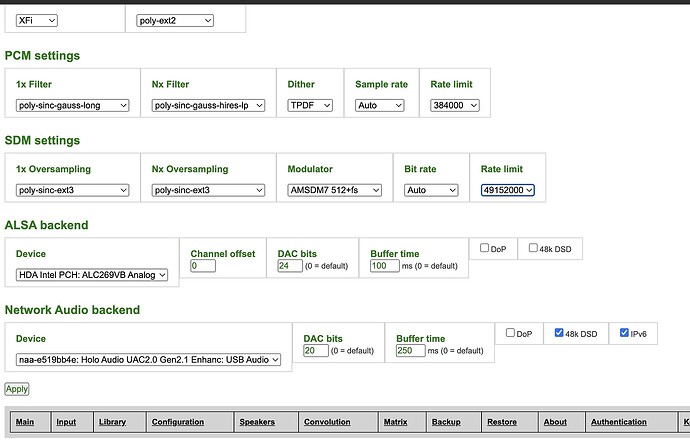

Dac bits should be 20 also:

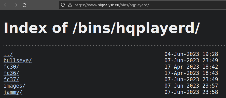

Are you trying to install correct package? IOW, jammy package? Sounds like you are trying to install bullseye package.
@jussi_laako
Please I’ve installed jammy package , but unable to login on the web console.
How do I reset the username and password?
Ubuntu 22 is Jammy Jellyfish, not Bullseye
